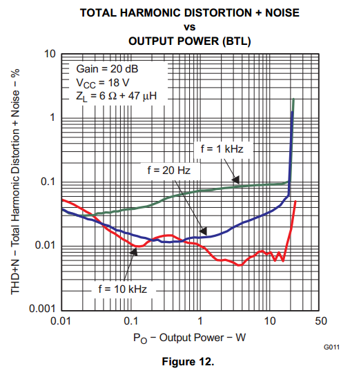

Here is the 3110 plot of THD for 18 volts drive into 8 ohms. Usually lower impedance speakers equals lower distortion. Even with 18 volts supply and 8 ohms speakers, the THD is low when operating below 20 watts. The Sure TPA3110D2 board really should be called a 20 watt class amp rather than 8 watts (probably assuming a 12 volt supply).
