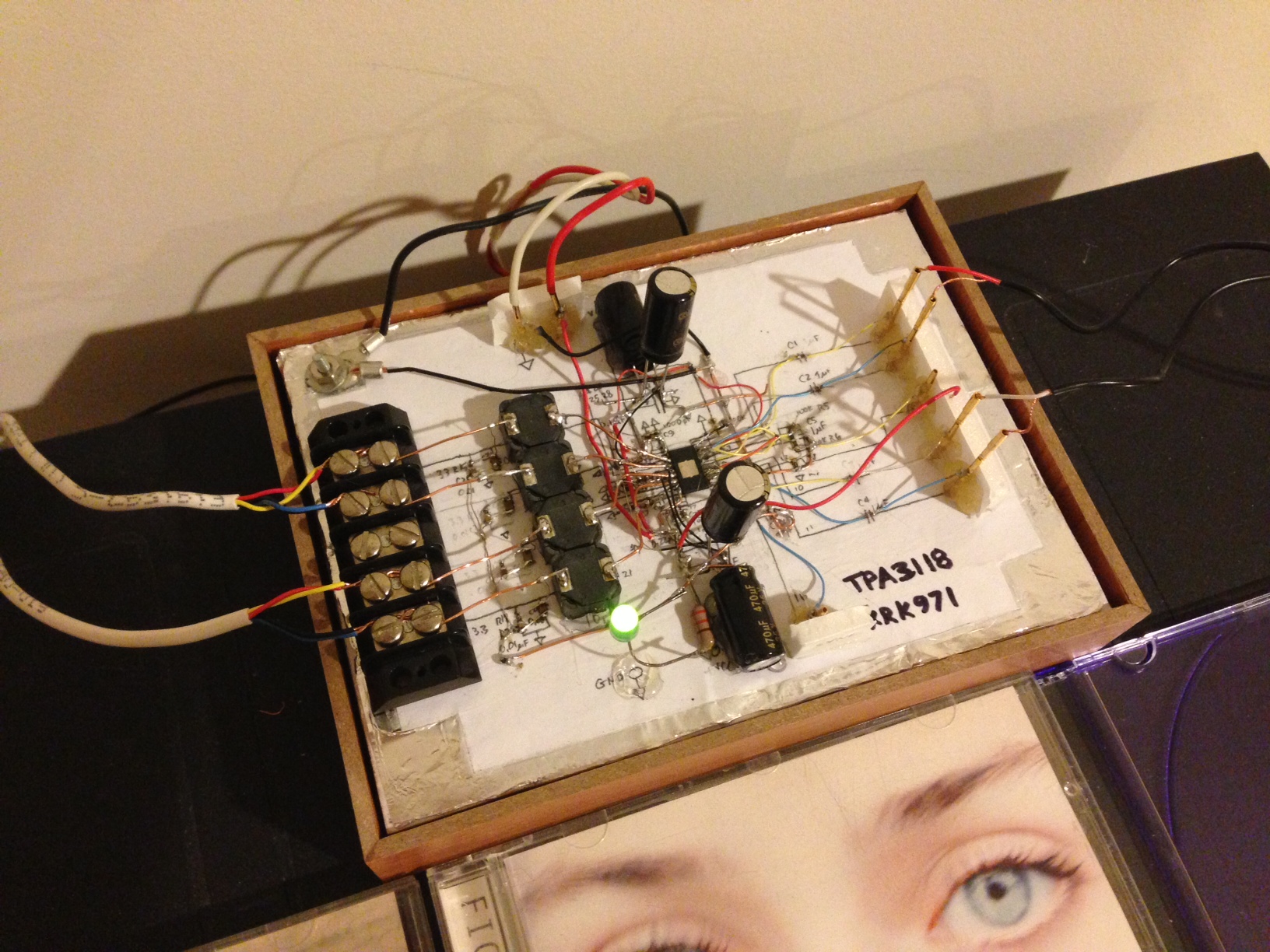

I added a second 470 uF capacitor on the power rails for total of 4 x 470 uF to see if it would improve the sound. On one song where I listened to the bass before then after, there was a noticeable difference in what I thought was just adequate before, now it is much improved. It's the bass on the kick drum that improved - it is now authoritative and controlled. Bass notes from double bass however, still sound the same as I don't think they were lacking before. Anyhow, that was a simple upgrade and well worth it. Here is photo of foam core amp with additional caps. These are Panasonics.

From my experience with Tripath TA2024 amp. 470uf good quality low ESR caps(I use panasonicFM) close near chip is enough.
Then one additional 6800-10 000uf somewhere near, lets say on boards power input terminals. It improve bass performance a lot, compared to just plain 470uf.

Thanks! 🙂 I am not sure too many people would say that considering how ugly the dead bug style is. There is something special about it for me though - it is very organic looking and all the wires are just where they need to be and as long as they need to be without making lots of neat looking rectilinear patterns. Plus when you hand make something it will always look good to you - as is the case that no one thinks their own baby is ugly 😉. Appreciate the feedback though.
It looks like some big caps in the 6800 uF range will be on my next order to Digikey... I can't say that I would complain about the bass now but then I guess you don't know what you are missing until you hear it. I think they test will be to parallel the full range driver with a bandpass labyrinth ported subwoofer that I have from wife's my old JVC component stereo. If it can still drive that and the full range with oomph that will be an achievement.

Ok, actually I was thinking about PCB, I am not so brave as you 🙂 (however I use p2p on tubes and chipamps)
For best performance, I believe, 470uf caps and small bypass caps must be as close as possible to chip power legs, with as short wires as possible.
For PCB amp you can't do anything yet. If I make PCB design, I think I could save 1 cm or so between caps and chip.
Wit your p2p amp you can try to move caps bit closer, wire from chip to cap as short as possible, without free loops, maybe solder to cap's leg closer to cap's body. Every millimeter count.

I have two different bypass caps (1000 pF 50 V and 0.1 uF 50 V) on the power leads to the chip and they are only 5 mm away with the 470 uF about 20 to 30 mm away. I have absolutely no noise on the system that you can hear (have to put ear within 2 inches of drivers to hear soft hiss when no music is playing). I think the bypass and aluminum foil groundplane are doing their job. Interestingly, the nicely made PCB version with a nice groundplane isn't any quieter than the foam and foil p2p construction.
That's a good tip to try putting a switch on the leg of the additional cap to do an A/B test of sound with and without the capacitor. I'll try that...

I do not see any bulk ecap in your ckt, in my TPA3100D2 design, I am using a Nichicon (4700uF/35V), (could be bigger, I used a 18mm Diam can!!) for a bulk ecap and local to each channel, 2 of Silmic2, (220uF/35V).

There are limits to your bug implementation, because you can not put the comps as close as one can do on a PCB and have lots of copper between them for a low impedance connections..
None the less good job, now you understand the limits of this method.
The next class "D" amp that I make will be similar as shown in figure 27 of the TPA3116/18/30 DS.

Not sure why you don't see bulk caps in my circuit. The photo (post #182) clearly shows four Panasonic 470 uF caps on the ends of IC. Two are lying flat on board and two are standing up straight. Even with dead bug, I managed to get the small SMD bypass caps quite close. The wire is rather small 22 gage used for the power connections to the leads on the IC but I put the bypass caps within mm of the IC lead. Here a closeup photo showing how the two bypass caps are directly soldered onto the 22 gage main power lead from the IC pin and is located about 5 mm away.

Yes, myself and others are saying that this is not enough capacity, I am using a total of (4700u+(2x220u))=5140uF, which seems to fine from what I can tell, so far and I am not running a subw.Not sure why you don't see bulk caps in my circuit. The photo (post #182) clearly shows four Panasonic 470 uF caps on the ends of IC

So you are saying circa 5000 uF will make an audible difference? Wow, that is a huge increase over factory recommended 220 uF.
Is there a way to calculate what the capacitance should be to prevent power supply rail sag?

Know, I did not specifically say what size ecap will make an audible diff, but logic says that the larger the better, up to a point that is, I think this is the largest one would need to go, so that is why I chose this value.So you are saying circa 5000 uF will make an audible difference? Wow, that is a huge increase over factory recommended 220 uF.
The TI demo board probably used a lab supply, so that is no judge of the final application supply.
Since I have a external supply, I have to make it this big since it could be hooked up to DC rectifier/transformer with who knows what they have for a bulk decoup ecap.
If I was to use a regular transformer, this would be the size I chose.
Calculating the ripple, is available on the web & in this vary forum, but it is rather empirical.
Note, this chip has a 70dB PSRR, so that is something to note.
