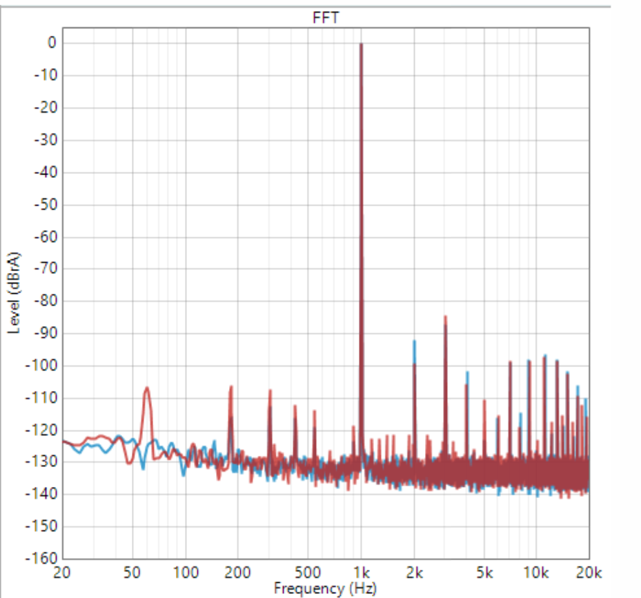

What I meant by referring to the spectrum is that in harmonic distortion, as measured by FFT, different harmonics are perceived differently by humans. Low order harmonics, principally 2nd or 3rd, are not especially objectionable to most people. In fact many people don't hear them even at fairly high levels. On the other hand, higher order harmonics sound bad, usually the higher they are the worse they sound. Even though most people will never hear the 2nd harmonic of 10kHz, that's not necessarily what they would hear when listening. Stationary nonlinearities produce intermodulation distortion when music is played, since music consists of more than a single sine wave. IMD is generally more objectionable than HD, and tends to be produced at higher levels than the corresponding HD is. The main reason we measure HD is because it is easy to measure, and because it may be taken to imply corresponding IMD will occur with music. The reason THD+N was ever used is because it is the easiest of all to measure, not because it is particularly useful for predicting what an amp will sound like.
The reason for looking at the spectrum of HD at all signal levels is because it may be different at different levels. What an amp sounds like to humans depends on a lot of things, more information than we can easily digest. Even then we can't exactly predict how an amp will sound from measurements. Earl Geddes once tried to improve the situation by suggesting a new distortion metric that comes closer to being relevant to how humans hear. It never caught on though. So much for that effort.
Don't use tube amps myself, use Benchmark AHB2.
The review site uses your amp as their "the benchmark amp".
And about distortion at different frequency I will attach the screen shot.
And there was alot of information on your last post which was new and useful. Thanks

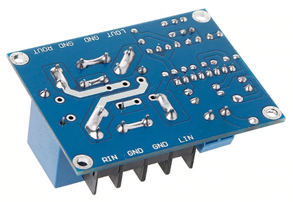

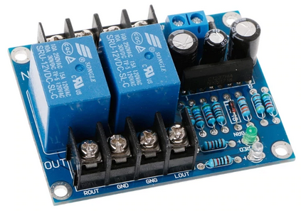

Speaker Protection
Guys can you please advice? I'm putting back together my old amp with two mono TPA3116 D2 boards. I've taken the volume pots off and added a external volume and now fitting a speaker protection board. I've noticed it has grouped gnd. I have seen many reviews/builds saying this can cause issues.
PS I should have paid more and bought one with split gnd.
Be careful, grounded protection board will fry your boards.
On those BTL/PBTL class-d amp neither of the speaker terminal are referenced to ground.
I think tpa3118 is an all embedded protection chip.
Wait for a confirmation though.
Perhaps check for BTL protection board.

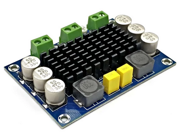

OK I thought as much hence asking.
These are my boards if that helps.
I have the SANWU SW-HF48 and it worked initially (30mins) but then i swapped from the BT to the audio connection a couple of times, got a loud buzzing and then it appears to be shutting down and restarting due to the DC detect circuit (pops every second and DC output on left channel ramps up then falls). I did take off a resisitor from the gain circuit to drop it to 20dB but still no joy. If i short the input to the left channel chip pins the system goes into mono mode. If i short the L input before the coupling caps the restart still happens. Is this likely to be a fault internal to the TPA3118 chip or other component please?
