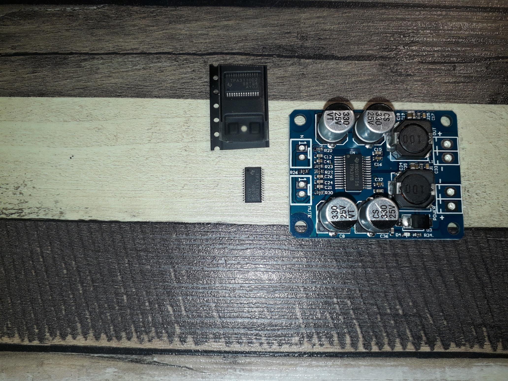

Aaaaand we got and received a fake one.
Or in my case a couple of them unfortunately.
The item description showed the correct version.
But in this case I got a TPA3118 with only 28 pins.
Obviously that is not correct.
Bit annoying since I got a couple of them, have to open a dispute etc.
I wonder what chip it actually is, on the left you can see an 100% legit TPA3110

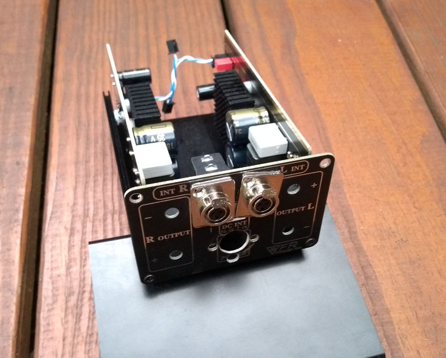

Life is busy, so slow progress with other projects. Here's a photo of where I'm at. Mini-XLR connectors will be fitted to the rear, and a hard-wired DC power cable.
With attention to power supplies I found it to play in another league to TPA3116 (with similar attention to PSU).
Please tell.
Before pulling the unit apart I only tried it with the supplied 15V SMPS. I was thinking to try with 19V and 24V, and then I can add a capacitance multiplier (from ALLO).
Eventually I could try an LLC SMPS, if that's worth the money/effort?

Thank you. I see you have been modding the TPA3220 micro EVM's VDD/GVDD/AVDD rails. I have the dual-mono TPA3221 amp by "FR", and the VDD/GVDD/AVDD components of that setup are difficult to get to - they are underneath the overhang of a large heatsink. Also the 2 separate amp boards are firmly held together by a glass-fibre panel at right-angles to each board, soldered in place. I will restrict my mods to bypassing the opamps, and going full differential input.
I should add, though, that this amp's 5V regulator is ONsemi MC78M05A. I don't know if that's good, average, or bad.
