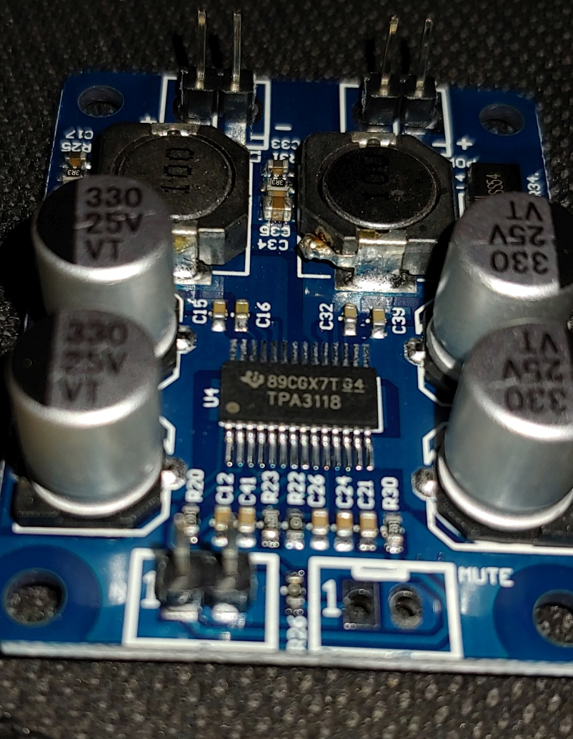

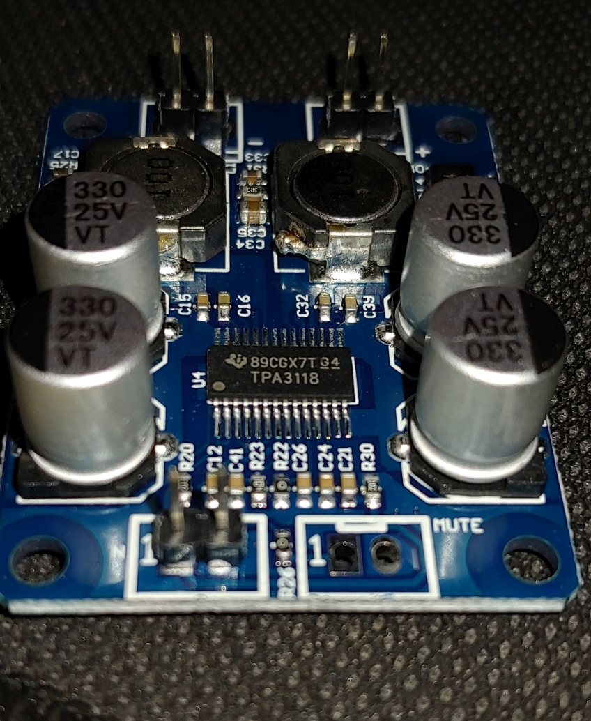

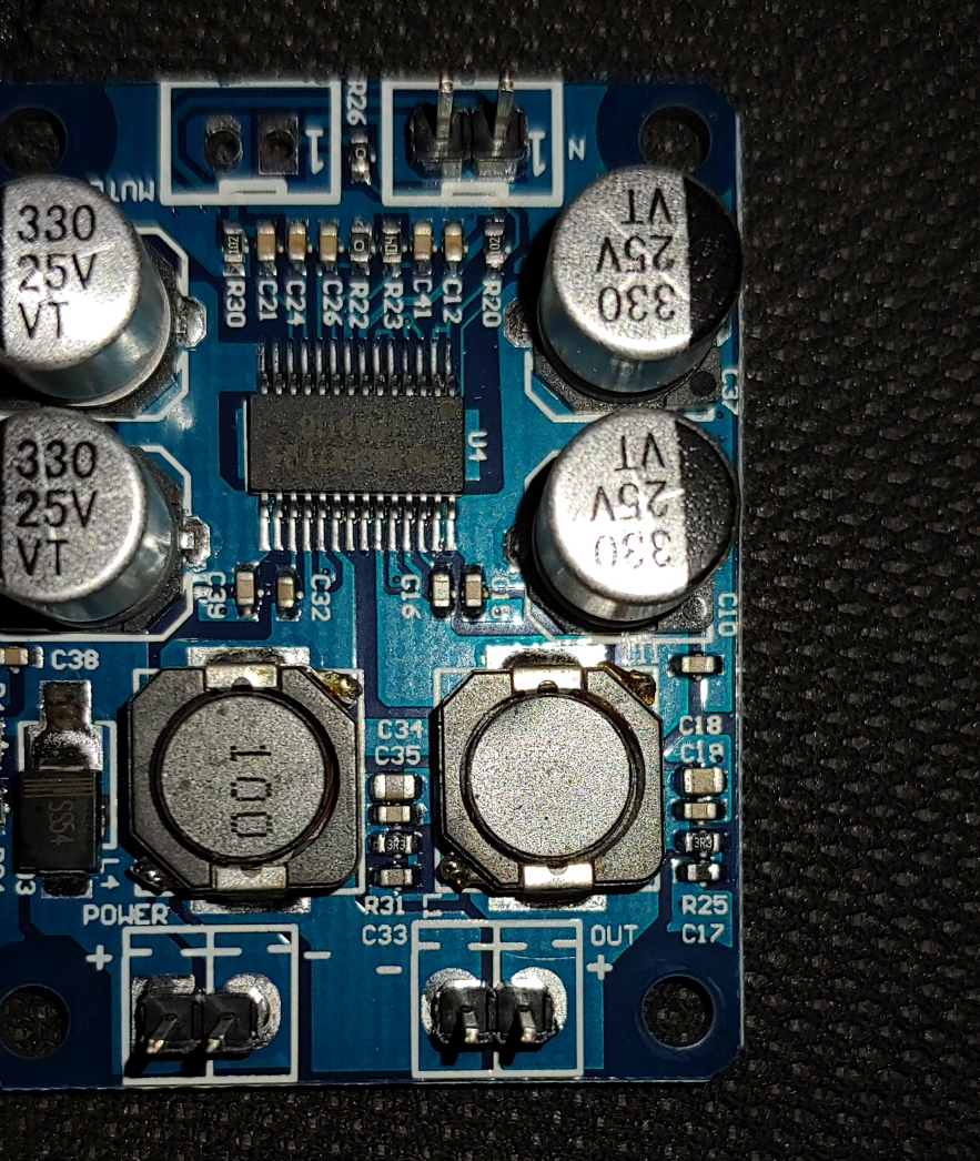

Any idea what these chips actually are? It's a 28-pin SSOP package, and can handle a 21V rail just fine. They sound terrible but I guess that's expected for a fake, remarked chip. These are sold on Amazon (India) for just under $5 each. Interestingly the listing shows the correct PCBs, but this what you get in the package.
I want to reduce gain and/or try PFFB to improve things, as someone who's using a remarked $2 chip will be using inductors below the bottom of the barrell. I soldered the headers and thus can't legitimately ask for a return, but I wasn't expecting fakes so I didn't pay much attention.

Those are TPA3110 chips (or some Asian equivalent).
I had the same issues. Check couple of page back in this topic.
There is a little error in the board, just connect pin 5 and 6 to ground and your board will be nice and quiet! 🙂
(ground should be on pin 3 and 4 if I am not mistaken, but pls double check)

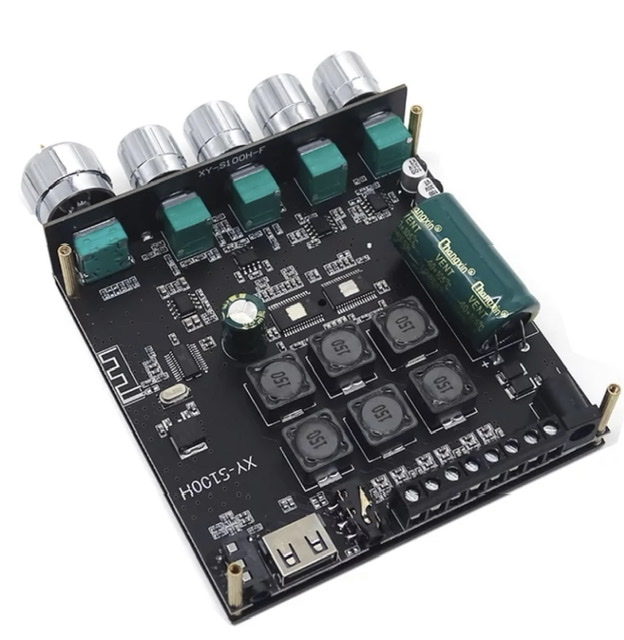

I have a Sinilink SY-X100H:

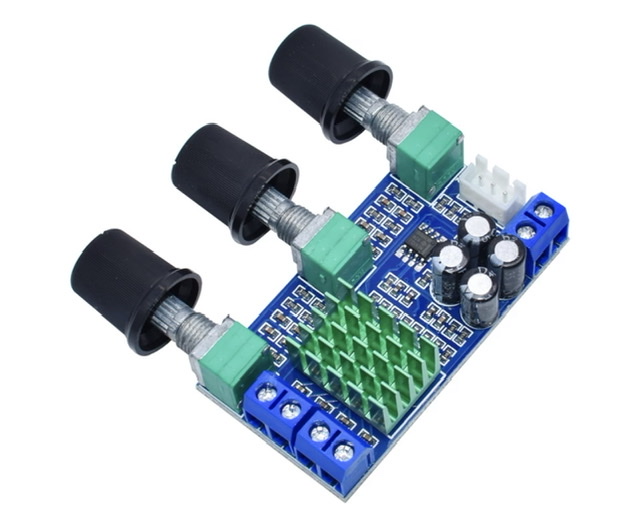

And XH-M567 (actual TPA chip, not the knock off thinner chip):

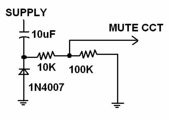

Which have the expected pop noise on power on/off.
What is the current widely accepted fix for this? I’ve looked through a lot of different suggestions and this one by @DUG:
Seems to be the only one that says it cures the pop when powering off. Is this the go to?

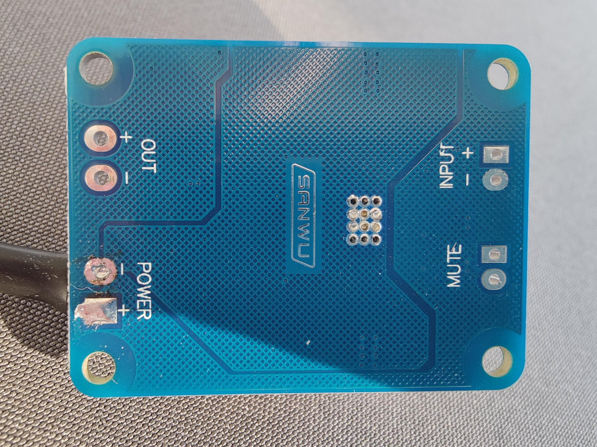

Hi! Today, for the first time, I tried my tpa3118 SANWU boards that I bought some years ago from ebay for perhaps $3 each. They seems both to be completely dead. Upon power up they pulls down the input voltage from 12V -> 2-3V. I measured the power input in it was not shorted, so perhaps there are some short/problem after the diode.
There is no sound at all from the output. No power on thump, hiss or anything. I also tried a 24V led driver that goes into protection directly on power on.
Anyone had this issue?
