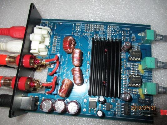

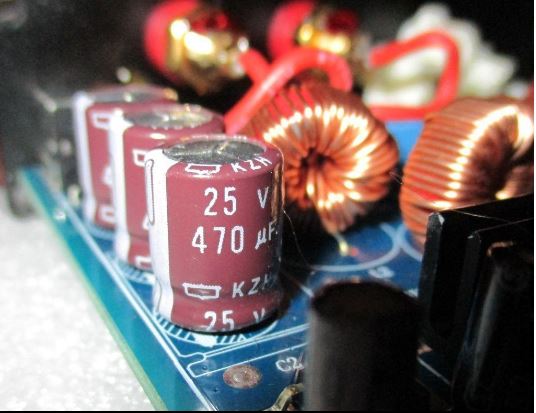

On thing I do when bringing in mini-amps for friends is to upgrade the internal bulk capacitors. A lot of these boards are using 25 volt caps which are danger-close to their limits with a 24 volt supply. So I generally up the value to 2200uf and 35 volts. Curiously, the provision for this is often right on the board, as you can see in the photos. Yes, you can hear the difference.
I send them out with 24 volt, 5 amp smps bricks.
