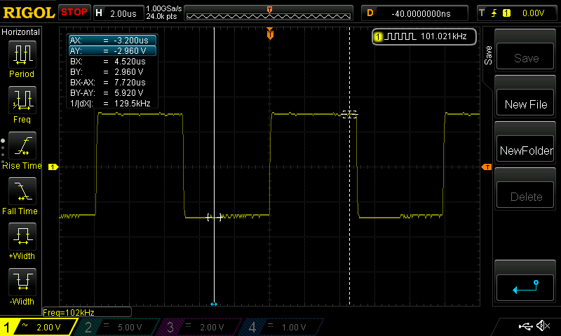

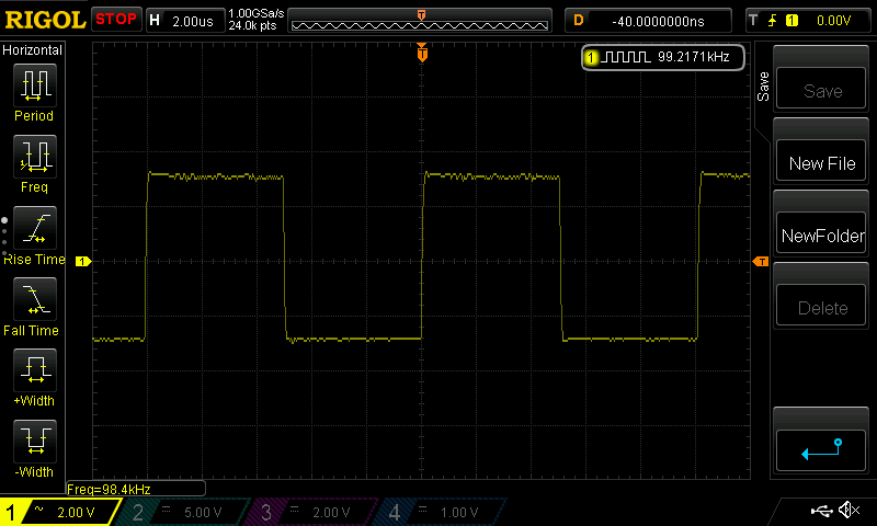

To show the facts more clear:
Noise sources are:
3x TPA3118 Clock
1x ADAU1701 Clock
1x CSR64215 I2S Clock, BT RX/TX Burst
1x 150W DCDC Boost Clock
1x Buck Burst
1x Isolated DCDC load-variant clock modulation
All there "fight" against each other.
The speaker/amp configuration:

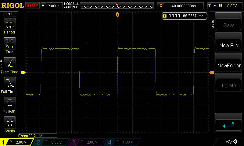

Separate clocks at the TPA3118 without sync:
1:
2:
3:

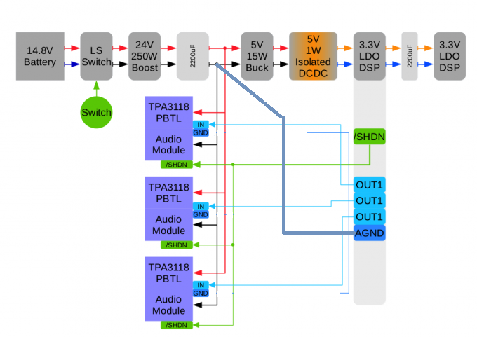

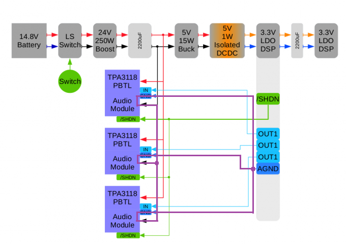

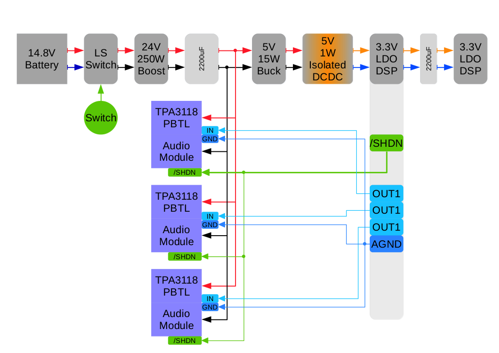

Power/Signal/GND-Connections are:
If you look closely, there are two low current loops via Signal-GND which may act as possible antennas:
Attaching GND at the high-current-gnd-point do not help here and may degrade the signal due to gnd-bounce and modulation, especially regarding "beat-noise". From practical testing it increases the background-noise-level.
So syncing all 3118 which just a single wire star-connected to the master fixed it. Gain-resistors needs to be adjusted, of course.

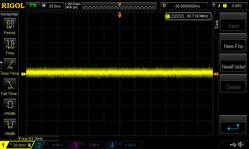

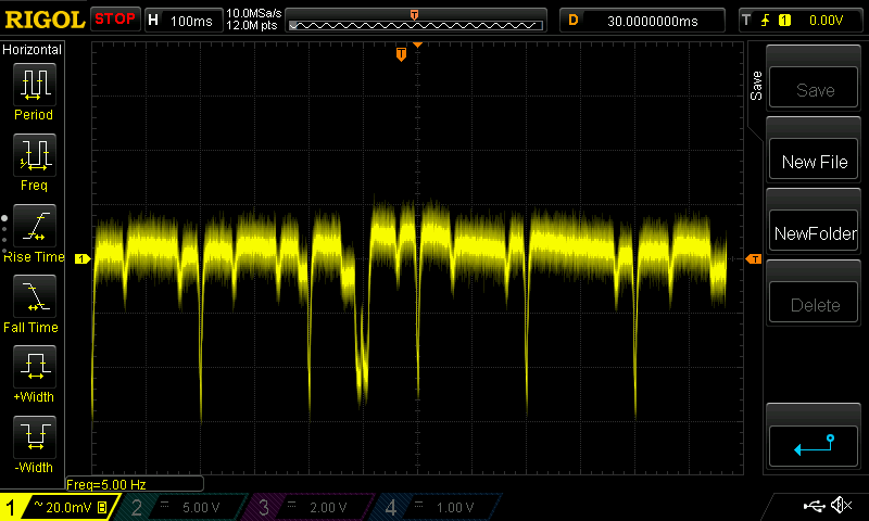

One thing is interesting to note, the CSR64215 is need from the ADAU1701 DSP 3.3V LDO. The voltage/noise level at this LDOs output is shown here:
This plot is valid if no BT-module is connected and looks pretty clean for the fact it is feed by:
16V battery -> 24V Boost -> 5V Buck -> 5V Isolated DCDC..
When the BT-Module is connected together with a 2200uF LowESR Hybrid-Polymer at an ESR of about 12mOhms, the following bursts are still seen at the LDOs input:
So there isn't any advantage from using additional MLCC here, as the bursts push even through the LDO to the input side. The 2200uF is hiding these bursts anyway and you wont here them. Without, they are barely hearable with the ears right next to the tweeters.

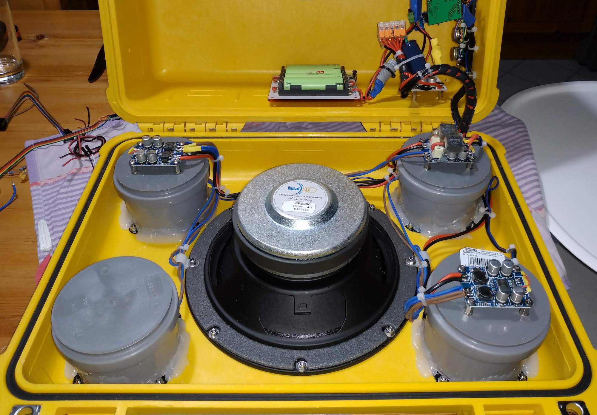

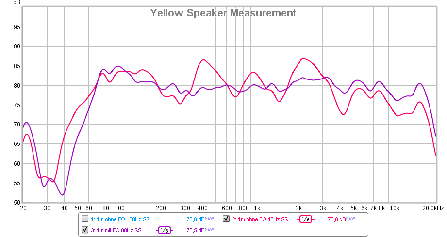

In the end, the speaker gets measured and equalized to this (dark purple):
At this stage, the woofer where still tuned for lower fs by an additional mass of 10g.
The enclosures backside is used as a passive radiator, which is tuned by a center-weight of exactly 200g. This way any BR holes/resonators are avoided. 🙂 Tuning frequency is slightly below woofers resonance frequency. (75-80Hz)

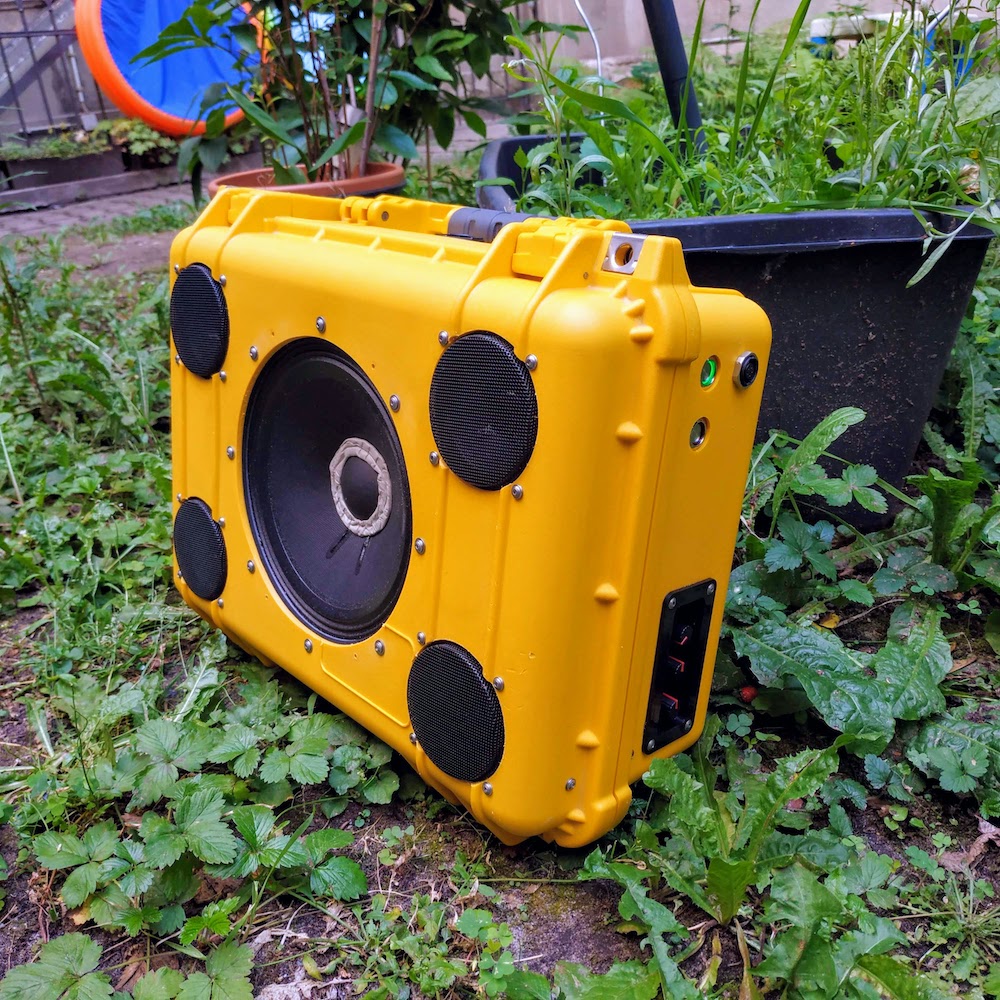

Thank you for sharing this nice project. A real "MARLEY" sound speaker system 🙂
Using the vibrating back side as as tuned radiator instead of silencing it is a clever idea. On first sight I would expect the sound to be questionable, but I trust your expertise, as stuff you do is always of high quality.

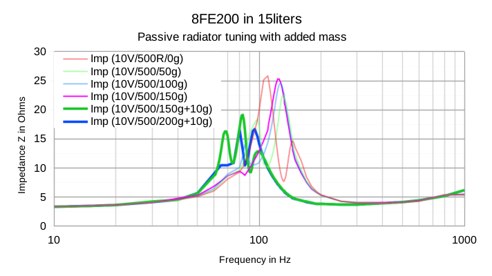

Thanks mate,
their where excessive (non automated) measurements done for the tuning:
The measurements are done at 10Vrms output with a MAX9709. The Sub is then connected with 500R in series and the impedance is traced for different tuning masses at the backplate. The "+10g" indicated additional mass on the chassis-conus.
Undistorted peak-output (1khz) is actually 116dB(A) at 1m distance, or 96dB at 10m.
