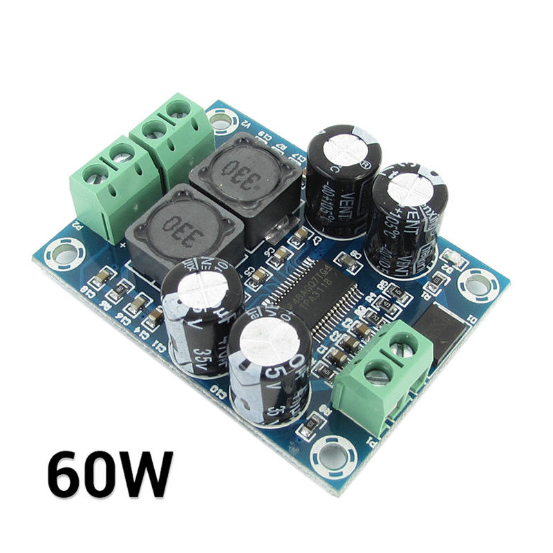

I have the blue board monos and am very impressed with the sound quality. I went ahead and got a pair of the "other" monos for the heck of it. The inductors look beefier and I like the fact that it has the terminals. Seems to have much less components in the circuit. We'll see how it turns out.

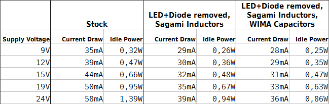

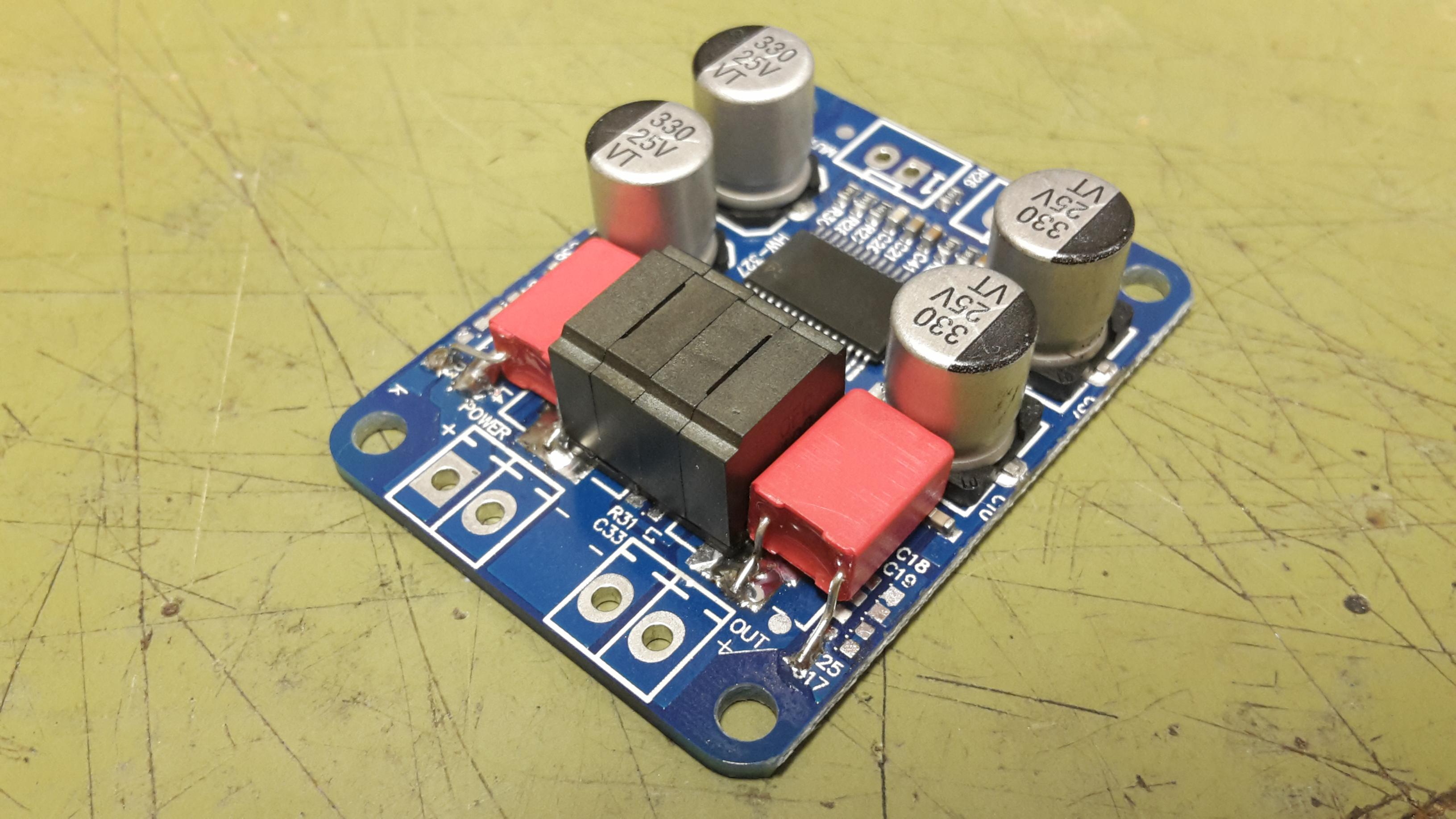

I've made a little comparison of a modified and a stock amplifier board, with regard to idle power usage. As you can see, there's quite something to be gained when using lower-DCR coils, and even tossing out all the ceramics on the output side yields some milliwatts. Might be of interest for battery powered applications.
attachment.php
The first column shows the stock board as delivered, with a gain setting of 32dB and neither input nor output connected to anything (didn't make a difference here). The idle power at 24V is almost 1.5W, which I had expected to be somewhat less - the datasheet states a typical idle current of 32mA (50mA max though) at 24V, which would have been half of that.
The second column shows the first mods. I removed the power LED with its resistor and the reverse-voltage protection diode. The inductors were replaced with a 10uH Sagami 2-in-1 with a typical DCR of 15mOhms. This reduced the 24V idle power draw by ~33%.
The last column takes the mod a bit further, in that now I removed the ceramic output caps together with the "EMI C-RC snubber" and replaced them with 1uF WIMA film capacitors. This saves almost another 100mW, which are only converted to heat.

Wouldn't it have been better to measure after each step to see the potential?
LED + Diode + Inductor is one part
EMI C-RC + MLCC-Foil change is another
I suspect the Diode has the least impact on idle-power, given a 0.3V voltage-drop, this renders to 9mW for 30mA idle current. The Led is having an influence of about 6.3mW at 9V, as the resistor is 10k at Vf of the LED ~2V. LED current is then 7V/10k = 0.7mA.
At 24V this renders to 24V-2V/10k= 2.2mA -> 53mW
The main power savers are the inductors here. Removing the CRC-Snubbers helps a bit more, but not that much.
For more saving check Pin1 at the TPA3118. If its on GND, the Chip is running BD-Modulation. When connecting this pin (lift up to do so) with AVCC, the IC is running 1SPW modulation, which uses way less power.

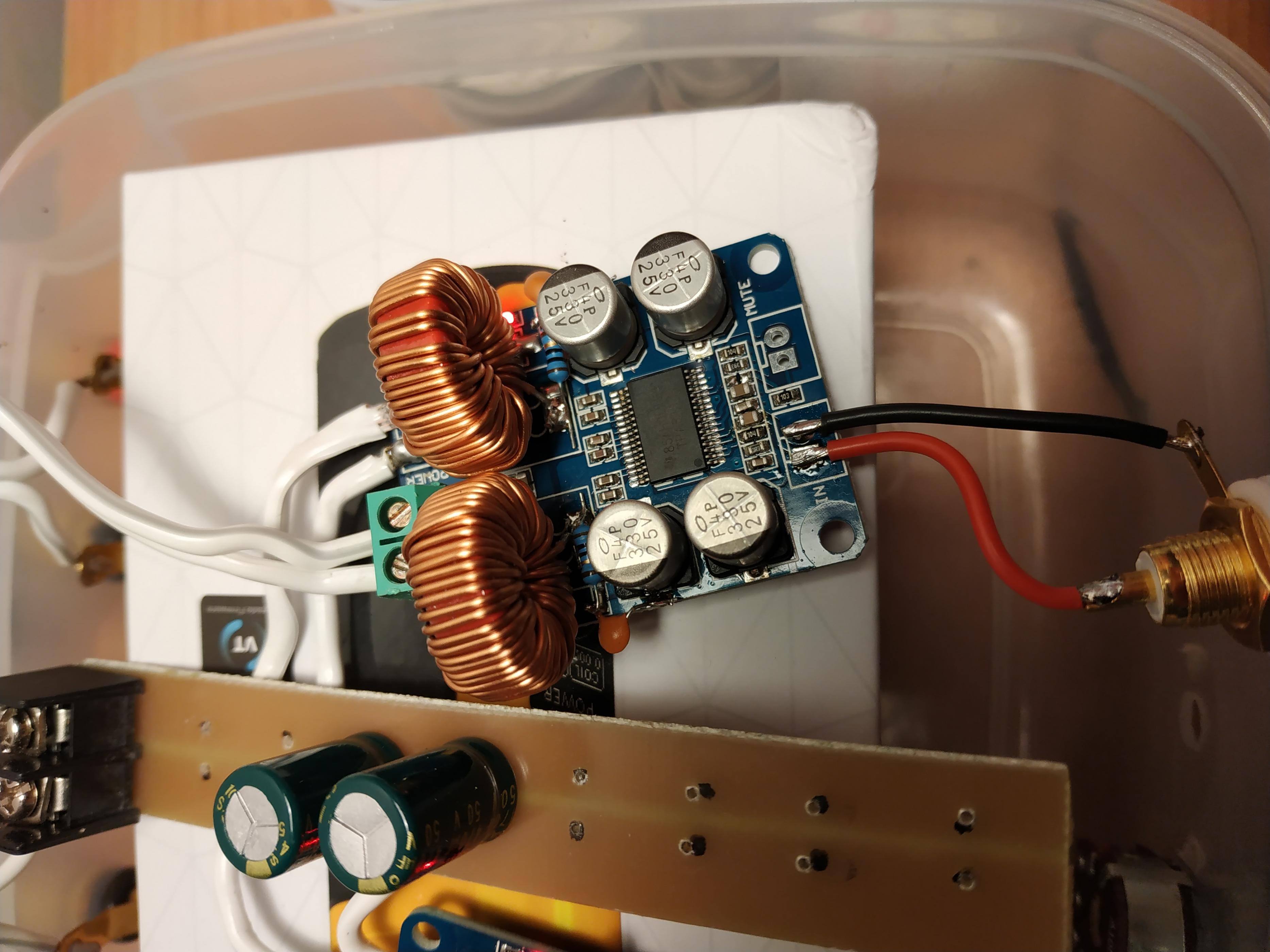

I must say, at first (stock, I just removed protection diodes and add some 470uf 25v cap on supply rail) I was really disappointed with the sound I get from, huge lack of bass, harsh and blurry highs... Terrific result on 8Ohms load with 19v 5a laptop brick.
I replaced input cap (c4) with 2.2uf x7r, original one were somewhere between 560nf and 640nf... Really to low, sorted out r27 to reduce gain and increase input Zin and bass were starting to came out but highs where sooooo ugly, still un listenable...
I added some snubber 10Ohms + 300pf between choke input and ground, not enough, I'm not sure it helps a lot.
Then I downloaded the ti filter calculator spreadsheet and according to some simulations, swapped 10uf smd inductors with 22uf toroid I removed from my tda7498e board.
With the stock 1uf at stock filter it's just a bit under-damped at 8Ohms load and over-damped at 6.
Now it sounds really excellent. Nothing to say, I'm impressed !!!
For 1.5€ + 2€ more on parts and some solder job per channel you can get a pretty decent listening experience.
Better to my taste to the tpa3116 boards I get before
It just lacks a bit of the juice I like a lot with tda7498e.
So, just an advice if you have to drive some 8R speakers, just go to 22uh beefier inductors, you'll never regret.
@Preamp, where did you get you inductors and what are the values? 22uh is the perfect match with 680nf for 8R speakers.

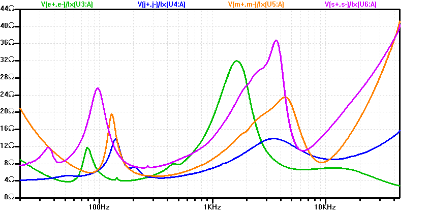

These are the measured responses of the speakers that I have around.
The magenta trace is for my main speakers, Spendor S6. As you can see, the impedance rises pretty steep above 10kHz, and probably continues to do so above my measurement limit. Unlike the green trace, which shows some heavy Canton speakers, that simulate pretty much like an ideal 4 Ohm load!
Here's the LTspice sim file again.
