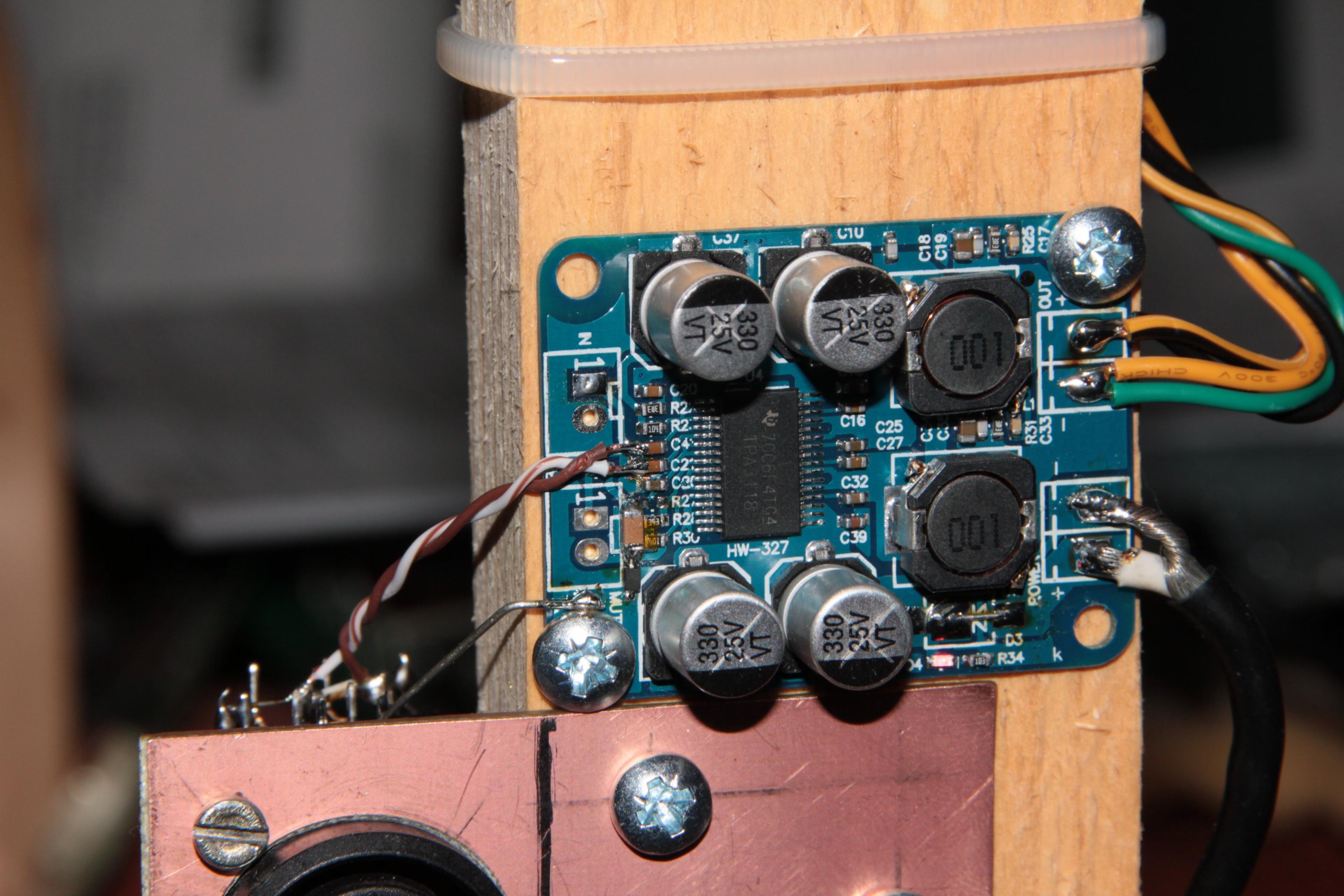

I finally managed to put my first two of these little TPA3118 boards to (good?) use. The "twist" is, i made them balanced-input 😀
All that needed was to "carve out" a small island around the ground-end of the inverting input coupling cap, thereby disconnecting it from ground, and hooking up the "cold" signal wire 😉
More details and photos over on my blog, for whoever's interested 🙂
Wouldn't it have been easier to mount that input cap "tombstoned" soldering the wore to the top then?
Mmm... Since those 0603 components are small to begin with, and MLCC's are brittle / fragile anyway, i preferred to leave it mounted as it was.
Those two little cuts were quite trivial though, the whole operation was done in less than a minute 🙂 Including scraping off the solder-resist from the leftover input "island", to give a larger solder blob to solder the wire to.

PS: Those CAT5 wires are solid-core anyway, so that would've just been (potentially) some extra stress on an 0603, and that seemed unnecessary.
PS2: Might as well attach that photo here, for those who can't be bothered to click on a link 😀
[edits]
Yes, but you need somewhere to mount those, too 😉
Even if we were to ignore the connector block legs poking out on the bottom (which would've needed drilling another hole), i would've had to (also) "cut out" the ground pad for the input "connector", on both sides of the board, to isolate it from the ground planes, AND isolate the ground end of that coupling cap, AND run a short little wire between those.
Proper? Nope, not even close 😀 But was it the quickest, easiest and least "traumatic" solution? Hell yeah...

Power and output are also soldered and a connector block is not luxury at those positions (certainly with possible mechanical stress AND 2 wires per position). Also the use of standoffs is recommended to avoid mechanical stress on SMD parts. I count 4 holes and see 2 wood screws...
Anyway, do what you think is best. I hear many times "I will correct later" and almost never see that happen. It is just losing time to deliver sloppy work as one has to to do the same thing twice.
I made sure to fill those holes with solder before adding the wires, so they're not only "surface-soldered". That, and it's a 'fixed installation", and the cabling is quite securely zap-strapped, with some length left to act as strain-relief (see the other, wider-angle photos there).
Like i said, i know it's not "commercial equipment grade", and this was an almost-100%-free project to reuse some stuff i had lying around 🙂
PS: One other reason (or a couple others, actually) for not using connector blocks is that i didn't have any small-enough ones in stock, nor was i willing to bother searching for some, spend more money on those, and wait for delivery. I got these things done in a couple afternoons / evenings, and they work 😀
