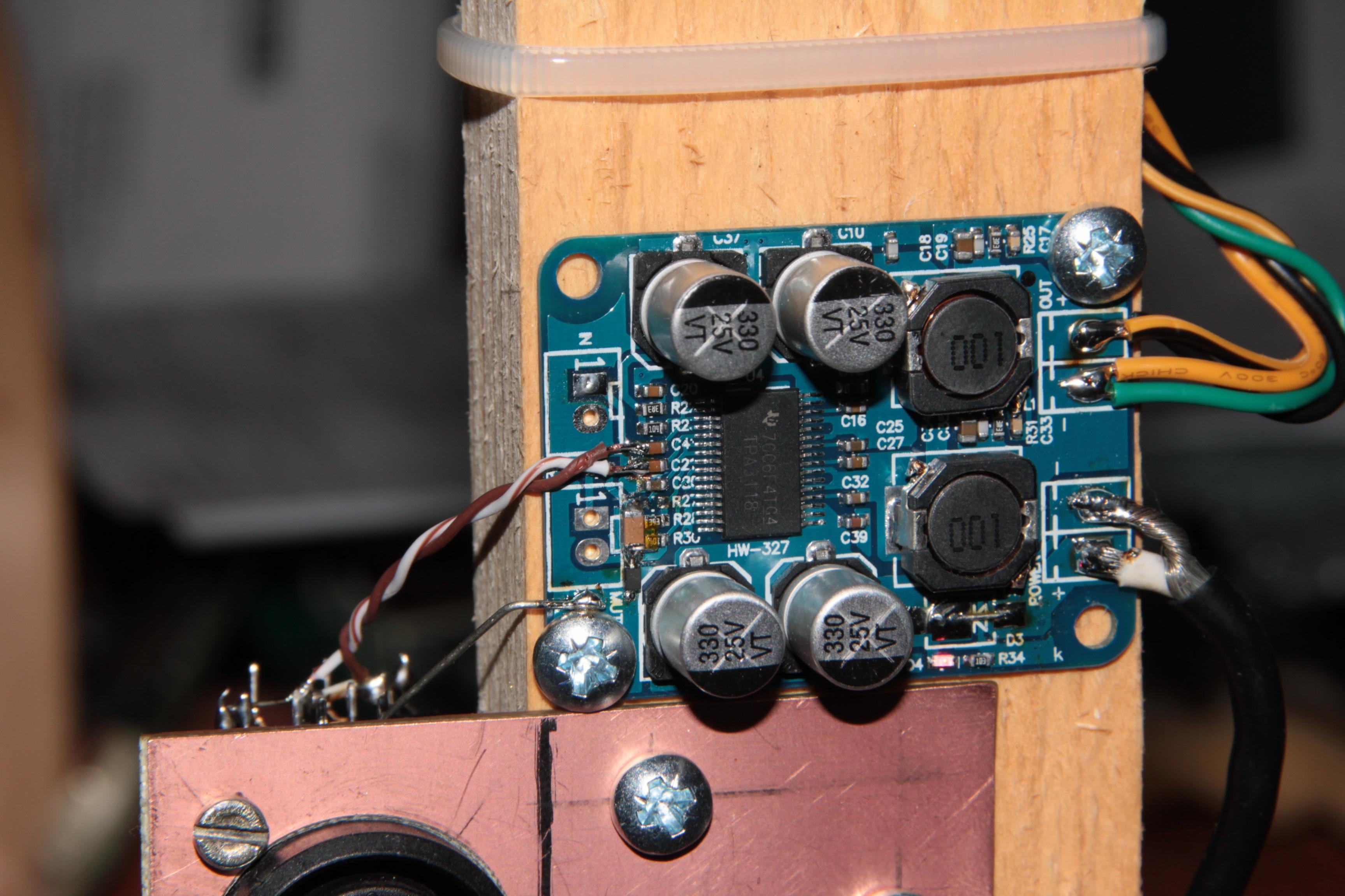

Heatsinks on top of the chips?
TPA3118 thermal solution is through the underside. Usually you see an array of holes on the underside of the board beneath the chip.
J.
J.
I've used about 10 of those boards, without any added heatsinks. They barely get warm, even when powering 2 ohm loads at high volumes. (Granted I used 19 volt laptop power bricks, you are using a 24 volt supply)
The heat-sinks you added will not do any harm, but they are probably not needed. As already described, the 3118 internally is thermally connected to the bottom of the chip. That is soldered to the PC board for its cooling.
The 3116 chip needs a heatsink on its top... It is the exact same silicon, but internally upside down from the 3118. Your boards use a 3118.
In addition, the cooling fan you added will likely have nothing to do, as there is hardly any heat generated in your amplifier. (Suggestion, try the amp, at full power without the fan running, and see if the heat-sinks you added get warm at all. Odds are they will be very cool, without any additional cooling needed.) Unless your power supply generates lots of heat, and requires cooling, the fan will make more noise than it is worth.

Mine are barely taxed. A pair of Asus 19V laptop bricks power them in pairs, one amp per driver.
When XRK did some tests he attached them to some substantial heatsink and drove them hard through a meaty resistor.
http://www.diyaudio.com/forums/clas...18d2-boards-modding-comes-25.html#post4585203
Interesting he mentions them being warm at idle with 24V PSU but not with 19V.

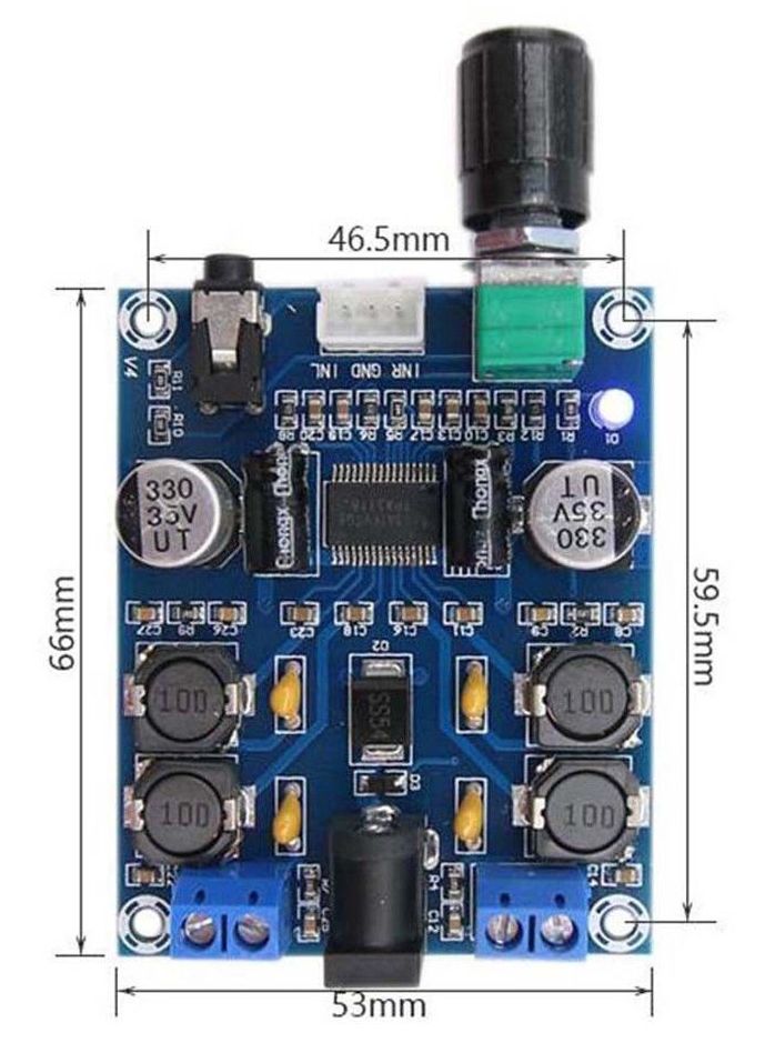

Any case you can recommend to house a TPA3118D2 board?
I imagine there should be many, but I can't find them on eBay.
Really?
It's a small board, it will fit pretty much in any case.
And we cannot possibly know about your setup, what else needs to fit in the enclosure.
Try search for amplifier enclosure and make your pick.
Really?
Really. Have you looked for such cases in eBay or Google?
A small board with at least three precision holes to drill.
Nothing else goes into the box, except for the output speaker connectors.
Looking for amplifier enclosures won't get me one designed for this board.
The ones for the TDA3116 are different, and they are also acrylic, which is too fragile and does shield RFI.
With all this thread pages I assumed this question had already been solved.
Oh, I see. So you have that version with the potentiometer and aux in at the front and power jack at the back.
I would say that get a bit bigger enclosure than the board is, and mount the board to the front panel, so two holes to be drilled. Then get a separate panel mounted dc-jack for the power.
That's not what I asked. That I can do but do not wish to.
I wanted to know if anyone knew of any compatible enclosures for this project.
