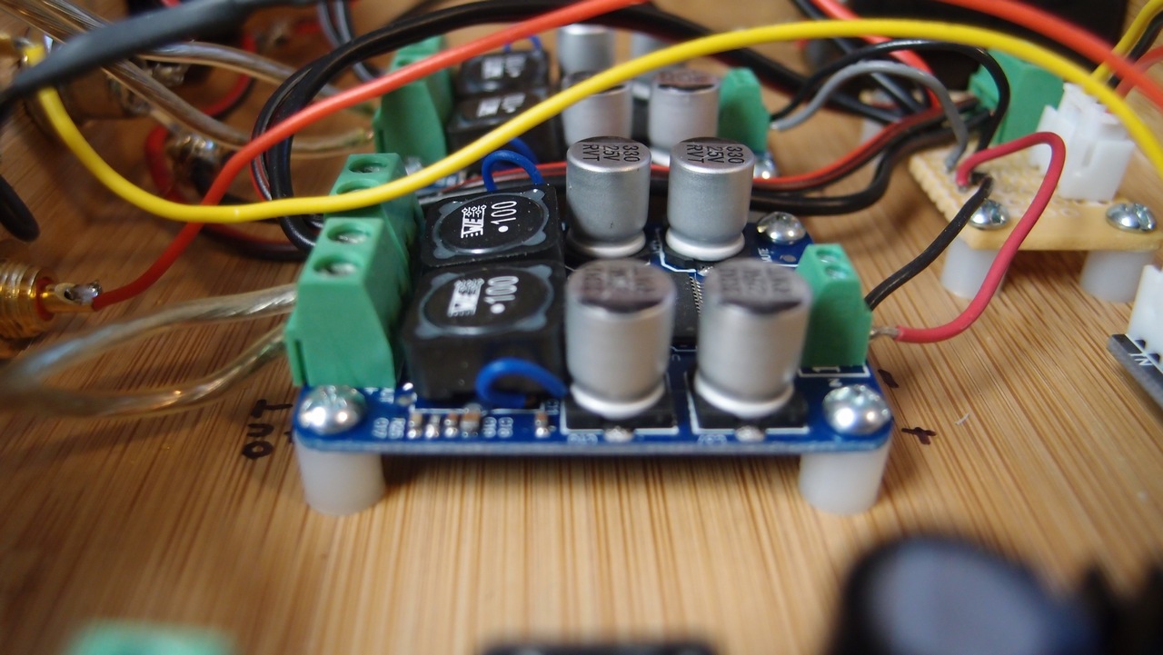

Inductor Install
This is how I did it. The inductors are Wurth 74477110 10uH 5A, $2.12 from Mouser. I soldered a pigtail to one end, soldered to the tab and pressed down onto hot melt glue. I then soldered the other end directly to the pad. The inductors do not lay flat. This has to be done before attaching the terminal blocks. Also note that the terminal block through hole spacing for the power is tighter than the standard 5mm, which can be made to work, but I found some Phoenix ones with 2.54mm pitch for a better fit.

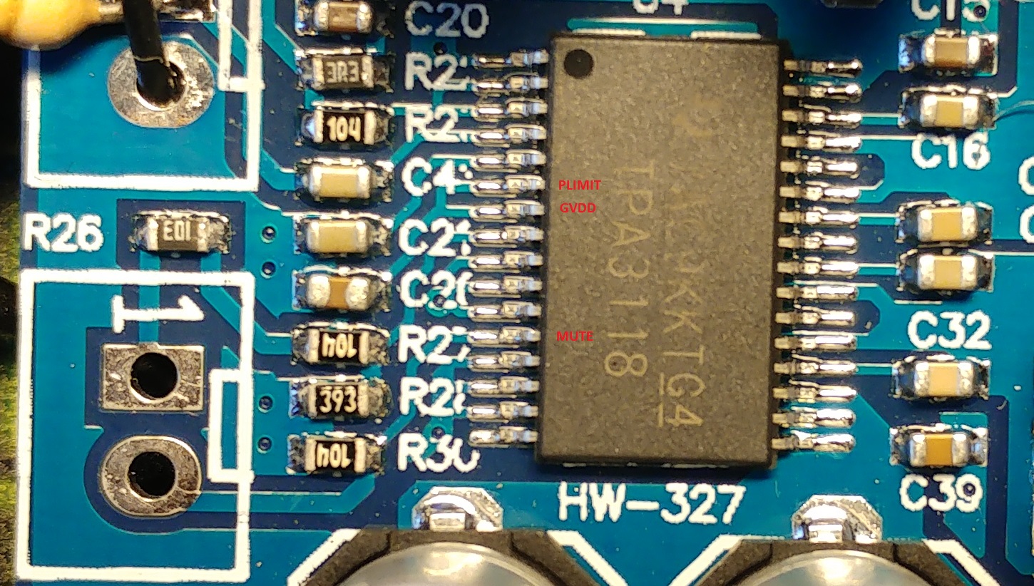

I need to implement your antipop-design, but I'm not sure how. I mean I find the corresponding pins from the board, but am I supposed to replace existing components or just add what you have here? I took a closeup about the situation so maybe you guys could help me.
And what about the used components? Is there some specific requirements for the resistor, capacitor and diode? Can i use a basic through hole-resistor and electrolytic capacitor?

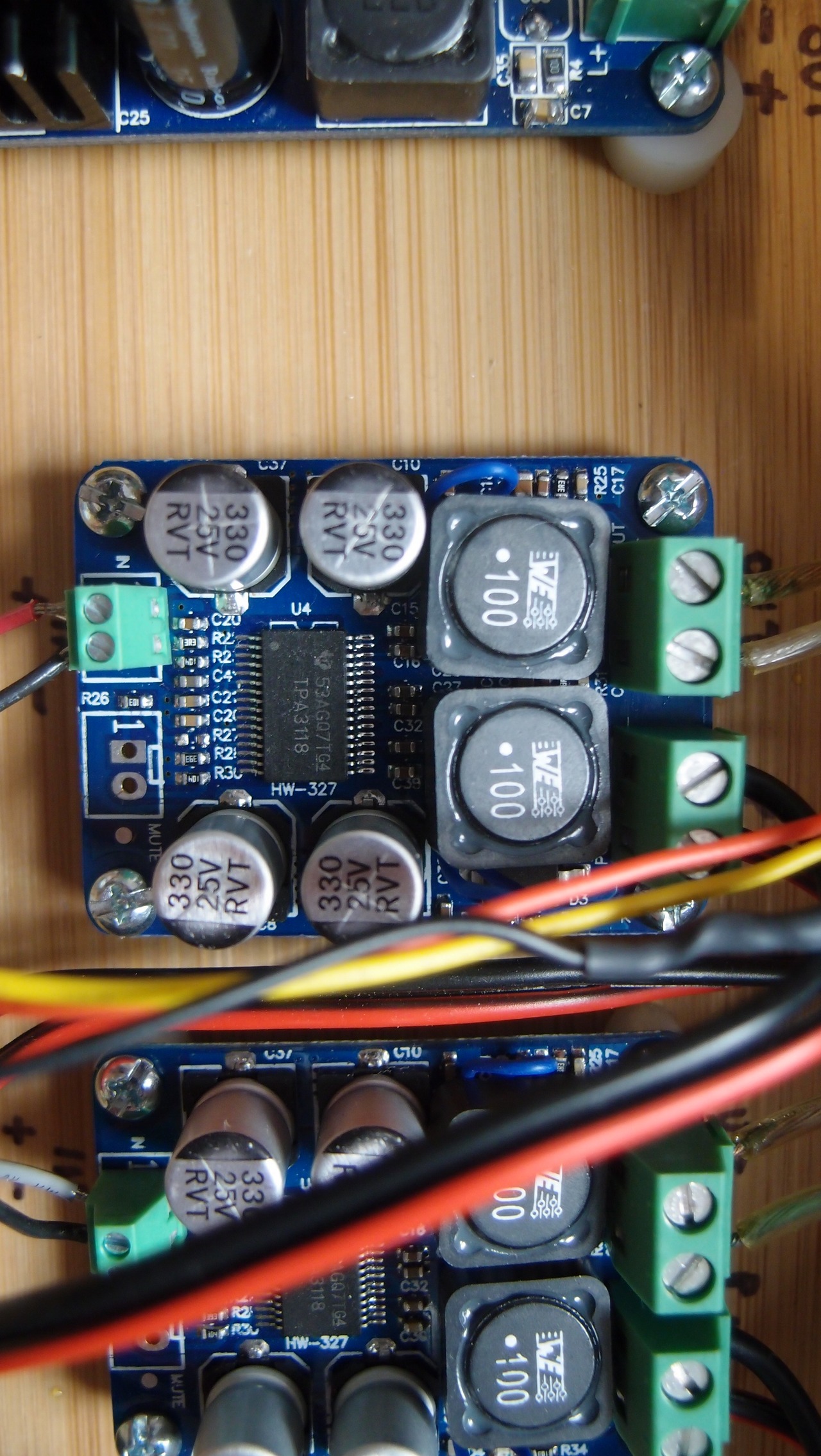

Finally mounted, wired and testing
Got everything mounted and wired. Testing went well, it worked! lol. These are stock Sanwu's, no mods yet as I wanted to be sure all my other hardware is correctly wired first. All good 🙂
Couple of observations, amps connected to Klipsch KSF 8.5, 8-Ohm speakers:
- no audio amp noise, noise is only observed when less than a foot from speakers, then only slight
- using a switch, mute pins make the speakers completely silent
- decent bass for tiny amps, powered by 24VDC up to 6A power supply
- mids & highs are crisp and clear (speakers are a big factor)
- iPhone 6+ can push the amps into thermal shutdown in about a minute
- Chromecast Audio can push amps into thermal shutdown in about 30 seconds
- Alexa won't respond if the music is cranked up, unless it's during a quiet passage 😉
Obviously, the enclusure needs top cover installed. That cover mounts the IEC 120VAC input socket (uses same cord/connector as desktop pc), which includes a fused, lighted switch.
Overall, very happy. Time for some mods and wire routing cleanup.
