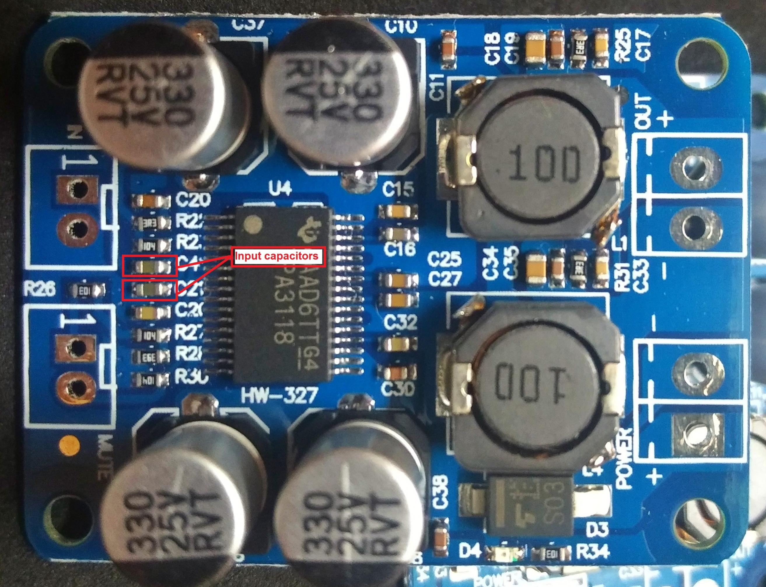

Question: Does anyone (knows if there are) which are the input capacitors on the small blue boards?
I've searched the thread and nobody is talking about them and we know how important they are. Also changing the gain changes the input impedance of the amps which is further related to those input capacitors. Though decreasing the gain, the input impedance increases meaning there is no need for bigger input caps...
Is it that difficult to 1) check the datasheet of the TPA3118, and 2) find a large-enough and clear-enough photo of one of these small blue amps, to follow the traces?
I'll try harder, because I really can't spot the traces 🙁 (You're so mean.)
Seems these are the ones? Am I seeing right?
http://sorbits.dk/classd/IMG_20160806_173342.jpg
C4<something> seems to go from the input pad to pin 4, and C2<something> seems to go from pin 5 to ground.
PBTL is the lower half of the schematic on page 20 of the datasheet
