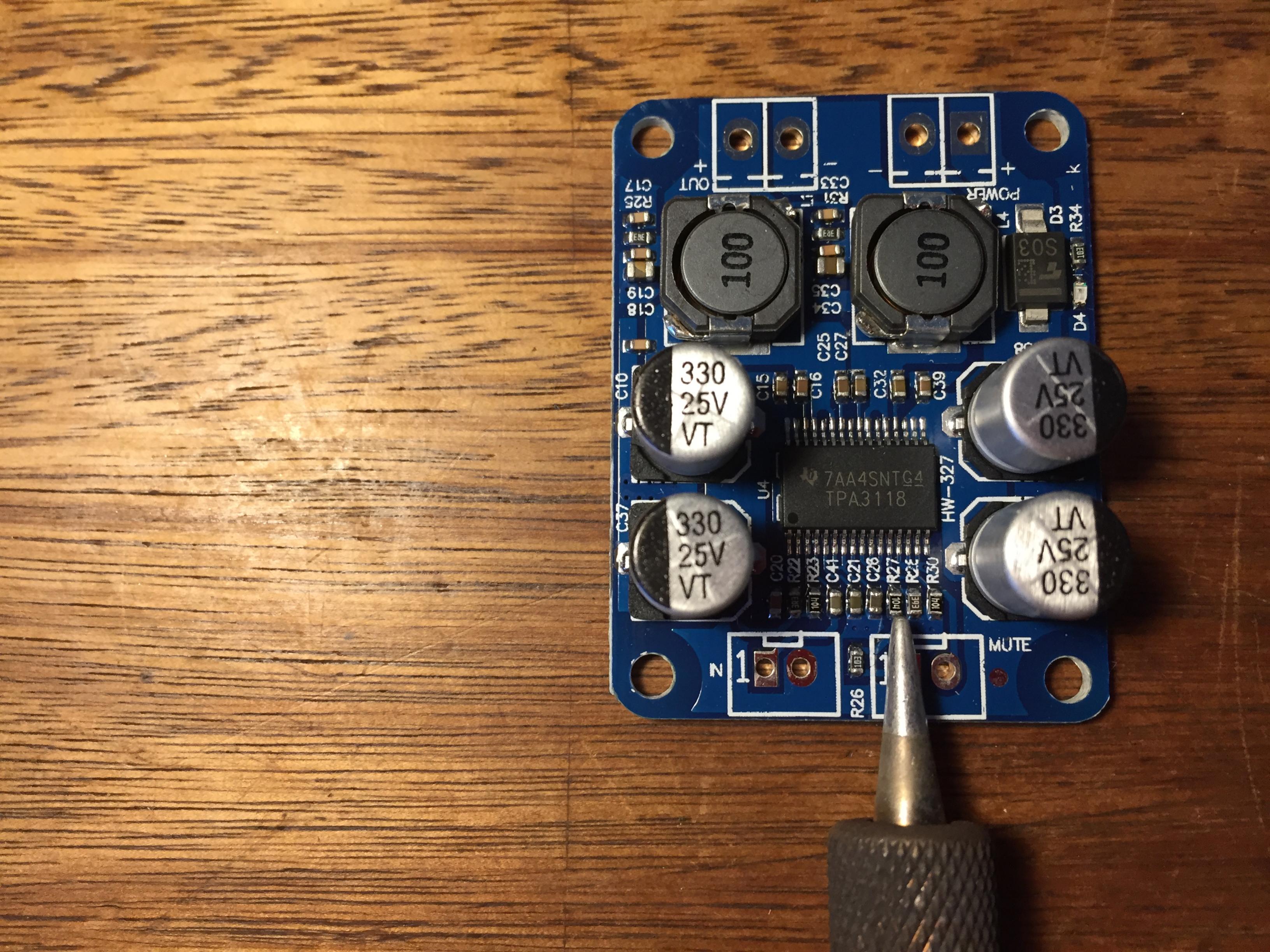

I have an arguably "barbaric" method for removing SMD components, but it works pretty damn well.
Step one - add some solder to each end of the (passive) component in question
Step two - grab a pair of tweezers in your non-main hand
Step three - maneuver your soldering iron in such a way that the (side of) the tip lays flat on top of the component, and the solder-wetted area of the tip reaches both blobs on the ends of the component in question
Step four - when the solder on both ends of the component is molten, grab it with the tweezers (even "through" the solder) and remove it.
Cleaning the solder off the remaining pads is optional, but welcome. You'll also wanna check that you haven't created any solder-bridges during the procedure.

Removing an SMD resistor with a soldering iron is much easier than placing an SMD resistor. I use a method similar to Krohn:
Use the fine tip on the soldering iron. Put some solder on the two terminal ends of the resistor you want to remove such that the solder form small balls. Clean the soldering iron tip. Place the soldering iron tip on one end of the resistor, in contact with the solder ball, and push toward the body of the resistor. Then, move the soldering iron tip to the opposite end of the resistor and push toward the body of the resistor from that end. Move the tip from one end to the other end of the resistor more times such that the solder on both ends melt. After a while, also the glue that held the resistor in place during wave-soldering will give in and the resistor starts moving. Most often the small SMD resistor will stick to the tip of the soldering iron due to the surface tension of the solder. That’s it!

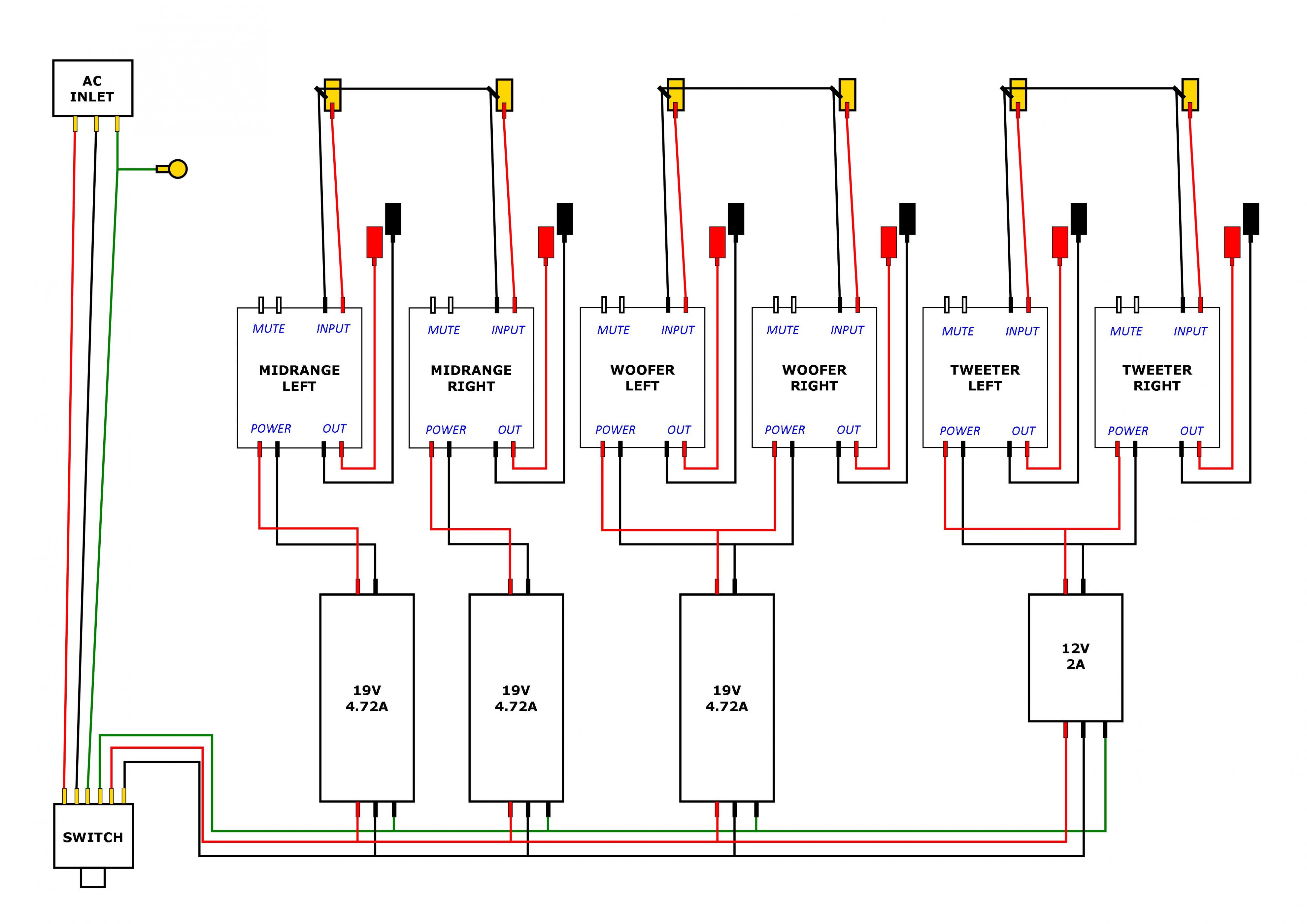

6 channel TPA3118 amp build
Guys.. just wanted to ask for your advice/critique/recommendations for this? I'll be using this for a 4-way speaker, using a Linux PC with PulseAudio Crossover Rack by TFive. The sub will be powered by a different class AB amp. Each 3118 module pair will be supplied with a single 19V 4.72A laptop brick. The mute for each module will be turned on/off by a single switch with 2 rows of 6 terminals (I don't know the name but I got it off an old Yamaha amp). I've tested a pair
already, but just wanted your advice before I assemble everything. This is my first build 😀
And also, how would I add an LED power indicator after each brick?

Usualy power supply and amps have a power LED.
If you need an additional LED, you have to use a resistor in line with it. Value depends on the LED you use.
The use of a 100W supply for the tweeter is over kill.
Better give each woofer a brick and use a single one for mid and tweeter. Makes more sense, might sound better.
As far as I know the mute pin´s can all be connected to one switch, but will do no harm if you switch each one separate. Just a lot of wires.
Take care with earth wires or you will have a whole lot of noise. Set the amp modules to the lowest amplification, this will reduce noise, too!
PS let the amp modules burn in on a resistor or cheap speaker, if they fail, this is probably during the first hour of use. So you do not risk expensive speakers.

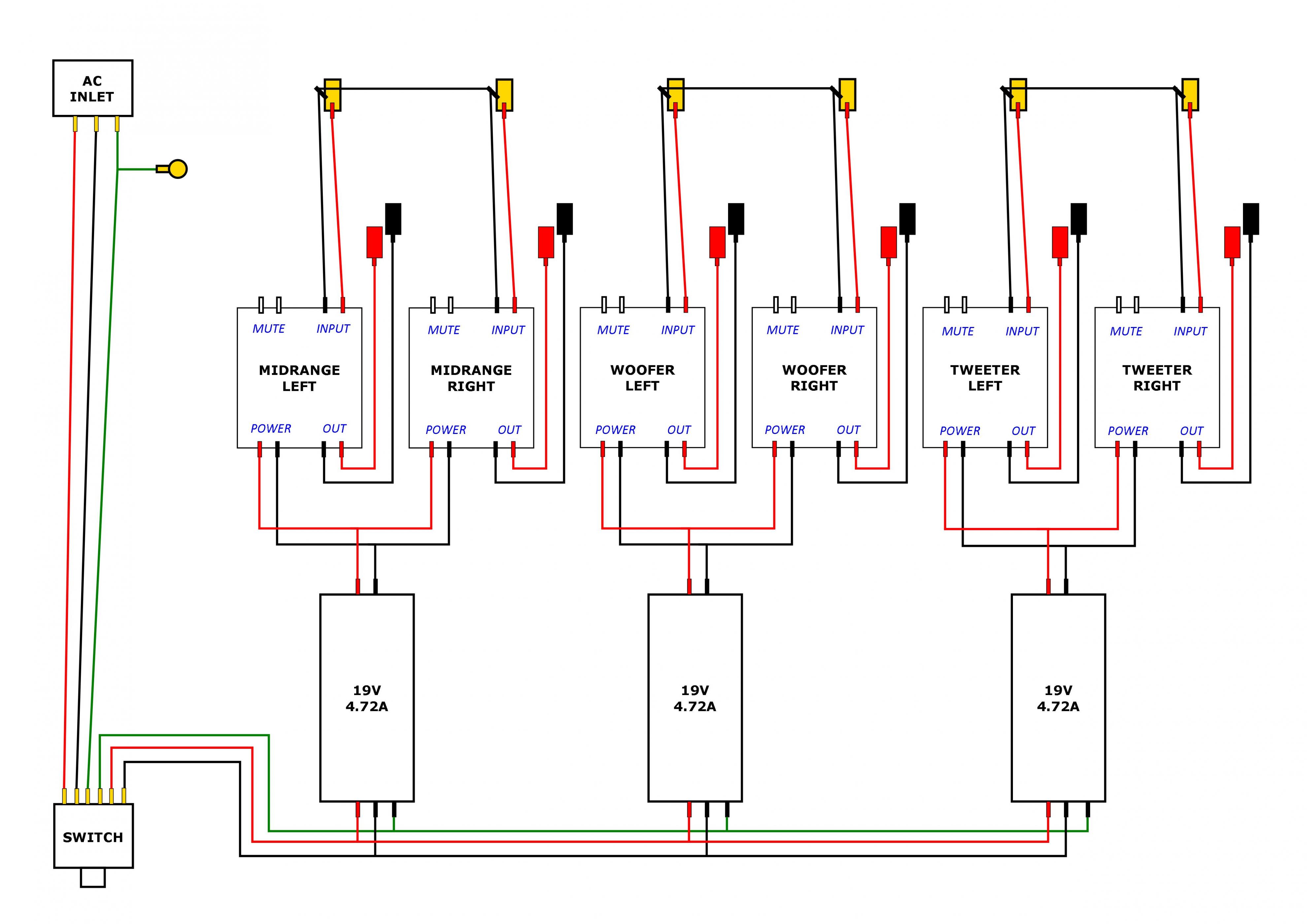

Thanks for your reply!
About the LED, the modules already have a very small power on LED, I was just thinking of adding this indicator light to the front panel of the enclosure, one for each pair, so connect it to the DC side of the laptop bricks. Will try it out. The AC switch already has a light of its own around the button, the assembly of which I got from a broken yamaha amp.
For the power supply setup you mentioned, you mean like in the first pic attached? Would it be okay to connect the midrange pair and the tweeter pair to a single brick? How about if I use an additional 12V 2A for the tweeter pair only? This is the ps that I tested the boards with.
And about burning in the boards, I've tested a pair with the 12V ps on two 8" drivers for maybe several minutes. When the amp is connected to the source (phone) and turned on, there's this clicking sound coming out from the speakers, no buzz or hum, just this annoying clicking, and it stops when the music plays. I hooked up the switch for the mute, connected the boards to an old Technics 3-way, powered on the amp (but still on mute, and there was no clicking sound), played the music and unmuted the boards. It sounded really nice and clear, although the bass is somewhat lacking, or thin maybe. I played the boards straight for a couple of hours, testing on different kinds of music. I'll be getting the enclosure tomorrow so hoping to hook everything up and try out PAXOR. I'm planning to test the whole setup first, and see if I need to do some modding on the boards as previous posts suggested (changing the gain, snubbers, replacing the 330uf caps, etc).
Final question, is the grounding/earthing in the diagram okay? I'm using twisted 2 core shielded cables for the input, very short, and twisted awg18 wires for the output. Sorry for the long post, but thank you for your reply.

KieranFM,
Not sure what your question is. What you have should work but you probably have too many PSU’s. Unless you were planning on running them full power. The problem with multiple amps is sometimes they have a modulation frequency interference and hence need to be in master/slave mode with frequency connection.
Clicking you have sounds like maybe one of the psu’s is cycling on/off? Or a bad PSU. What amps are you using?
I would use separate power supplies on all of them unless you plan on using frequency master/slave option. That will reduce interference. Sketch you have should work but make sure you use star topology for ground - not bus topology.
X
