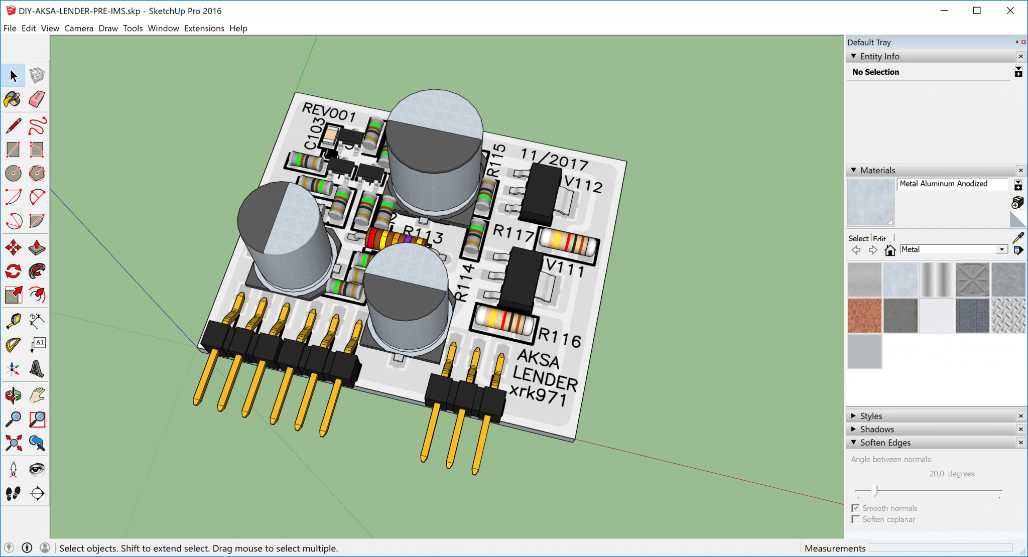

I used aksa Lender schematic and created a new Layout (with 0805 Bridges ) single sided
This can be produced on Aluminium PCB
And a Second Variant with a Diamond Buffer Stage. These are Modules with same connection to Mainboard ..
so i can Test two different Output stages
Cool, you are fast. I think these were the IMS (integrated metal substrate) layouts JPS64 had made already:

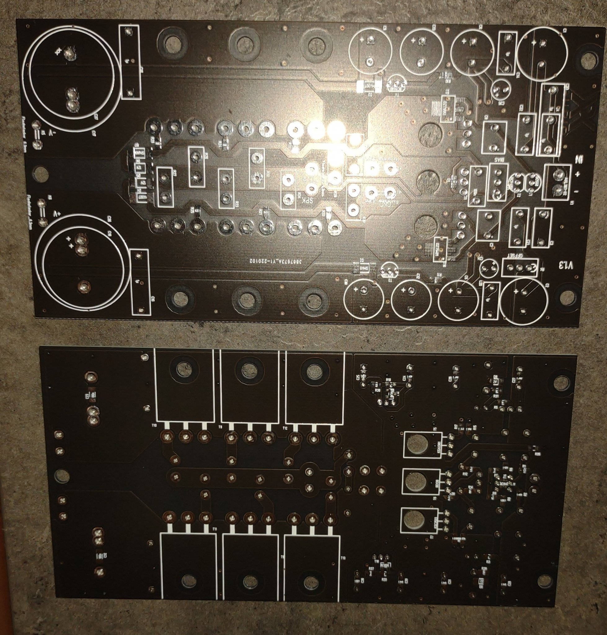

Hi,I got my boards today. 🙂

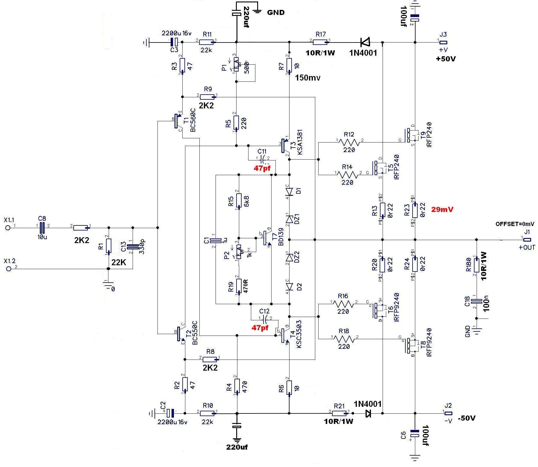

What are the T1/R1-T2/R2 values? What would you recommend I use? Also what is set with T1 and T2. Thanks in advance for your help.
This was the latest schematic as built by Thimios. Not sure what your question is?
The values are in the schematic.

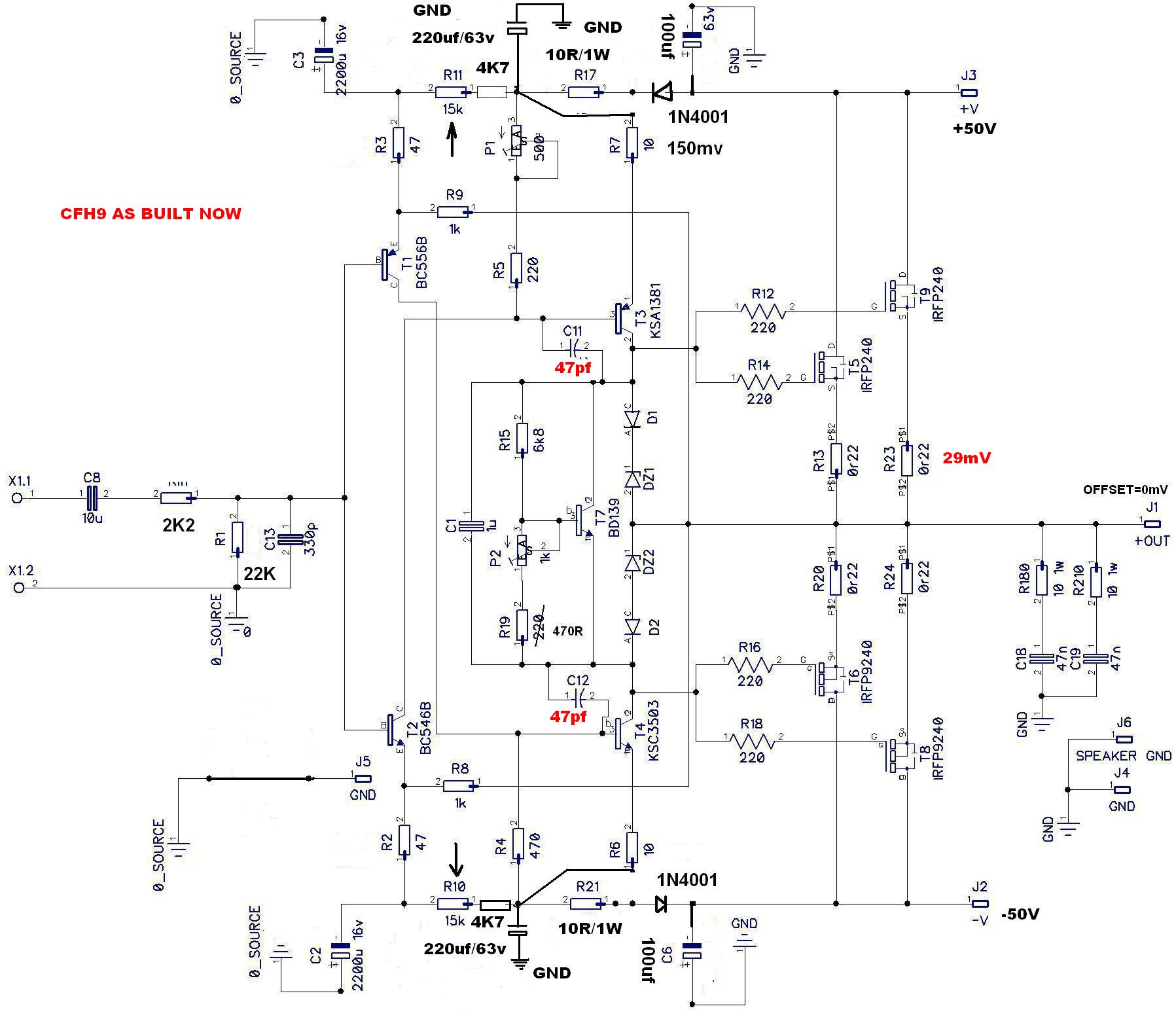

Hi xrk971No worries. Just wondering if that last layout by Thiago is good to go. If anyone else has built it and got it to work please let me know.

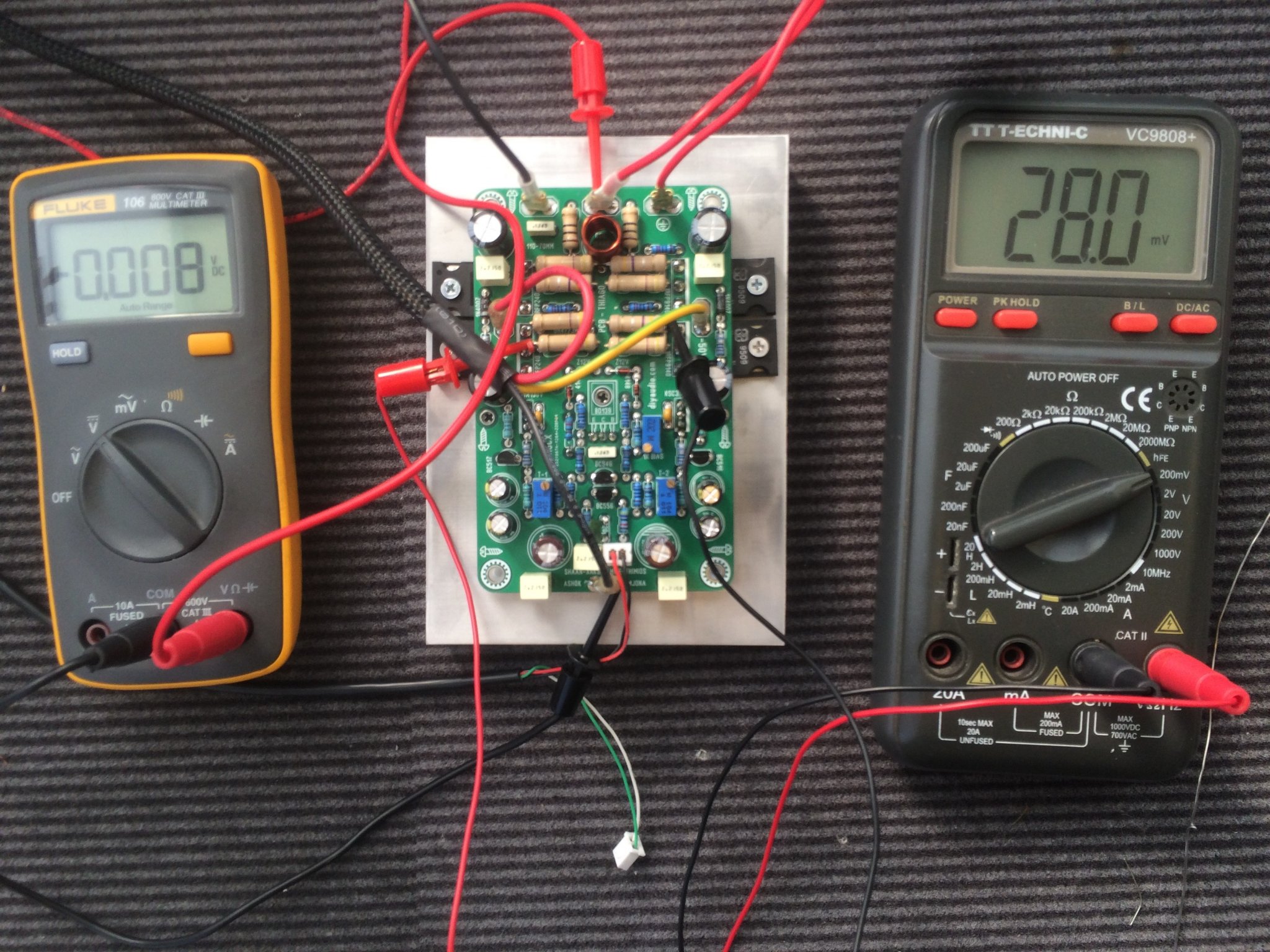

I have finally completed the assembly of the board. no problem. excellent sound. offset voltage:0.008v. quiescent current:28mv.
Thanks xrk971.
Thank you Thiago
I would replace the signal transistors with low noise type. You can use there BC550C & BC560C. Same pin out. The 50V max. rail voltage should be low enough to use the mentioned transistors at that place.This was the latest schematic as built by Thimios. Not sure what your question is?
@fazildiken - Super work! Thanks for showing us that this layout works. It’s a great sounding amp from what I can remember.Hi xrk971
Thanks xrk971.
Thank you Thiago

I made some tweak on the schematic, I simplified some of those after made connections and I CHANGED some resistor values and the feedback also.
This is how I will build it. Schematics attached.
Opinions welcome.

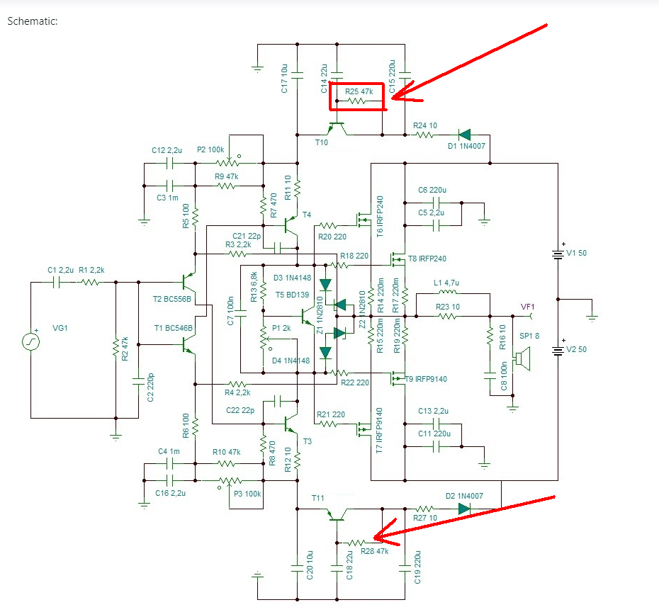

I didn’t design the cap multiplier add on but generally that resistor sets the amount of “ripple reduction”. Get some extra values like 4k7, 10k, 22k - I think the larger value gives lower ripple at the expense of the frequency response to track the faster variations.
47k and 22uF gives a -3dB point of 1.4Hz which is not a bad point to set if one is trying to smooth 50Hz ripple. 10k and 100uF works too.

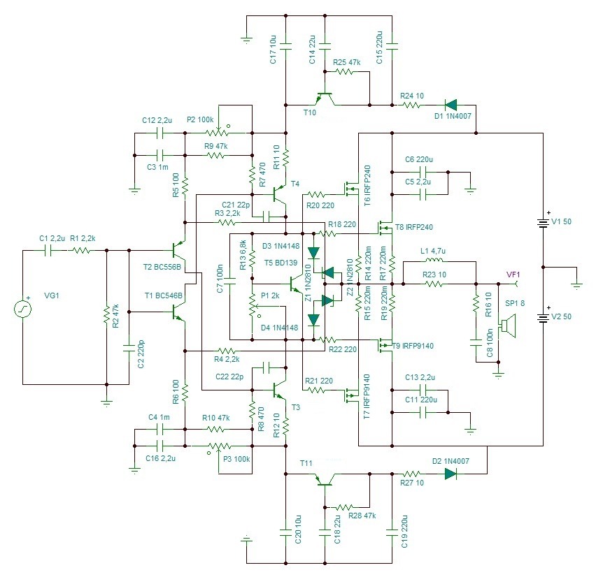

Hi X,
What is the correct schematic for Thiago’s layout of CFH9 pcb? There is a couple versions posted, one also with a Schade influence. Thanks
Ive seen designs where theres a cap to the gnd between the zener and 10ohm. 0.47uf usually. I never found the explanation for it. Have you tried simming that?I didn’t design the cap multiplier add on but generally that resistor sets the amount of “ripple reduction”. Get some extra values like 4k7, 10k, 22k - I think the larger value gives lower ripple at the expense of the frequency response to track the faster variations.
hi Vunce,
I think it’s the same one on post 1036:
At least we know it works as designed:
The oscillations were already handled by Thimios’ mods earlier. This adds the cap Mx for the front end. One thing about that is that you lose some top end voltage to drive the highest peaks due to cap Mx dropout. The cap Mx can be bypassed if one has a sufficiently low noise and hum is not an issue.
Last night I went over on that schematic and looks like that is the correct for the PCB.
I only did not like the previously mentioned resistors. For start I will use a 4k7 type.
I do not think that will influence the sound of the amp "that much".

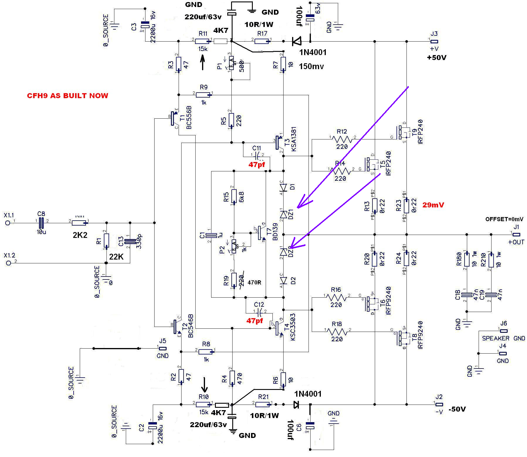

Hi
I have 2 questions IF someone could answer about it would be great.
First question.
For 12V zener diodes I only have at hand 10V or 13V can I use any of those?? If yes wich one......
Purple arrow on the circuit..
Second question

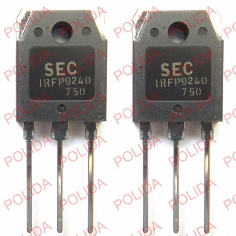

I only have IRFP9240 Mosfets marked as SEC, I believe Samsung Semiconductor. It is original, purchased at local store many years a go,
similar to the Polida's picture. Picture just for visualization, not from Polida!.
MY question can I use those as a pair for the IRFP240?
Please let me know. Thank you
Greetings
First question.
This diodes are supposed to protect gates of fets. As far as I know, anything higher than 8.2V will be OK.
I would use 10V.
