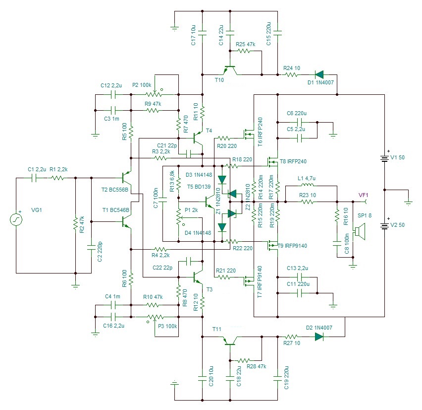

CFH7 Amp
Originally Posted by zoky2 View Post
apexaudio,
I replaced 6k8 resistor with 12k and still no change . Something other must be wrong
Regards
zoky2
XRKaudio wrote:
Did you ever resolve the lack of bias issue?
Yes, I was resolve bias issue,but I can t remember how exactly I do this.
It was something with 100k trimers T1 and T3 and some voltage across them.
Sorry ,I can t remember anything else.
Regards
zoky2

Sorry I developed this back when I was using Tina. I have since switched to LTSpice but never made this one. It’s easy enough to make from the schematics. All common parts.

Hi Saddevil,
I took your LTSpice file and modified the FFT analysis part to use V(out) label. Changed the gate snubbers from 22 ohm to 220ohm. Otherwise the schematic is the same.
It runs fine and a nice performance: at 72Wrms (68Vpp) into 8ohms has
predicted 0.00123% THD and nice harmonic profile. Dominant third order and
descending higher orders. This will only be true if parts are matched but in reality, MOSFETs and other parts are not matched above and below so THD will be a bit higher and distortion profile may end up being dominant 2nd order (a good thing).
Here is predicted FFT:
attachment.php
Revised .ASC file attached.
