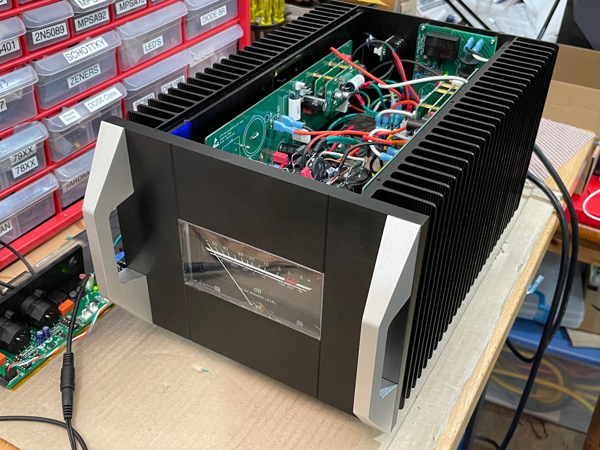

Griddle Amp:
Here is the 100W Class A monoblock prototype. One channel completed, need to build second for stereo.

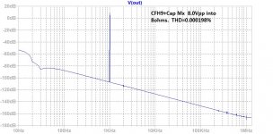

For comparison, here is LTspice prediction of CFH9 making 1W (8.0Vpp) into 8ohms - essentially distortion free.
I have ordered the PCBs:
Code:
Harmonic Frequency Fourier Normalized Phase Normalized
Number [Hz] Component Component [degree] Phase [deg]
1 1.000e+03 4.060e+00 1.000e+00 -0.08° 0.00°
2 2.000e+03 4.982e-06 1.227e-06 177.28° 177.36°
3 3.000e+03 3.914e-06 9.640e-07 169.33° 169.41°
4 4.000e+03 2.926e-06 7.207e-07 -179.92° -179.84°
5 5.000e+03 2.354e-06 5.797e-07 -179.83° -179.75°
6 6.000e+03 1.960e-06 4.828e-07 -179.96° -179.89°
7 7.000e+03 1.679e-06 4.135e-07 -179.97° -179.89°
8 8.000e+03 1.468e-06 3.615e-07 -179.97° -179.89°
9 9.000e+03 1.304e-06 3.211e-07 -179.97° -179.89°
Total Harmonic Distortion: 0.000198%(0.000000%)

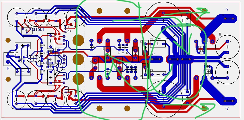

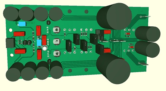

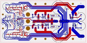

in meantime i finished the layout for CFH9 + CMx
160 x 78mm for one complete channel
some parts have a wrong 3D drawings ... it is too much work for corrections ^^

I didn’t realize you were adding a high current cap Mx to the main outputs. This is a Class AB amp with reasonable PSRR so should not need a cap Mx on output stage which limits max current for deep bass transients. You will also lose 4v drop per rail or 8v total of peak to peak and this is a lot of power loss. You can compensate with a linear trafo that is rated higher voltage. But in general, I only use cap Mx on output stage for Class A amps that have lower PSRR.
On your layout, you have a lot of long ground traces that go past high current regions. This creates a large loop cross sectional area that might pick up emitted EMI from high currents. Perhaps use a ground plane on one side of PCB? Or place ground star hub more central to minimize the length of the spokes from the star hub.

Yes -
it is better to have them than to need them , or?
i can remove the Fets and bridge the pins
question is: is this a real problem or can it be a benefit
usecase is normal listening ... no full power use
speakers have a good sensivity, so i dont need so much power
so idea is to have better PSRR , SNR and channel separation

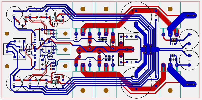

yes .. i know .... :-(
one option is to place an additional GND connector as second ground star for input
second is to use one very large GND trace instead of the 4 smaler traces
nearly a large plane on top side
Move the ground more to the input side makes pcb larger ( no option )
Here is how I would approach it. Swap the output stage cluster with the ground star hub cluster. Please see sketch markup. Use thick ground trace rather than many smaller equal length ones to reduce EMI pickup and rely on low impedance path. This centralizes the star hub to board centroid. I recall Thimios had oscillations when bulk rail caps were large 4700uF and switching to 100uF stopped oscillation. Make the caps after the cap Mx smaller. Probably 1000uF max. Cap Mx would decrease ripple by about 50dB but loss of 4v is too much of a tradeoff in my mind.
I would also move the actives out closer to the edge so bolts visible without cutout holes. Lining all that up and precisely tapping 7 holes on heatsink will be a pain.
