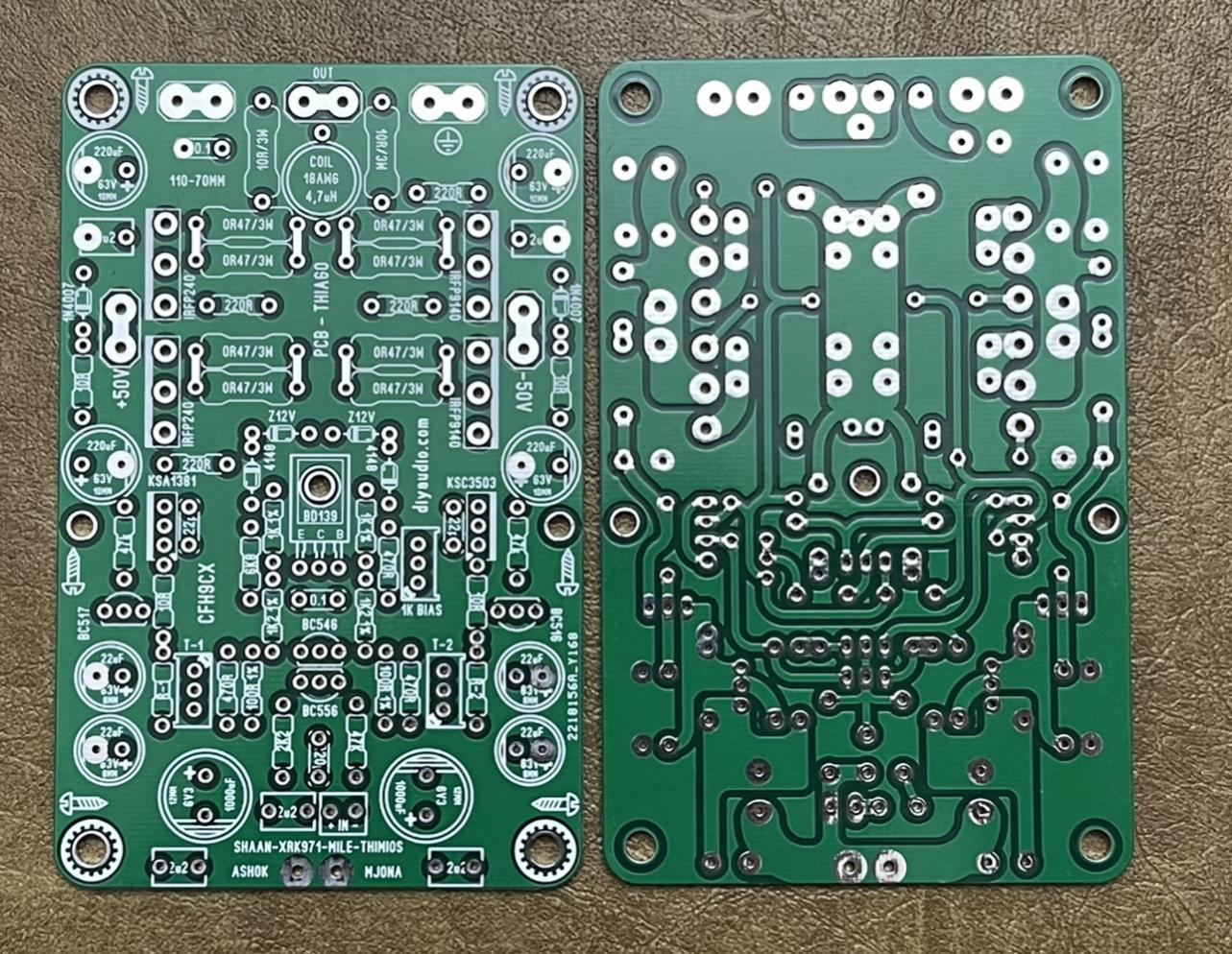

so i will attach the first version of THT variant include Gerber
see .zip
  • CDH11_V1_cplt.zip

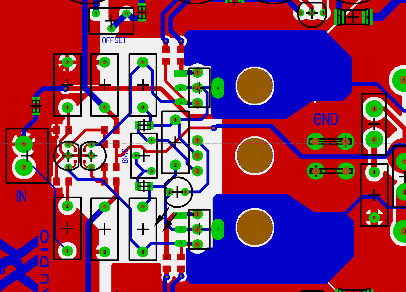

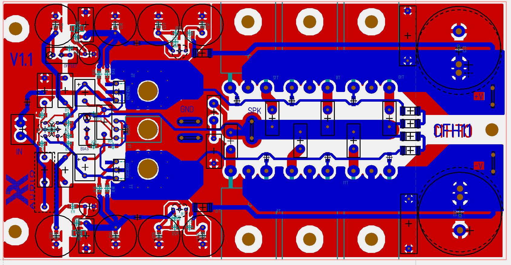

You can build the board with optional TH pads for those that want to try regular TO92 and TO126 actives. Doesn’t take up too much room as there is plenty of space on the PCB. One board for both. I would label components generically rather than actual value. That leaves the chance for adjustments or error corrections in BOM part values. I do like convenience is stuffing a part without looking at a schematic and spreadsheet though.
input is very easy :D
that is a very good idea
TO126 ... is a bit more complex
one idea is like the picture
but then i have to add a alu/cooper parts between drivers and heatsink
But then you can also use BCP56 instead of BD139

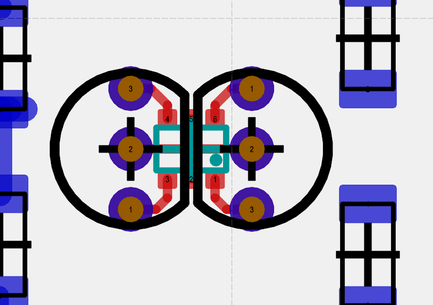

first impressions of dual layout
SOT223 pin"4" is output of driver to gates
but at the moment i doesn't have an idea how to place ...
i will change the LED to SMD .. but this is important for resistor values for bias
so i will find a good red led with nearly stable Vfwd

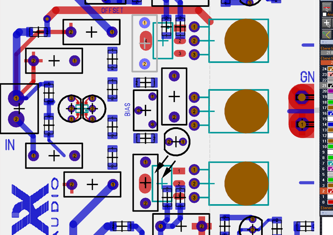

I think i will use a smaller Pad with vias
In bottom Side there ist GND plane.
And i won't use 4layer PCB 😁
I will Doublecheck footprints and searching for suitable parts
Including a list.. (digikey/mouser)
But then i will Order parts.
So i have Something to do between 26.12. and 31.12 😁
Speakers are waiting of an amplifier....
transfering .. yes . not so good as it is directly connected.
but in this way GND plane is only perforated ....
One negative Part of this is the capacity at the Gate drivers.
This Planes Creating a Cap.

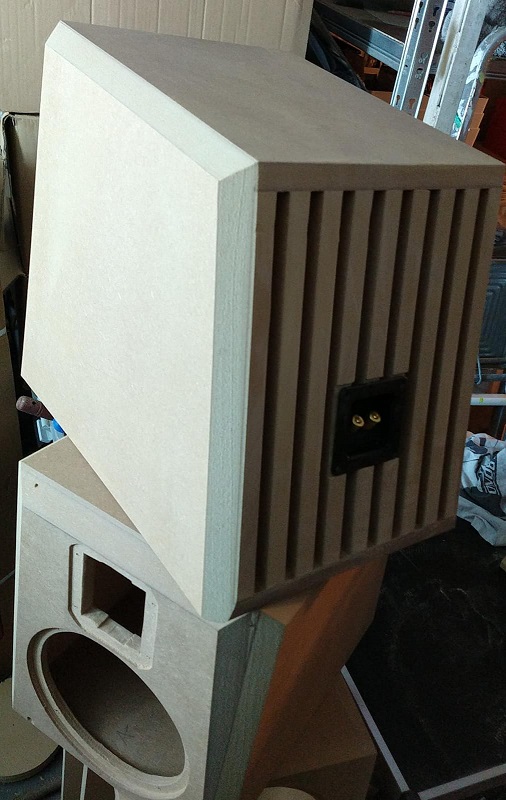

Speakers are
Fountek Neo CD3.5H
Visaton BG20 modified
In a damped Open baffle
Back part is open Like a large variovent
Eminence Legend BP102 in a 2.1m TML
Design ist my own .. or i doesn't know If somewere build this in this way ��
Actually i'm using a China TPA3255 to Power the speakers.

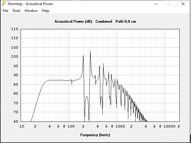

I like TLs a lot but never considered the BP102 for a driver. Do you have simulations of the TL design? I am curious what the bass extension is. Most pro audio woofers like Legend don’t go that low. Highly sensitive though.
I have RS225-8 in a TL at present and it sounds superb. Using ScanSpeak 10F for midrange and highs.

updated version with dual parts ... THT and SMD
i will order 5 PCBs :)
  • CFH11_1v2_combo.zip
