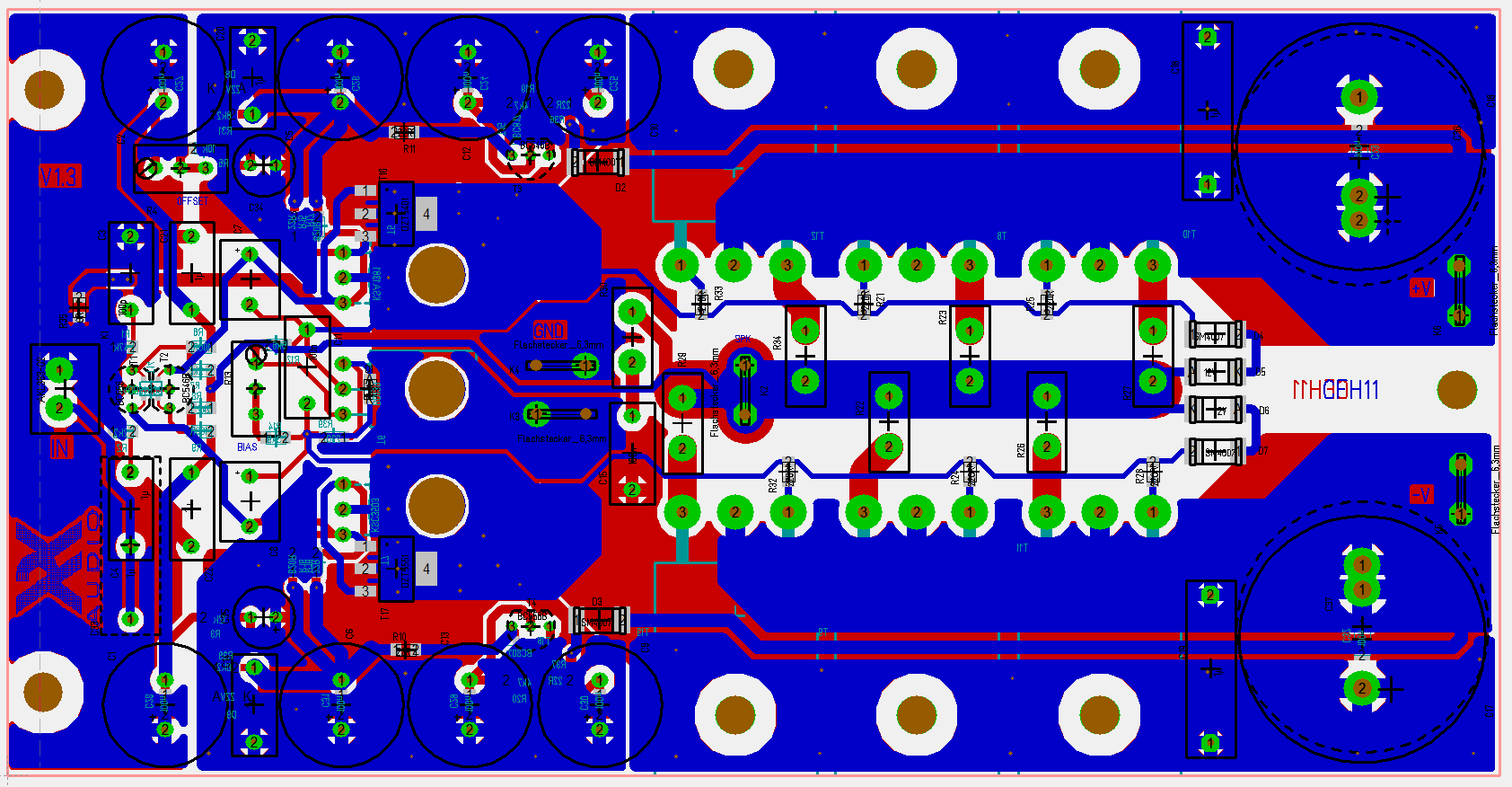

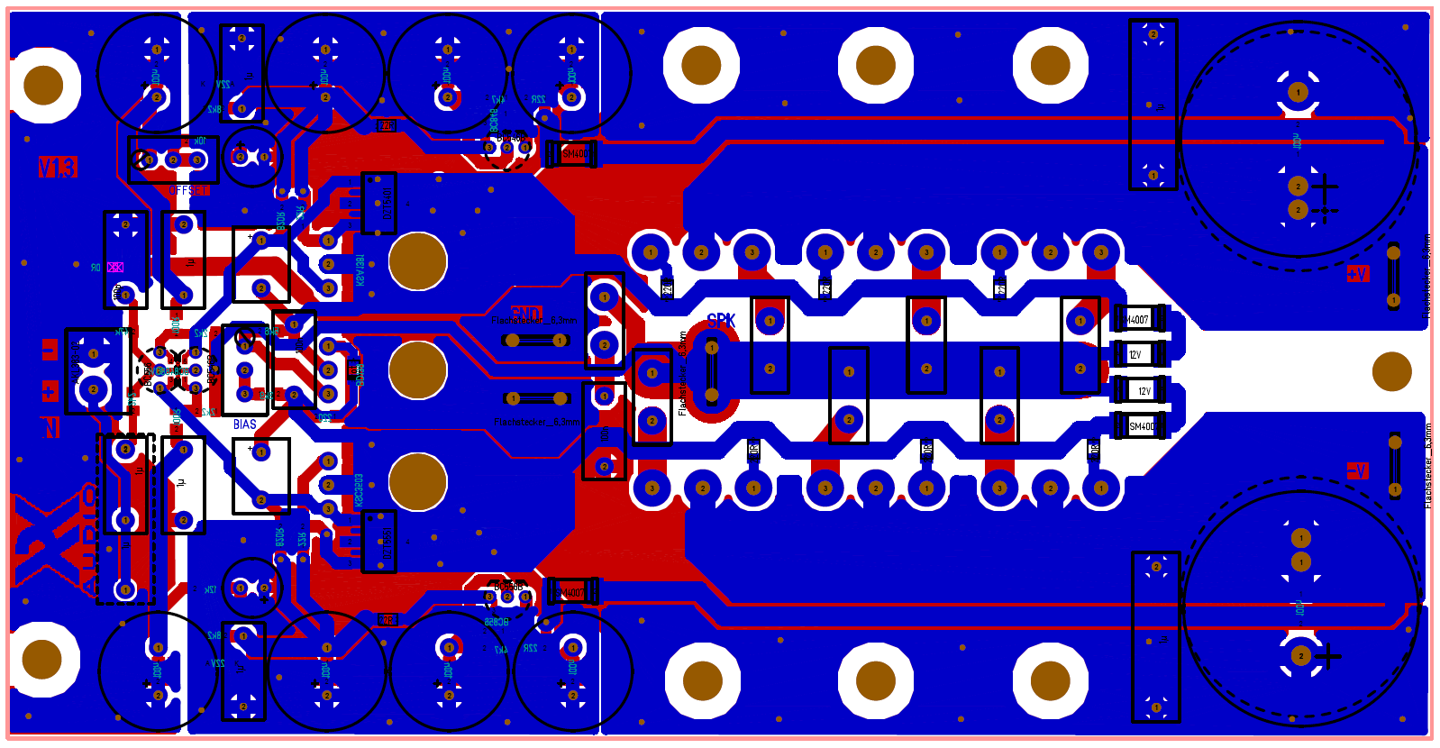

I haven’t checked your pin out on SOT223 vs TO126 on drivers but assume you have it right. I would make the common bus from drivers to each mosfet gate stopper resistors larger. It’s too skinny and could have a voltage drop between the three MOSFETs.
I would have made it same thickness as the connector between the two diodes on the same path. There’s no reason to be thrifty with the trace width as you have lots of room on the board.
A large Pad with very Low current can make some Problems
the larger area can absorb more interference than a smaller track
For small Signals it does not make sense to use large areas
But the track must be large enough to handle current and have Low resistance and inductance
For Gate Signals ... I will Check... I think 1,2-1,4mm is possible

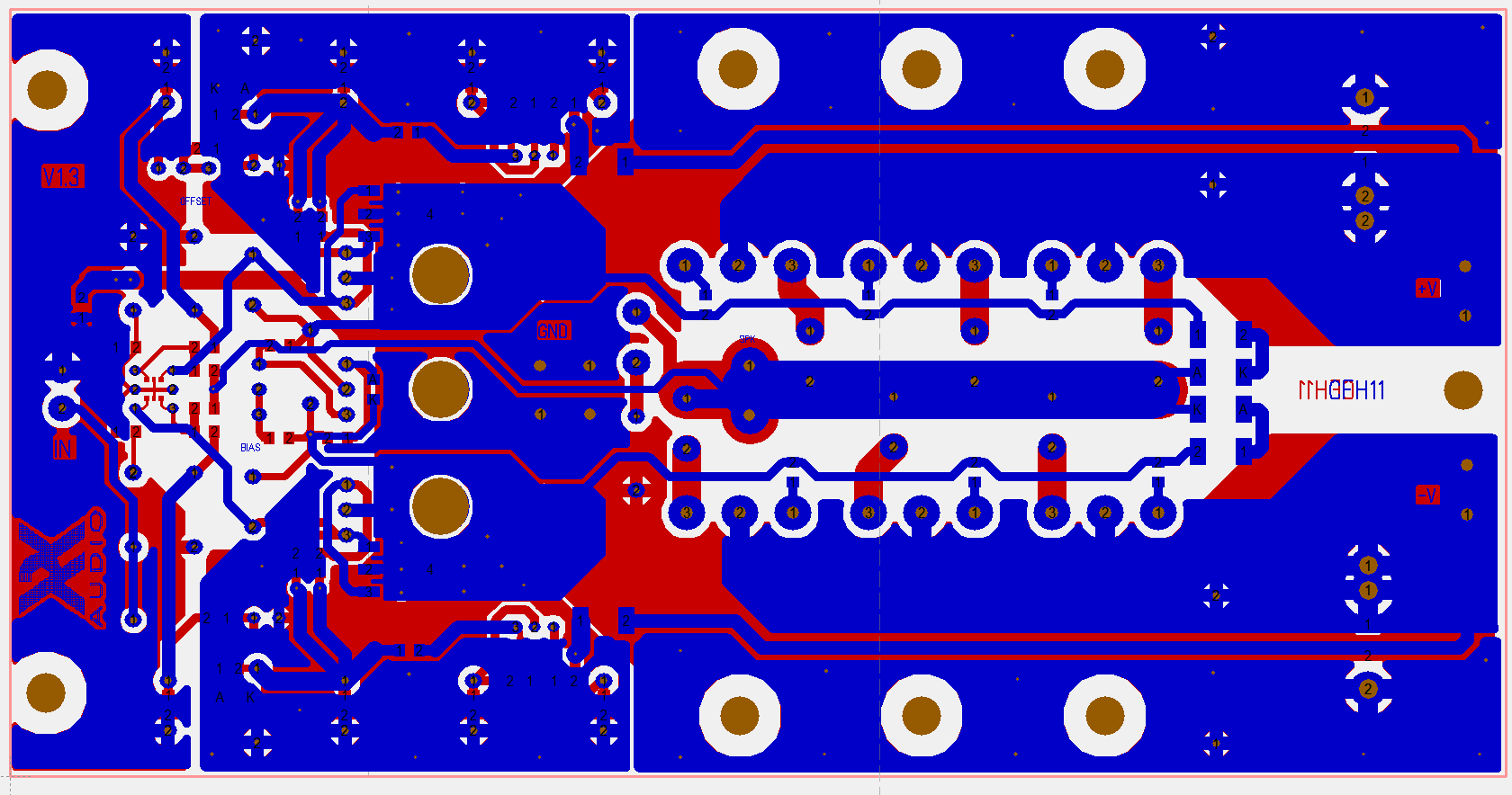

now with 1,8mm
and also VSA has larger traces

i checked footprints and it seems that all transistor are ok now.
if i have some time , i will upload a BOM ... so it is easier to collect all parts
and i will order 5PCBs too
actual values are designed for SMD version ...
i will upload a schematic for THT version

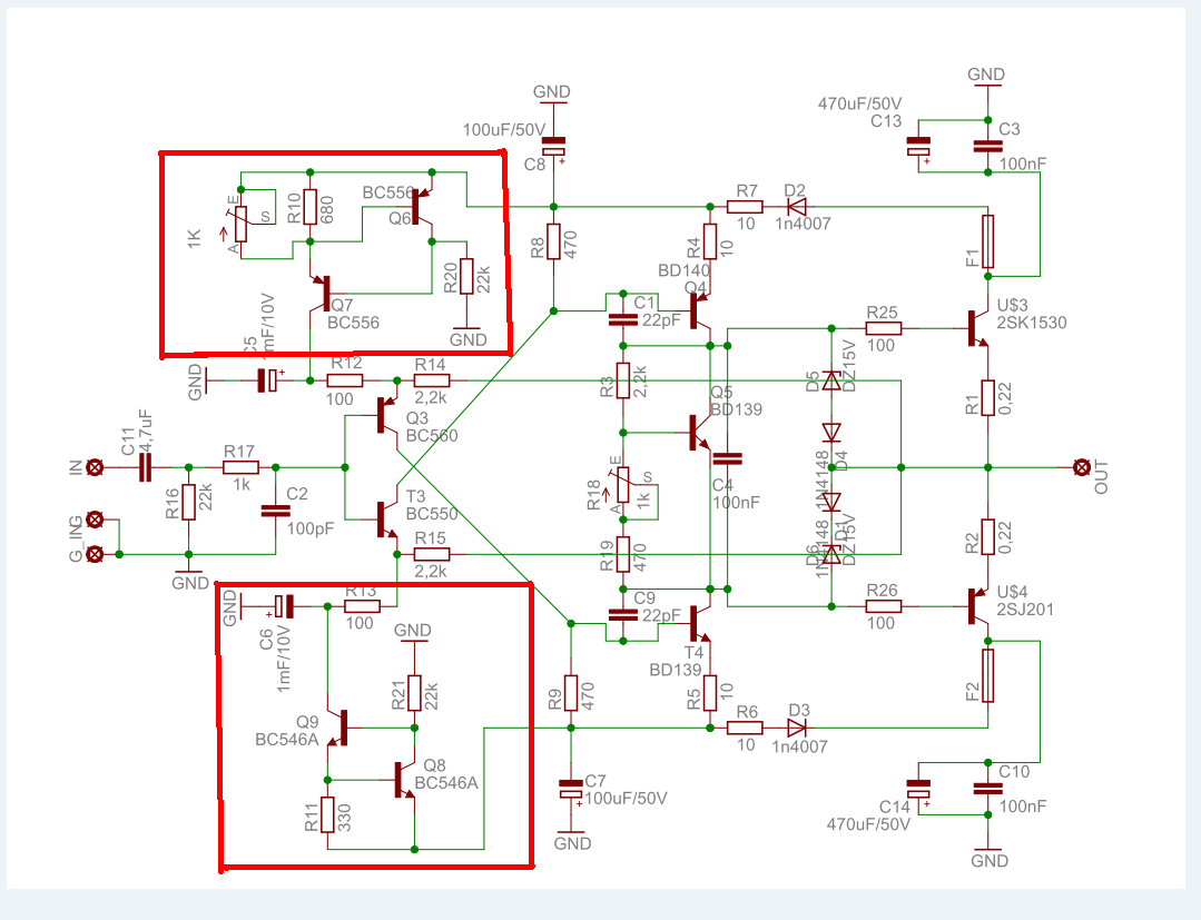

I have a question.. I see some improvement on the schematics but the same time the front end was simplifies? Is it not worthy to ad (to keep) the extra par small BJT at the front? Please see the picture in the red box. That was an improvement over the simplified front end. Reason I ask I see work on the PCB still in progress. This in one older version with Toshiba mosfets (uses same footprint as hexfets )
it works also like expected ^^
i did not see any THD improvements compared to resistor or zener variant
but it helps a lot to stabilize at different main voltages.
without this stabilisation the circruit works only at 50V
with your CCS or with zener ist works good from 40-55V
the drift without this stabilisation is very crazy
