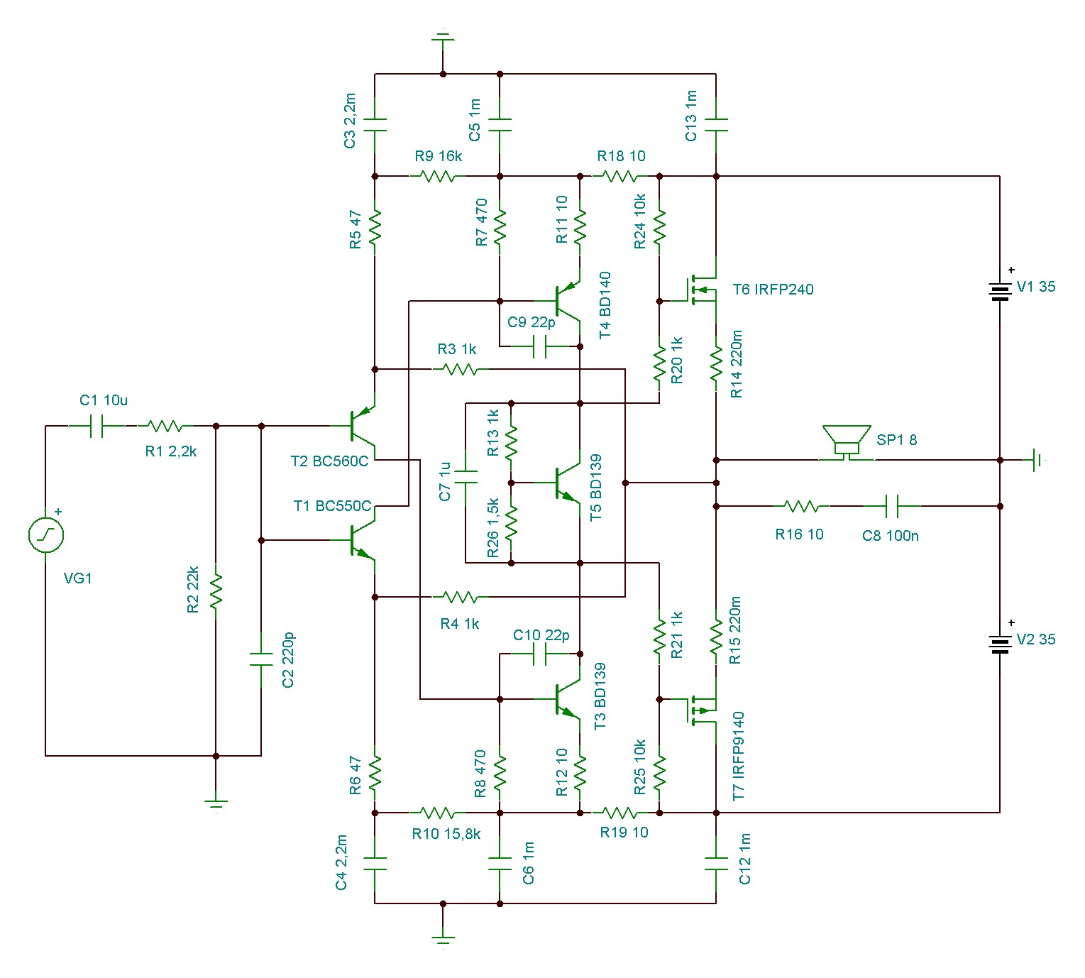

I made some simulations to change my CFH7 / VSSA, I still did not have time to put into practice due to the Christmas parties.
I decided to share if anyone else wants to try .... 2 new resistors were added between gate and drain and besides increasing the gate resistors I needed to change the VBE resistors.

why the bias with R24 and R25?
bias T5 for 6.5v
for vies SCHADE, leaving the mosfet with the character tube triode

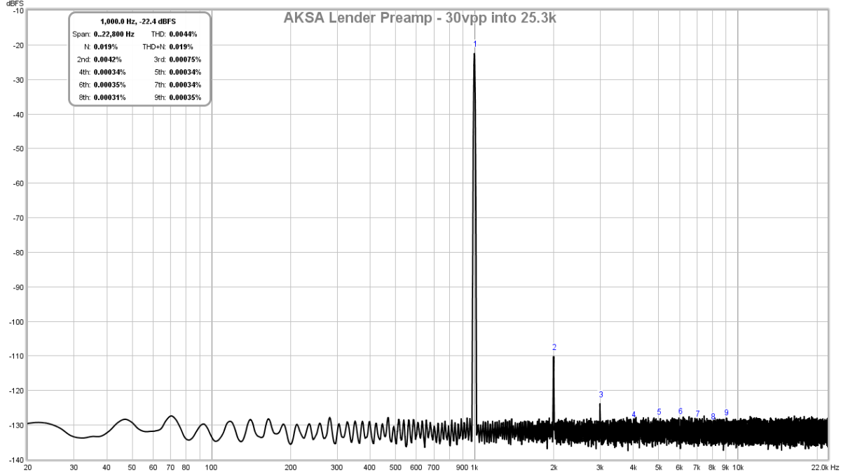

Thiago,
Perhaps you might like the harmonic profile of the Aksa Lender Preamp. Then use that to drive any output stage topology. Even the CFH7 juat strip off everything except output and vbe multiplier and connect Aksa Lender. It is low distortion and nice harmonic profile you like.
AKSA's Lender Preamp with 40Vpp Output
AKSA's Lender Preamp with 40Vpp Ouput GB
Here is the preamp driving 30vpp into 25kohm load (although still very similar even at 7kohm load):
Here is 20vpp into 7kohm load:

Hay diyers,
I just finished 4 Thiagomogi's boards from post #962,and again I have problem with no bias on all 4 boards. In past I was have a problem with one board ,and I was changing bias trimer from 1 kohm to 5 kohm and that do the trick. Now all 4 boards have 5 kohm bias trimer but I can not get any current on all 4 board. I double checked all values of elements and I can not find what is wrong.
Here are some voltage on BD139 transistors:
Board 1
Base - GND = 1.88V
Collector - GND =2.78V
Emitter - GND = 1.22V
Board 2
Base - GND = - 1.9V
Collector - GND = 1.13V
Emitter - GND = -3.0V
Board 3
Base - GND = 1.58V
Collector - GND = 2.73V
Emitter - GND = 1.58V
Board4
Base - GND = 2.7V
Collector - GND = 2.7V
Emitter - GND = 2.7V
All voltage are referred to GND ,no input signal,no output load,power supply is +-43V.
Any suggestion how to solve that problems?

Replace 6k8 with 12k in bias circuit.
apexaudio,
I replaced 6k8 resistor with 12k and still no change . Something other must be wrong
Regards
zoky2
Did you ever resolve the lack of bias issue?
