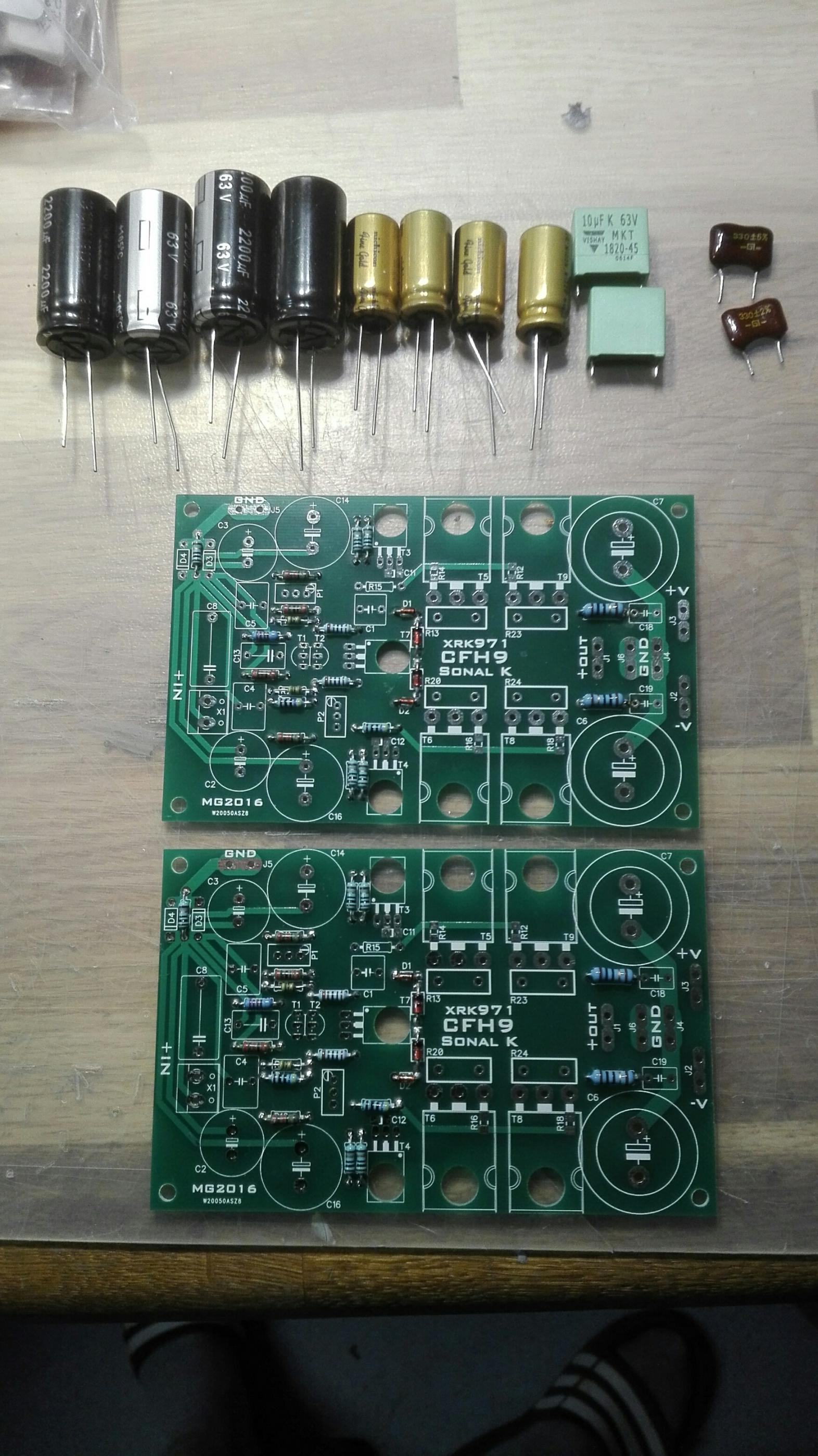

Yesterday evening i do some soldering job.....i need to order son missing parts
Marc
I begin to collect parts from my stock......I don't think i will need the an : each heatsink mesure 200x165x80mm. I have matched IRFP pairs, and hfe matched BC556/546 as KSA1381 KSC3503.
