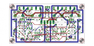

I have done a trial layout though, it's buildable on a 3x4 board, free Eagle's limit. It might fit on a 2x4 board, if I leave out stuff and use more SMD bottom side. These are paper designs, not tested, subject to change, but I'll share the current state of the schematic and board below.

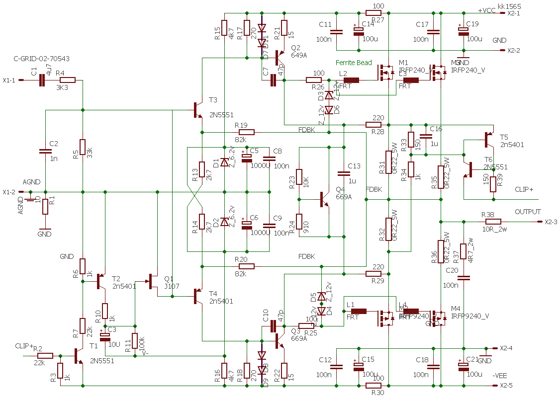

By the way I took out the op amp and made a smaller layout, 2x4. Schematic and layout below.

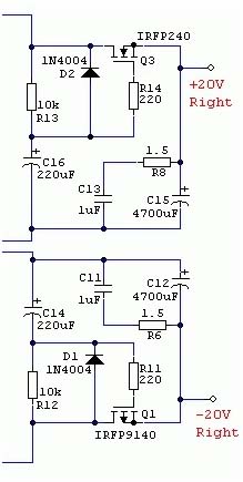

I looked at the Capacitor Multiplier. Yes, you could incorporate turn off into it, but it might not help. Here is a schematic of the existing CM. Clamp gate to source, DC off. That would not discharge the main supply caps though, so a lot of harm could be done by that energy. The switch needs to be downstream from the main caps to prevent that. Instead of a CM, use a regulator with shutdown after the main cap. Nothing is simple...

I did not understand a couple of things though. By shoot through current, do you mean cross conduction?
Sorry that "shoot through" confused you. Maybe cross conduction is the correct term. The current that passes from rail to rail when the two output devices both conduct when a signal frequency is too high to allow the devices to switch off sequentially.
Possibly due to input frequency too high, or Vbias not tracking, or?? Always a concern. I show fixed bias, but probably need a pot for tweaking.
And, what do you mean by "sensitivities for these are different by a factor of ~2"? I figured the original Cyrus had about a 7A trip, this was upped to about 10.5A in my implementation. Those were trial values, because I want to test this to see if it either nuisance triggers because the limit is low, or fails to trigger on harmful overcurrent.
The monitor reads the voltage across the two source/emitter resistor in series. The voltage drop across these resistors is divided by the ratio ladder. That reduced voltage has to be high enough to trigger the Thyristor. In your sch the values are :
0r22 twice
150r
1k
If 7A flows from top to bottom the Vdrop (=2*Vre) is 3.08Volts. The divided voltage is 3.08*150/(150+1k0) = 401.7mV and this is what triggers the Thyristor.
There is an effect due to the RC filter built into the measurement of that 7A current. A transient current will have to charge up that capacitor. This delays triggering. The RC = 1uF*(150r||1k) ~ 0.13ms
A very fast transient would need to rise very high to trigger. A slow transient would need to rise only a little higher to trigger. A long term DC would simply need to reach the trigger threshold. Have you done a sim in LTspice to see the effect of your filter?
Now consider what happens when AC current passes to output.
One Re passes current while the other Re passes zero output current. The second Re actually passes some current while the second output device is still conducting. And the second Re also passes the trigger current, when the other device is actually cut off. The currents in the two Re get a bit complicated for a ClassAB stage that has to transition from ClassA to ClassB as the waveform current follows the audio signal.
The divider is now 150r🙁1k0+0r22) and the single Re has to give the trigger voltage.
Suppose 14Apk passes through one Re to the output. Vdrop = 3.08Vpk
The trigger voltage at the divider is 150/(150+1k0+0r22) * 3.08 = 401.7mVpk. It takes double the current through one Re to reach the same trigger voltage as that created by the cross conduction current. That's the 2times sensitivity that I referred to.
I think your RC filter will delay fast transients so much that you may find that a short 30Apk transient does not trigger the thyristor.
Can you confirm how you worked out your chosen RC values and what different levels of protection it offers for different speeds of transients vs DC output currents?

Thanks for a careful analysis. I carefully designed the topology of the circuit, and only roughly figured the parts values based on a slight scaling up of the Mission design. Actually I figured a threshold voltage of 0.55v,, and trigger current of about 10A through both emitter resistors, or 20A through one. I used the same capacitor value as the Mission Cyrus, no thought went into that. That's rough, I know, but I thought to build it and test it to fine tune the values. In retrospect, I may change back to 7A limits, because I changed output devices from IRFP140/9140 to double IRFP240/9240.
I don't intend this circuit to prevent damage from cross conduction, but instead from user error, namely shorted speaker wires and input overload.
Regarding cross conduction, it is fatal. If you have it, it is a design error. You should not use a protection circuit to mask a design error. Fix the error.
I do two things to try to avoid it. I filter steep rise times at the input, and I design the drivers to prevent cross conduction. My input filter has a lower cutoff than typical, by about a factor of 3. This passive filter is outside the feedback loop, which is necessary for amp stability anyway, but I was conscious of the need to limit rise times too.
Avoiding cross conduction means careful design of the drivers, in particular that means very strong turn off drive for the gates. Typically the driver is a follower, so turn off drive is a resistive pull down, not active. That's a potential problem, so I use the smallest resistor that is practical. In the present design, I want to reduce it to 100 ohms, which means switching drivers to a higher wattage part.
My preferred driver is much stronger, but in keeping with the minimalist design of the current feedback topology, I did not use it here. I post an example of a better driver below. [Caution, this is a paper design, exploring topology but not deep analysis of parts values, so this would need a once over before committing to building. I go fast when I am playing with a concept, and there may be errors I missed too.] I post this to show the better driver. There are many other differences from the topic of this thread. You will note that this has VI limiting. Also, the output stage has gain in order to allow rail to rail output. With complex loads, output stages with gain have problems. The infamous Tiger amps from the 70s used output stages with gain and suffered random failures, but I don't know the causes. You would want to overkill on the Zobel network to isolate reactive loads from this amp, and that concerns me. So, again, this is a paper design for discussion only.

Could I take the functional aspects of the protection circuit here up to the clamp JFET and connect that to the gate of my CM?
Maybe. I did a quick runup of a design. However, I made it a switch only, no multiplier nor regulator. Why?
I feel the amp should be able to reject power supply hum and noise and regulated power is unnecessary. We make it so, by using effective circuit features in the amp, like RC filters on front end stages, differential inputs, current sources for differential pairs, and the like. A good regulated supply adds 30% to cost and wastes 30% of your power as heat, while reducing reliability. I don't feel that cost is justified if it is not necessary because the amp is already noise resistant. Your mileage may vary.
Once you have a MOSFET switch like this, you could easily make a regulator. Again, I chose not to do that.
