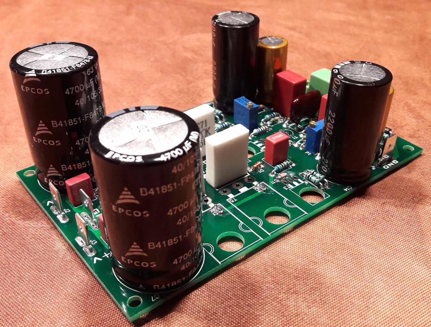

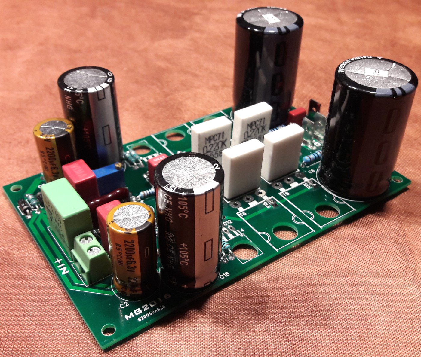

Looks really good Marc. It's no surprise all your parts fit the designated locations perfectly. What kind of caps are you using as 10uF film? I wonder if I can improve SQ with switch from ceramic to film at that location?
I'm getting a little concerned the remainder GB boards still have not arrived yet. Please let me know of you have any news.
They are Wima polyester caps MKS-2 / Ref : MKS2B051001N00JO00
Marc

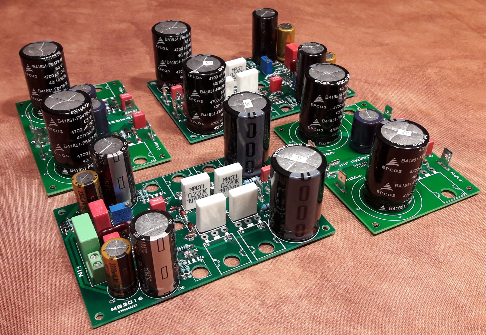

How is the build coming along? First sound yet?
That's a nice looking (and sounding) combo!
That is a very nice set!!!🙂
