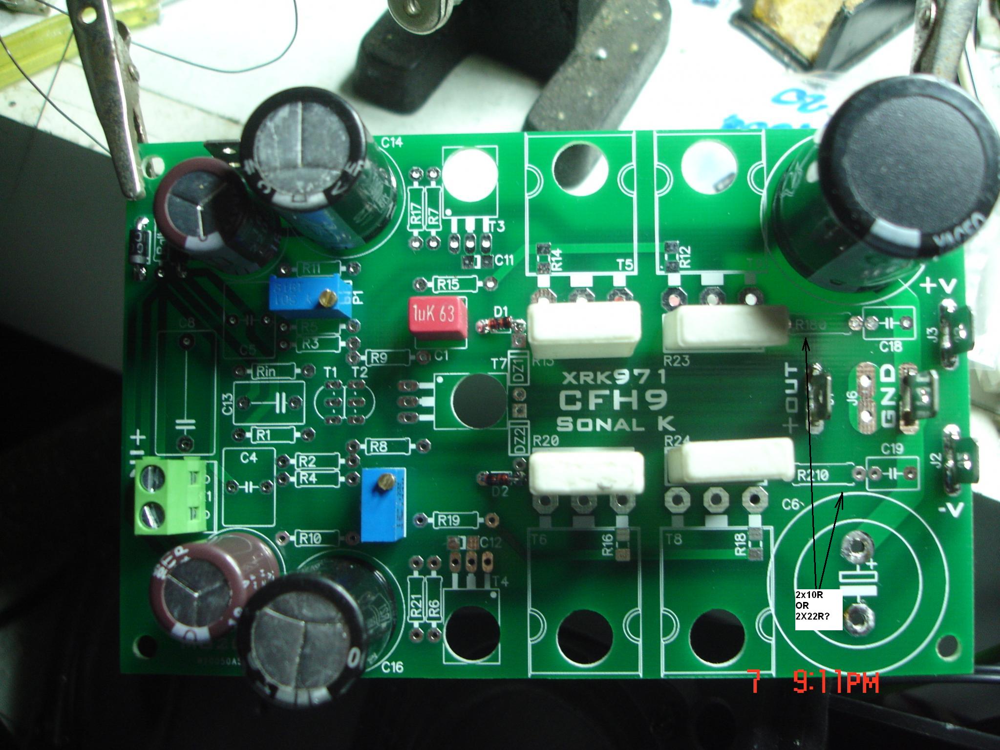

Late at the party.
Here is what the postman delivered today morning🙂
Thanks X🙂🙂🙂🙂
The other photo is what i have this afternoon.
Several pieces missing and others have similar values🙄

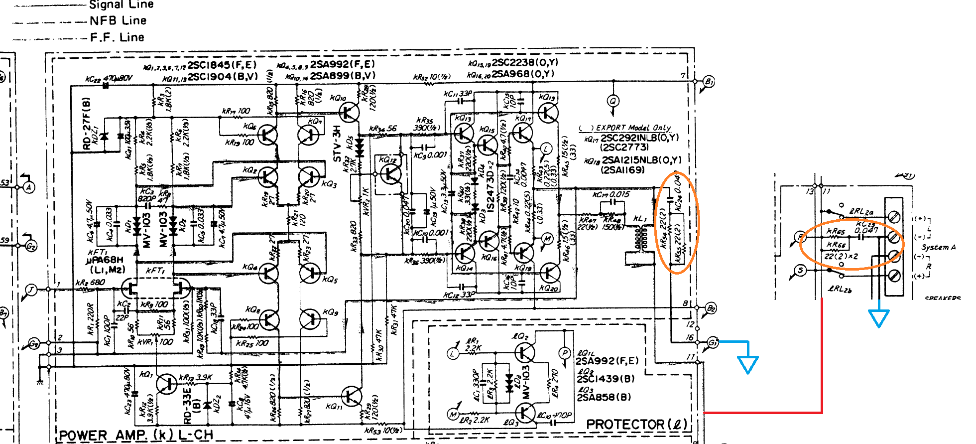

and fit another across the chassis mounted speaker terminals.
I just watched the R.Cordell presentation from the 2016 BA conference.
His sch for the modified DH220 shows the Pi filter with the second Zobel at the speaker terminals. I must have read too much of his interviews series.

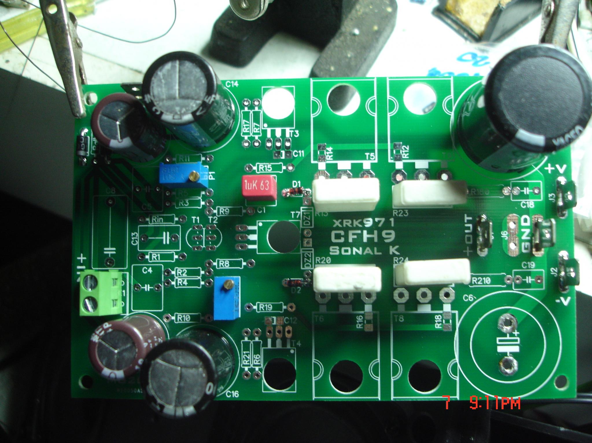

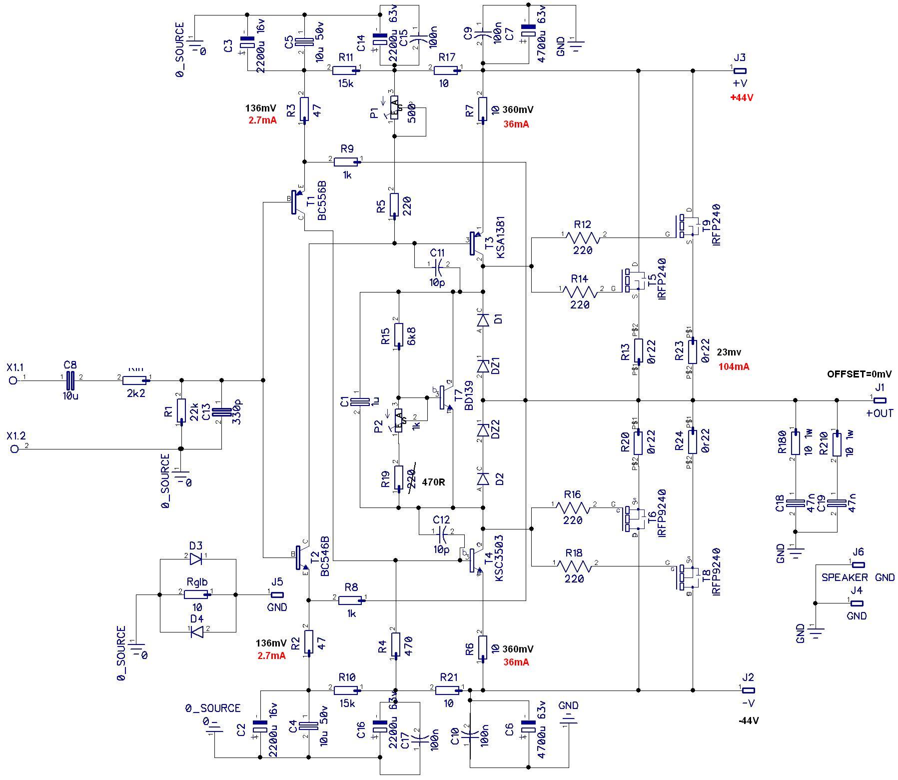

Hello xrk971! Great going with CFH7 and 9! :up:
I was wondering why there is no capacitor in parallel with the 10R + 2diodes network in the second ground on the input side. Is it SMD and mounted under-board?
Thanks!
The secondary ground layouts I have seen generally have not had a cap. There are hidden SMT caps but for bypass the big elco's. Maybe Idefixes can comment as he did layout. My initial schematic does not have it.
