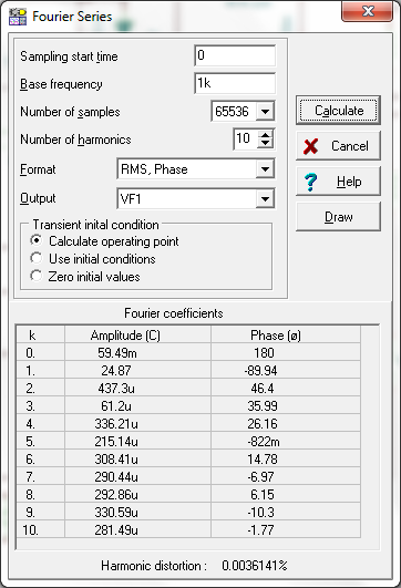

I have a question for you - given that I am using a MOSFET to throttle the DC rails upstream of the amp, can that be used as a DC protect solid state relay and is there an easy and clever way to implement? I am thinking a couple small signal TO-220's to detect DC and maybe a low Rdson FET to clamp the IRFP240/9240 gate to ground? Almost like a 21st century protect but upstream.
Hmm, 0.005% simmed and suspecting amp performance similar to simmed?🙄
Dont see H2, H3, H4...on sim ? need to do careful sim, you could use LT spice with good models from Cordell and keantoken and others😉..
Hint, OS's models are quite close to reality, as he had said in some thread, if memory serves right.
Just a constructive suggestion🙂.

The sim had all the H2, H3, etc I am saying I don't have an analyzer to check in reality. I think models for KSA/KSC were from Cordell but model for IRFP's were straight from the included library for Tina. Sim actually says THD is 0.0036%, I said 0.005% for margin.
This is with 145mA bias current ea.
Aha... now its clear!....The sim had all the H2, H3, etc I am saying I don't have an analyzer to check in reality. I think models for KSA/KSC were from Cordell but model for IRFP's were straight from the included library for Tina. Sim actually says THD is 0.0036%, I said 0.005% for margin.
if my read of designers' experiences here is accurate, sim and its margin dont agree with reality, unless its proven otherwise🙄.
anyway, nice work🙂!, sure will be watching progress of the thread.
