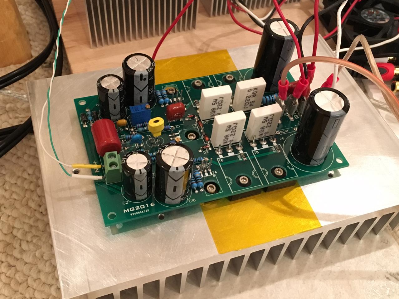

Solidly mounted to heatsink now. Offset is stable to 5mV after warmed up. Bias is stable and set currently at 150mA. Heatsink is not too warm at all. Sounds really nice. Super easy to make and parts are not expensive at all. Great amp. Nice deep bass, smooth mids and clear highs.
Note that bias current is monitored via output and Source pin sticking up from one of the MOSFETs. Be careful not to short the pins with the alligator clip.

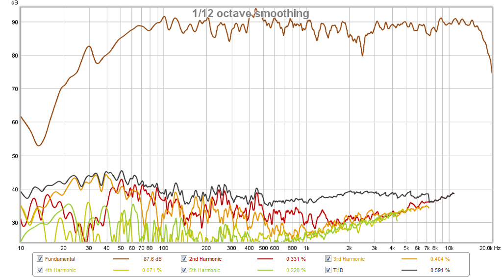

More testign today - DC offset is excellent - only 3mV drift today when turned on and warmed up.
Love the sound. Quick measurement with my 10F/RS225 FAST speaker shows no abnormal distortions - very clean.

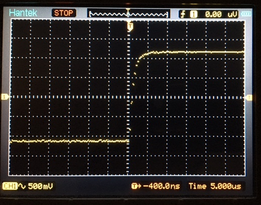

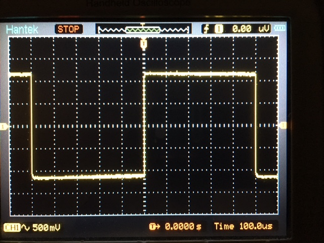

I was able to borrow a friend's Hantek DSO 1200 scope.
The 1kHz square wave looks good. I didn't have any 10pF NP0 SMT caps so am using 22pF, and so the edge might even be sharper. Right now 1/e risetime is about 1.5usec - still not bad. Very clean, no ringing or overshoot. I used the 1kHz test signal from the oscope through a 10:1 voltage divider to generate the square wave. I don't have a function generator. Load is an 8R 25w resistor.
1kHz signal measured across load resistor:
zoomed in:

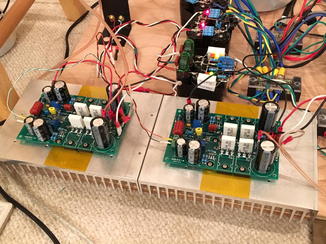

I am pretty sure all the folks in the GB are going to like this amp. Performs very well. I just mounted the second channel on heatsink and tested it - fired right up no issues.
