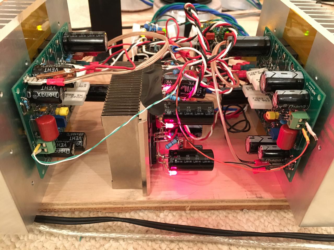

I finished my Juma Easy Peasy cap multiplier for stereo and am using it with a 300VA 28VAC trafo which makes 44VDC upstream of the cap multiplier. The cap multiplier loses 5v but ripple as measured with DMM in power supply is now very low, somewhere around less than 1mV. I am running 460mA total bias current (measured with clamp current meter). It feels pretty toasty - almost class A like. I guess it is dissipating about 36w at idle.
Here is the cap multiplier:
So, what does it sound like? Very very nice. Great powerful bass transients, deep reach. Excellent smooth mids and sparkling and clear highs. No issues. The extra voltage really made the amp come alive. I really like it - it is probably one of my top 3 amps now.

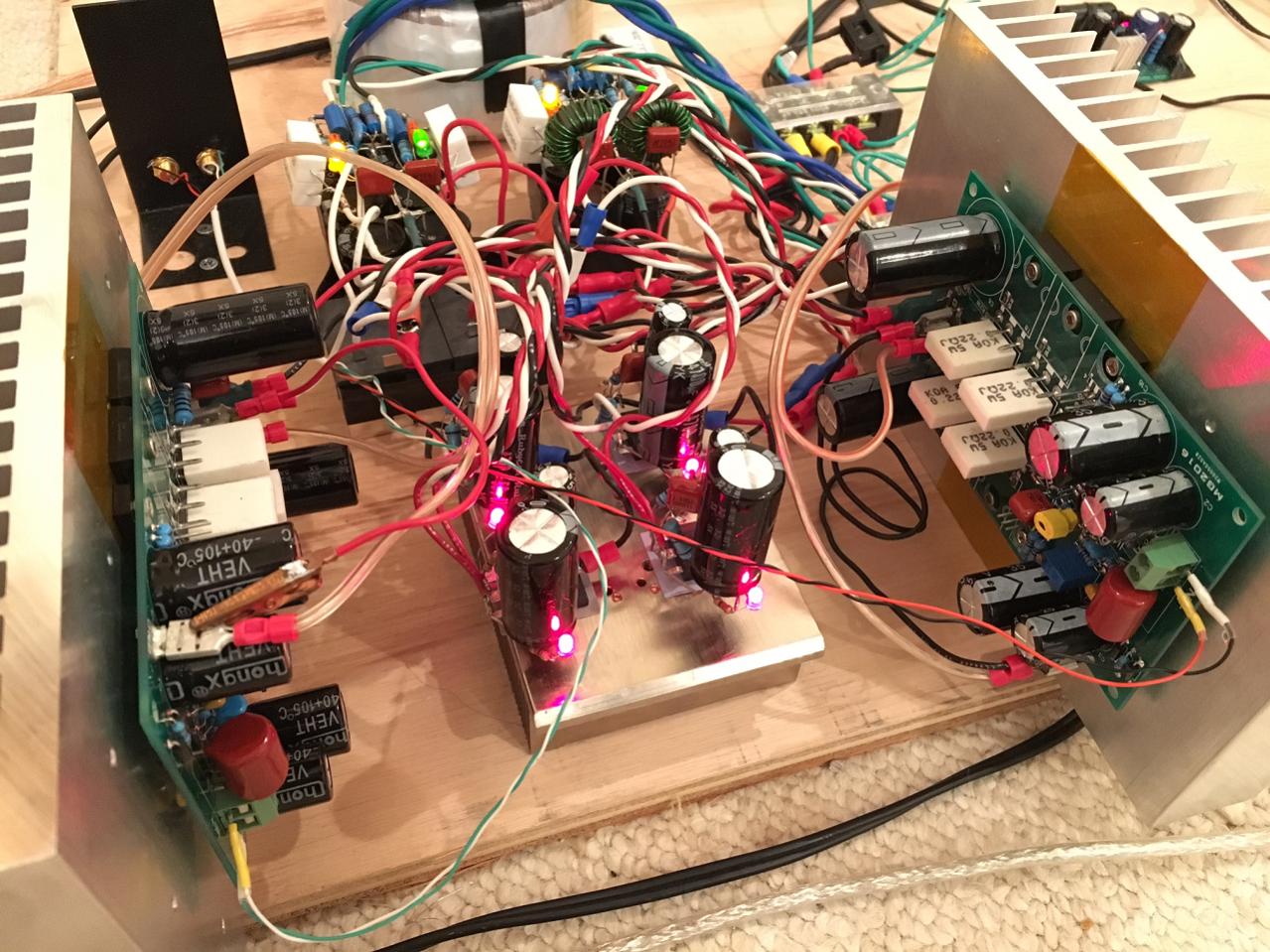

Here is the amp with cap multiplier and bigger 300VA trafo.

I am guessing it's about 40C to 50C (touch hand for 12 to 20 Sec) when running 460mA bias. Size of heatsink is ideal I think. It's 5in tall x 7.28in wide. Here is model.

You could run at lower bias and less heat this is high I think. Semi class A?

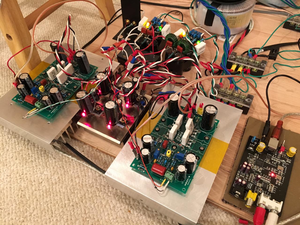

Update on CFH9
This amp as currently configured is really excellent. I measured the DC offset after warming up today and it is 0mV to 1mV. Bias current is still about the same and stable at 465mA. Here is a photo of the amps flat for visibility and then up in vertical config how they would be mounted if inside a cabinet. The cap multiplier also gets warm but not hot so I rotated it for air flow.
I was listening to a track by Gretchen Parlato that I am very familiar with and heard new details today: the breath she takes in between phrases is now audible whereas before it was not as clear. Nice amp. 🙂
