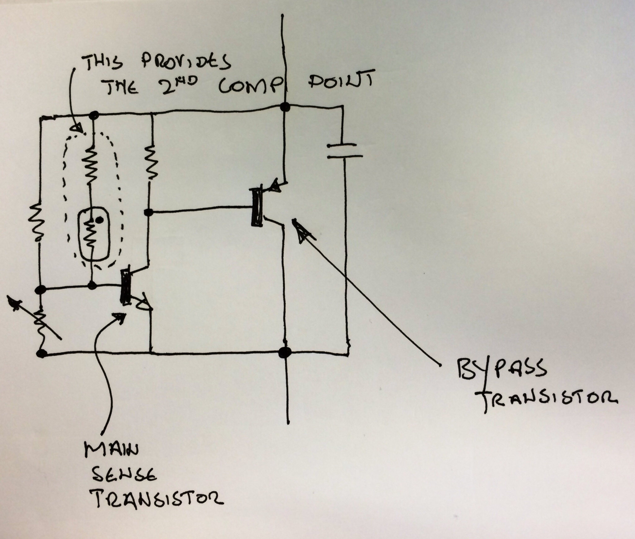

Hmmm. how well one can keep the BJT OPS bias always locked on the thd null point will be an important design parameter. I havent appreciated this enough before.
I see now there has been quite a lot of work in this area. However, not much has filtered down to a lot of the makes and models, it seems. I dont have my reference books avail to me at this time... but I did read Bonsai's paper on the dual-point thermal compensation and am wondering if there is a easy way to add a part or two to the stock 1-2 transistor bias spreader circuit which will change it to more like a dual point comp bias circuit... quasi? Any suggested circuits/mods ideas for DIY'er?
THx-RNMarsh
Here is how to do it with a resitor and an NTC.
The main sense transistor provides the ambient cal point, and the NTC the second cal point.
In the article you read Richard, I looked at using a low power op-amp, and in a derivation of that circuit, a TL431LV.
The technique below works just as well and is simpler.
Andrew, presumably this is what's described in your #6290 post.
It looks elegantly simple .. which is of course, the highest praise I can give. 🙂
But what is in Thermal Contact with what?
Are both the NTC & "MAIN SENSE TRANSISTOR" on the Heatsink? What about "BYPASS TRANSISTOR" ?
Richard,
The sense transistor is located next to the emitter lead of one of the output transistors. I use a BC847C.
The NTD is located next to the emitter lead of one of the other output transistors - coupled with a small amount of thermal grease.
The pass transistor is a free standing TO-126 (I could actually have used a TO-92 - but I used a TO-126).
The idea of two point (or multiple point) thermal comp is to make the thermal comp curve as flat as possible so it tracks the ideal bias temperature more accruately. This way the delta between the actual bias current and the ideal bias current is smaller and the system then get to equilibrium more quickly. Most single point thermal comp schemes look for a best fit and use a single cal point.
Note that we are taking a classic bias spreader and just helping it to perform a bit better by calibrating it so it intersects the ideal bias current in two places by design. Good thermal design then completes the job.

Thanks for this Andrew.
In da 80's, I did this type of thing with a Spreadsheet. The spur was finding that CFP o/ps had really critical bias leading to nasty xover immediately after a burst of power.
When Self's book appeared, I revisited the subject but by then it was mainly academic as we were no longer making commercial amps.
I think Self's is a better treatement of 'Thermal Design' though Cordell is better for Thermal Gain. Self also favours some schemes which are wonky if the amp is cooked for a bit.
It's possible to design simple single transistor bias for EF2 with sorta '2 point' Thermal Comp by twiddling Thermal Gain but your method is a clever & useful addition to our toolbag.

Thank you, good observations, and good information.
You state thermally coupling to emitter leads.
Emitter leads are thermally coupled to the die via emitter lead wire and encapsulation.
In my experience/understanding for power output transistors, the transistor die is directly mounted to the collector heatsink connection/substrate, and therefore provides the lowest thermal impedance/fastest thermal connection to the actual transistor die.
Is there a particular reason that you specify thermal connection to the emitter lead/leads ?.
Dan.
