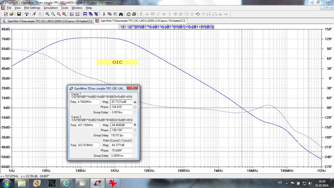

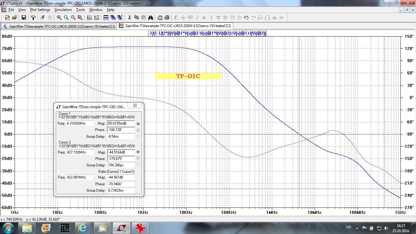

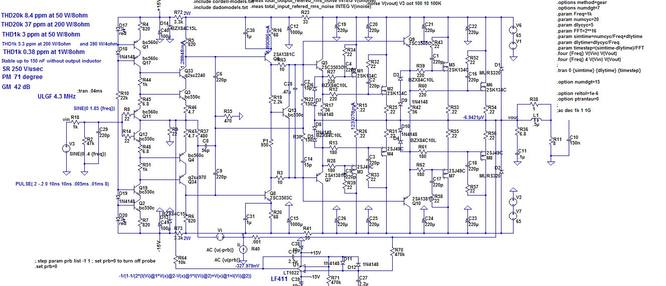

Hi Bob,
I used OIC in my CFA MOSFET power amps and all simulation show quite good stability with very good PM and even better GM.
I used a kind of two pole OIC as it shows better open loop bandwidth, TMC did not behaved so good. Here is the schematic and two cases of the Loop Gain plots, as two pole OIC and pure OIC(R35 to the ground removed). I tried this approach with the VFA but it showed tendency to instability.
I would appreciate your opinion, the one I asked from D. Self was not in a favor.
Regards Damir
