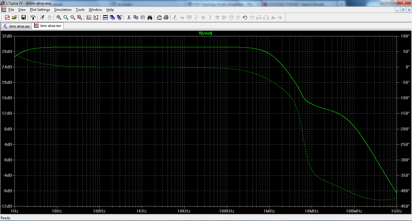

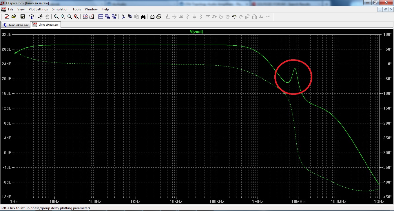

I sim simple amp with double emitter follower output. First picture, I use 100 Ohm for Rb on driver and 10 Ohm for Rb on final. Second picture, I use 22 Ohm for Rb on driver and 2.2 Ohm for Rb on final.
Less Rb, less distortion but sometime I get peaky frequency response.
You have some other problem Bimo. Might be the 100 ohm is introducing a pole. You can't put plots up like this without including some detail unfortunately.
It is not about CFA, but simple VFA. If you don't mind, I can upload the sim file.
