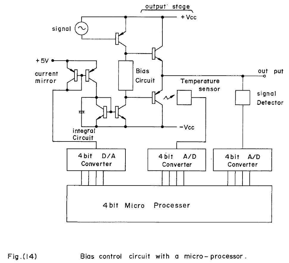

Managed BIAS?
Hi All,
What do you think about the "managed" approach to BIAS regulation?

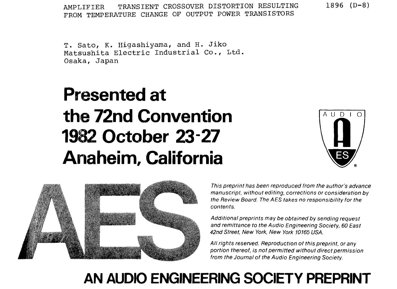

I attach a principal diagram and a title page of the paper where it was published (1986).
Looks like a good approach to me. Thinking about prototyping. Of course, it will be based on a modern controller, having ADCs/DACs embeded. One chip can handle 2 channels independently.
Main advantage - we control the BIAS not only based on temperature, but also on the output signal level, minimizing effects, like temporary BIAS drop below optimum after high signal disappears.
It will require some research and experiments, but looks attractive.
Does it make sense to you?
Valery

Hi All,
Valery
You can get MCU's now that will run on 2.7 volts. A good candidate would be an NXP LPC810. I have toyed with this and would approach things a bit differently from the paper you show ( which goes back a few years!)
Use a standard CFP bias spreader
Use the controller to augment the standard bias accuracy.
To do this, you measure the bias current as the amplifier is warmed up, recording a correction value in memory.
Since it's only 2 nd order correction, 3 bits will probable be enough - so just use the MCU I/O lines. For temp measurement, use a diode.
Since there's loads of memory available, the whole thing can be made self calibrating.
Andrew, thanks for the ideas. I have actually got a lot of very good experience with Atmel's ATmega328 (use them a lot at my primary job as well as in my DIY designs). It works at as low as 1.8V power supply and has got up to 8 true analog inputs (and some PWM outputs). So, I'll try this one.
Regarding the regulation mechanism itself, I think, some opto-device will be a good solution. I will control the LED, so the coupled diode (or transistor) will adjust the BIAS...
