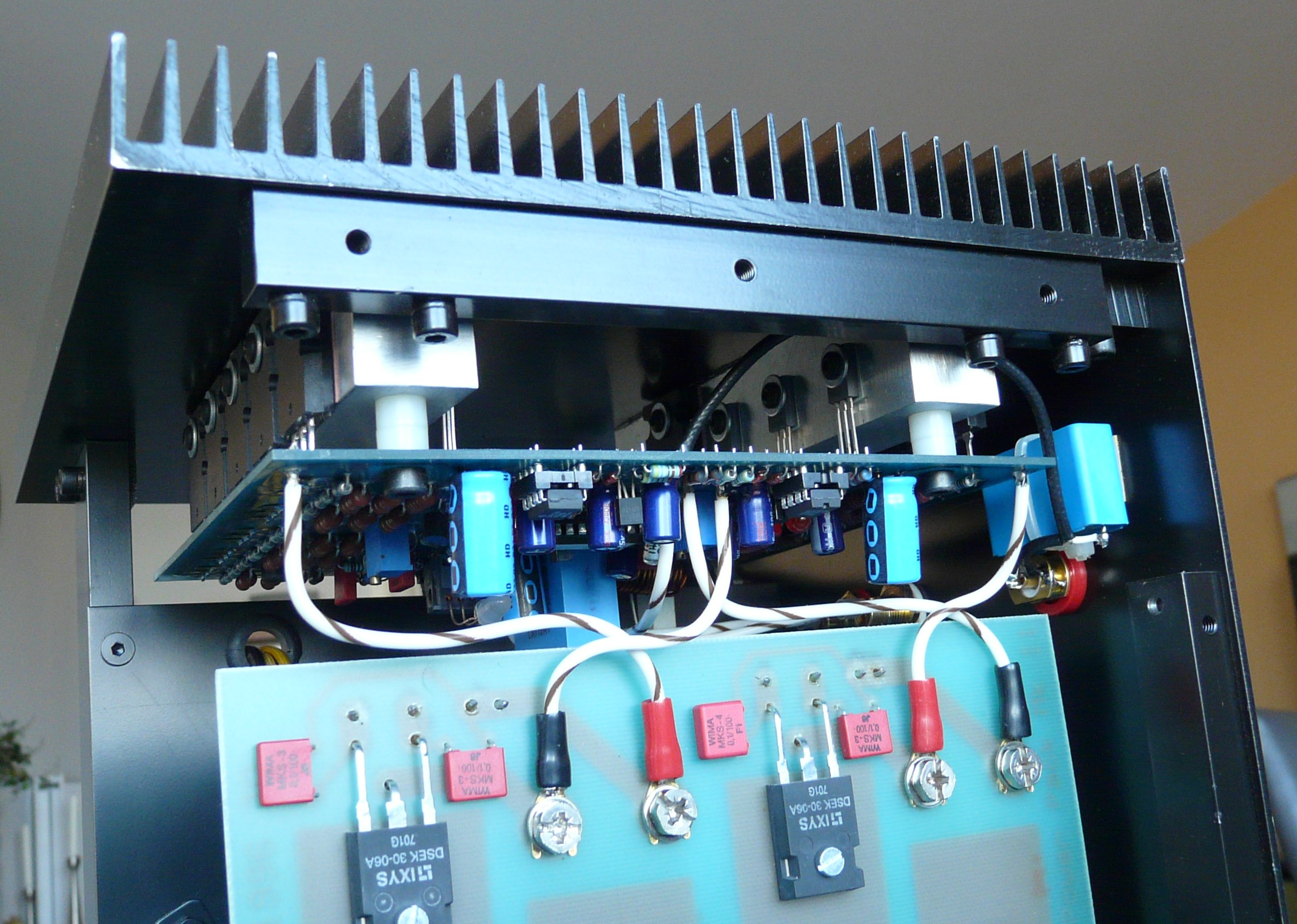

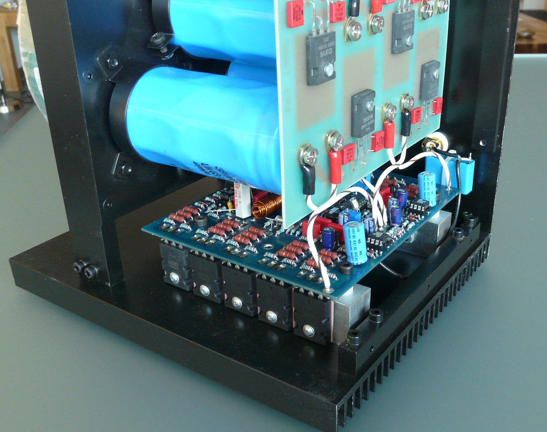

I've experimenting with a sort of 3D-power amp module, with the aim to a) put everything in the output stage on the heatsink, and b) make all connections including to the power supply very short but still away from sensitive circuit parts.
One implementation shown in the pictures - you can see that the (pre) drivers are on the inside of the aluminum bars. The power supply connections are short and orthogonal to the board.
As Bob noted, putting (pre)drivers on the main heat sinks can be too much for thermal stability, so I now would do it different, placing the (pre)drivers on the PCB with their own small heatsink.
However such a module approach is very good electrically, with very little crosstalk and almost no supply induced distortion. Also for servicing you can just replace a complete module very easily and quickly.

I did it a bit differently, pre-drivers are small and dissipate little and no heathsink, drivers and be multiplier transistor are on separate small heathsink, and only output transistors are on the main heathsink and off course TT diodes assisting Vbe multiplier.
For thermal comp, I use a two transistor CFP. The sense transistor is a SOT23 device, thermally coupled to one of the OPS collected leads, and both driver and pre drivers are on the same heatsink. I then use a NTC to provide a second compensation point.

Nice looking build Jan!
Hello Dadod,
I like your amplifier build, but I would like to say that it is good to use fusible or non flammable resistors on the output stage as it prevents board damage with an output stage failure . They look like carbon on the bases on the output devices I would use fusible types , I m not sure what RE (0.22R ) types you are using but I would use metal oxide types there if you are not already.
Thank you PHEONIX,
I don't have any kind of protection on that board as I use a power regulator with all protection needed, look here, schematics in pdf http://www.diyaudio.com/forums/solid-state/182554-thermaltrak-tmc-amp-10.html#post3031504. After prolong use of that amp I follow that route for all my new amps.
I use Re of 0.16R made from parallel metal oxide types resistors. That board was not fully assembled yet, some components are missing as some Re.

Very nice and clean built, only problem I see here is servicing.

3D approach is great! Something I'd like to experiment with...
My experience with placing the pre-drivers separately, showed that (though they operate at relatively low power and do not heat too much) it is important to attach small individual heatsinks to them - this significantly increases overall thermal stability. Exactly as you plan to do. Much less OPS quiescent current fluctuations.
Valery
Servicing is VERY easy - loose 4 bolts, disconnect wires and replace whole module.
Jan
My experiments with placing the pre-drivers separately, showed that (though they operate at relatively low power and do not heat too much) it is important to attach small individual heatsinks to them - this significantly increases overall thermal stability. Exactly as you plan to do. Much less OPS quiescent current fluctuations.
Valery
Indeed, you often don't really need the (pre)driver heatsinks to cool them but more to keep them isothermal and straighthen out short-term variations.
