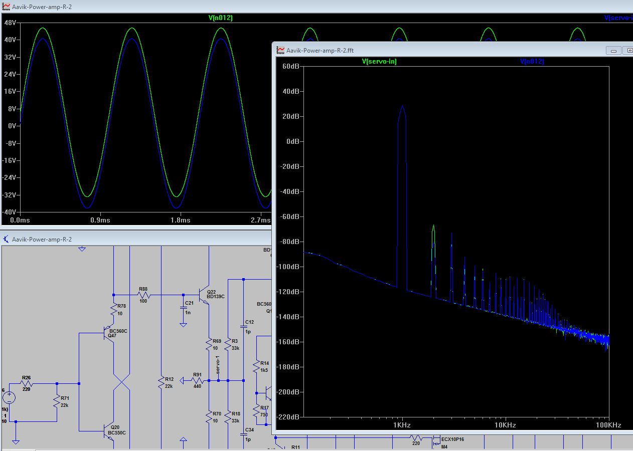

MCD99Uk, My gain setting feedback is from the VAS, I take the feedback right after the Hawksford-cascode, where I build at bridge with two resistors, there the signal is current. with full swing +/-56V I use less than 1mA for the feedback network compared to the 12mA I pull through the VAS/driverstage. this loading is pure resistive.
The picture shows two FFT's one from the VAS and on from the output of the amplifier. As seen on the picture the OPS adds some 2. Harmonic, where as the 3 and higher order are primarily generated in the IPS/VAS structures of the amplifier.

Could always use "split" feedback points where at low frequencies the OPS can be included in the GFB loop and at high frequencies the feedback point could be taken from the VAS.
One potential problem I can see is the loading on the VAS caused by the feedback network at high frequencies.
That's basically what TMC does. At lower freqs, the OPS is in the GNFL, and at HF, the loop transfers to just around the VAS or driver stages.
With TMC you get about a 5x reduction in distortion across the audio band as a result. See Edmond Stuart s posts for a definitive explanation.

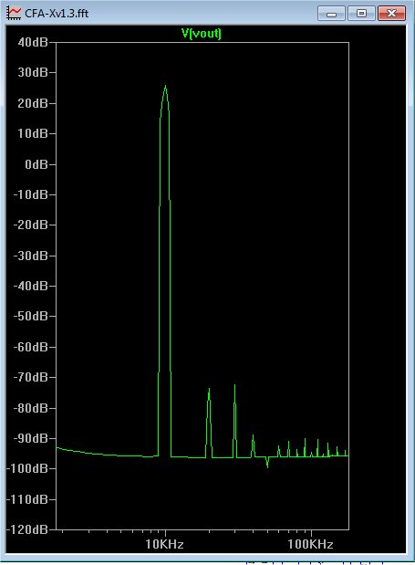

"Super KISS" seems to beat "Miibtech" 😀
I get <.0018% (.0015) @10k/80v p-p.
CFA/Hawksford harmonics are very similar ... interesting !
Don't see any extra H2 from my properly biased EF3 ??
... Unless I "misbias" it , then H2 rises.
(below) H3 is always dominant (just like my "spooky leach") , H2 is
always cancelled.
