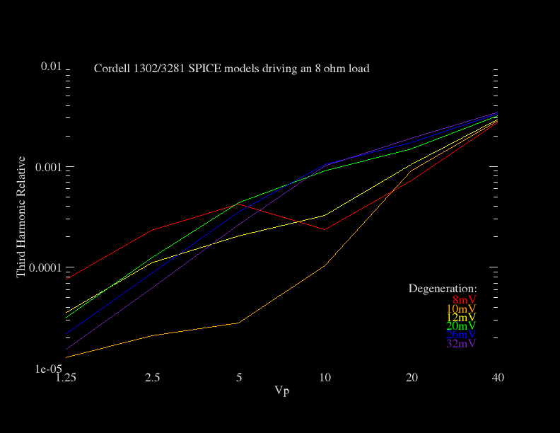

I ran a simulation on the 3rd harmonic of a single EF output stage with different degeneration voltages across 0.1R emitter resistors. There is a very interesting H3 null at 10mV, and nothing seemed to be happening at 26mV. Someone posted the Oliver paper on the null point somewhere but I can't find it, though I'd like to see it.
