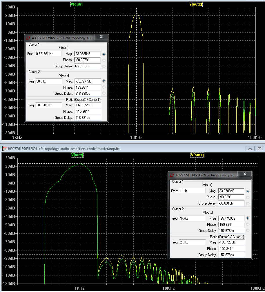

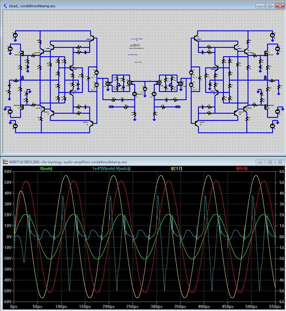

for a simmed look at the Z load issue I went back to my Cordell MOSFET amp sim http://www.diyaudio.com/forums/solid-state/240712-cfa-topology-audio-amplifiers-558.html#post3878856 - which already tests output injected current effects
copied the whole amp, loaded with 4 Ohm R one copy (outr), 2 Ohm series with 50u/5uF cap on the outz copy of my simplified Bob's MOSFET EC amp, running at 1 kHz (50u), and again at 10 kHz (5u) for nearly the same Iout, just phase shifted
the summary - sim again supports Cherry and Cordell - the distortion with a out of phase (or output injected) current is the same order of magnitude as the distortion of the amp putting out the same current in a resistor load
this is a consequence of the usual situation that output stage "current gain" varying over the operating region is the major error in most audio power amps, with follower "100% V feedback" mostly linearizing the V gain
by running at both 1 and 10 kHz we can see the ~10:1 increase in error components in the fft with Bob's compensation
