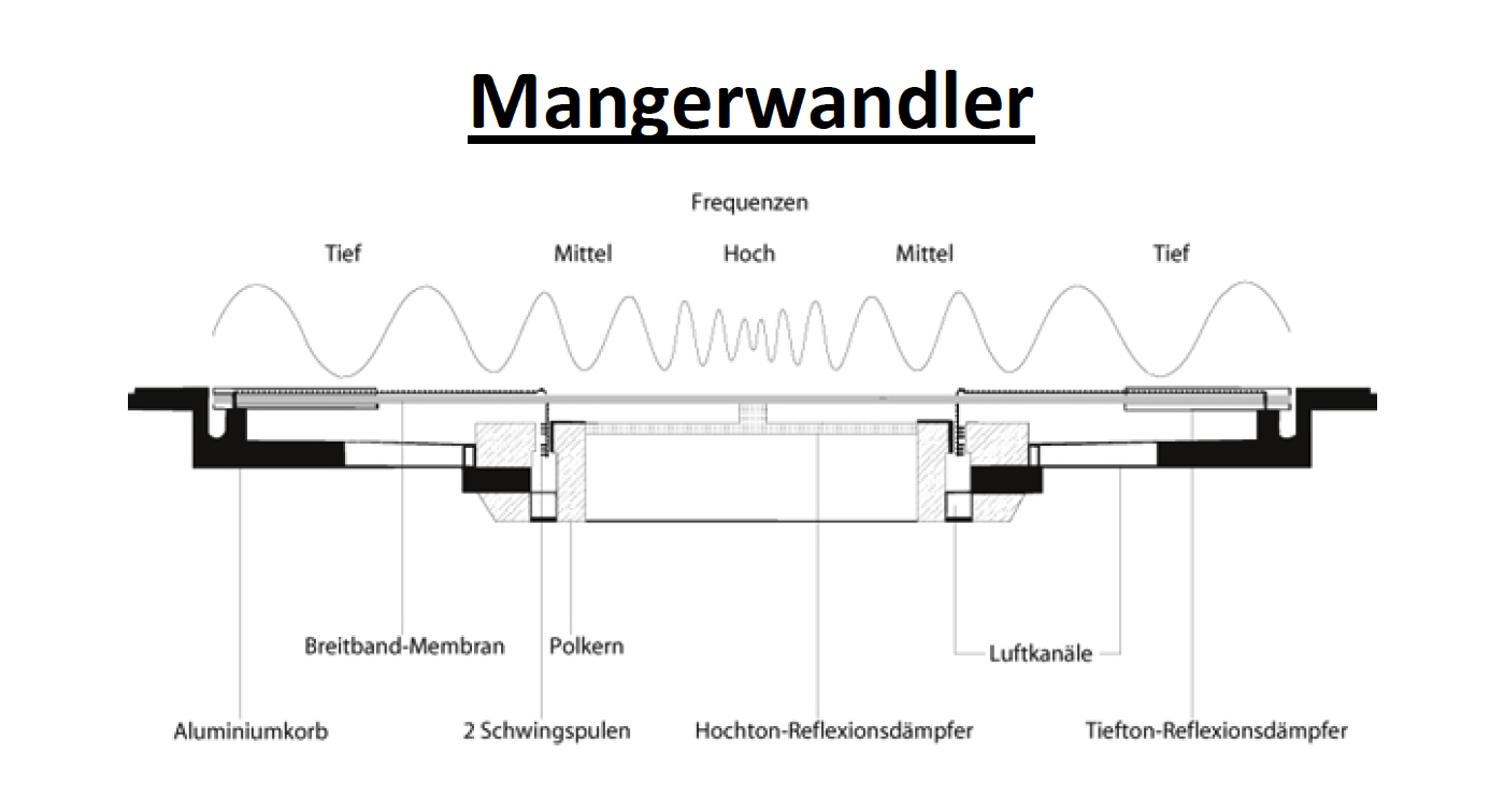

It is amazing what some on these forums try to do with speakers. The full range guys are something else. That driver looks promising for some uses, though I would not use an overhung design, I consider that a non linear device, no way is the magnetic system completely equivalent on both sides of the gap, never happens no matter how you try and the stray fields from the overhung coil make it non linear in that regard.
I love the comment about the Egyptian papyrus, that is truly funny. And I will not use a rubber surround, I do have my reasons for that but won't get into that in this forum.
This double voicecoild overhang design is even better then underhung.
Double the throw and half the mass.
Please beleave me, the surround is not the problem, it is the spider.
I never mentioned a foam surround. I could take that drawing and run it in a magnetics program and I have no doubt it is none linear by design. Sorry we do not agree but that is how speaker design goes.
And I agree that spiders are a problem but will keep that work to myself right now. But do not discount the acoustic signature of surrounds.
I just find it funny that one type of cellulose fiber is superior to another. It is the combination of the entire compound, and most will have reticulated synthetic fibers in the mix plus the binders used. It is the entire matrix that is important. I do think that paper type cones can be excellent, I just happen to be working with composites, but not something that is commercially available anywhere else in the world, it is my own creation.
