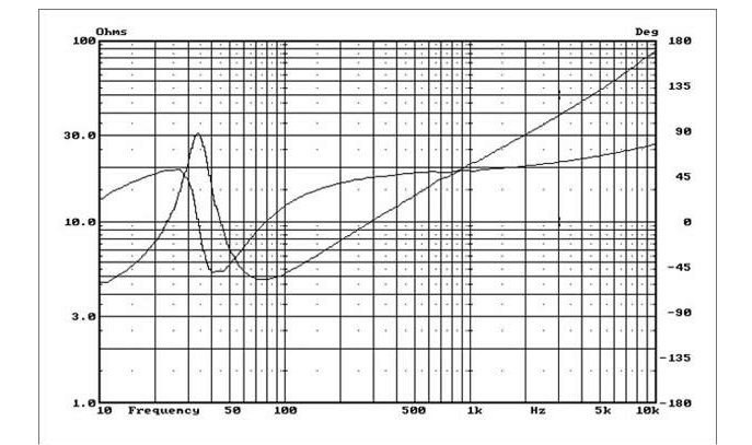

The one (below) I am testing in my new ported enclosure stresses the amp
out at 10hz and 100hz (as predicted by the OEM imp. plot).
Also , at the box/driver Fc , very little load at all - real wide range of I (on the amp).
It does read 6.5R with a DMM , so one might expect the same with it
actually running at Xmax .... NOPE.
BTW - it is a "free" tangband WT-644f sub (8R rated).
OS
OS,
That is one ugly impedance curve you got there on that speaker. I can see where you are going to need gobs of power to drive that speaker below resonance and lots of eq to get there. Why use this speaker for a sub application, it doesn't appear that is where it really wants to work?

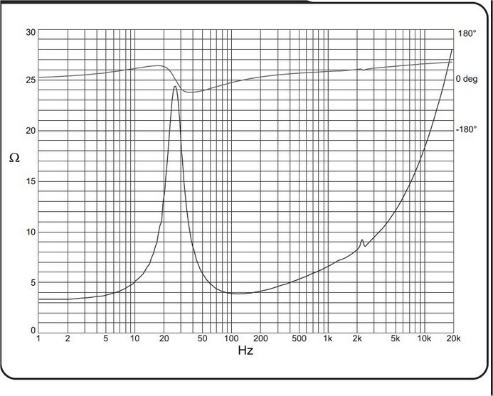

OS, there's something not quite right with that measurement. I take it you read 6R5 Rdc.The one (below) I am testing in my new ported enclosure stresses the amp out at 10hz and 100hz (as predicted by the OEM imp. plot).
Have you measured the Impedance plot yourself of your actual unit with 6R5 Rdc? The impedance plot should show slightly more than 6R5 at 100Hz
______________
Duu.uh!! The Impedance scale is on the Right side. Everything looks OK.
Cone is fractionating heavily at 550Hz too !The one (below) I am testing in my new ported enclosure stresses the amp.
Ported means Bass reflex ? I don't see any charge at the resonance, so i wonder if your measure was made in free air ?
Or is-it charged at 100 Hz ? ;-)
Don't see anything abnormal, it is probably a long coil in a little gap and high Q.

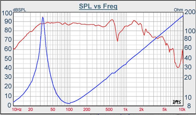

Strange, the dayton 10" I eventually want to replace it with has a similar
curve (4R - "load" that amp down - below) 😀
I also have a direct jack to the sub to test future CFA's for
LF "duty".
PS - this e-waste sub seems to have same free-air imp. plot as
most of the PE "golden subs" $$$ 😀 - the "Z peak" is lower with larger
woofers (lower Fc) ??
(below 2) , for laughs and giggles (I could not afford it) the Hivi 10 (250$)
has nearly the same curve as my "junk" 10" 😀

This is the free air impedance plot and not the in box impedance I assume? If it was in a ported box as Esperando asked you would see a double hump around the port tuning. The fs looks to be around 25hz.
You know your stuff. 🙂
My point is ... (with a AC watt meter as test) the amp is seeing a load equivalent to 5-30R from below the box tuning (@29hz) to 120hz.
The 10cm port blows out candles at 6 meters -28hz , that must be the
tuning.
PS - I do see the "double hump" in bassbox .... the amp's response
confirms this (10-120hz sweep - full xmax 150W).
It is wise to simulate @ 2-3R for OPS 😀 .
OS
