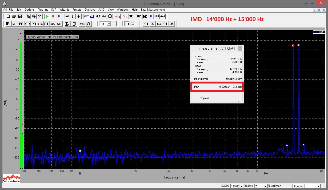

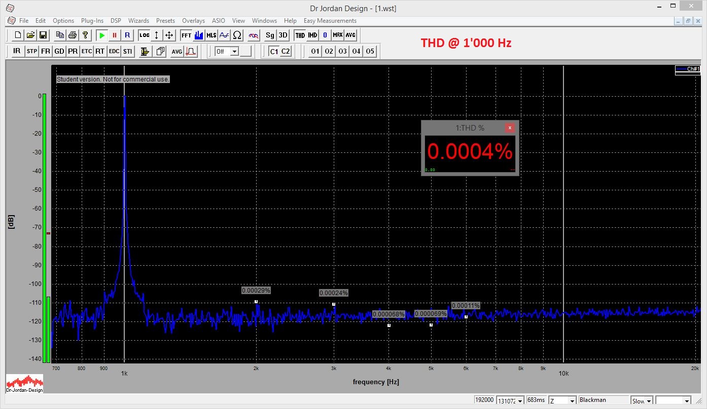

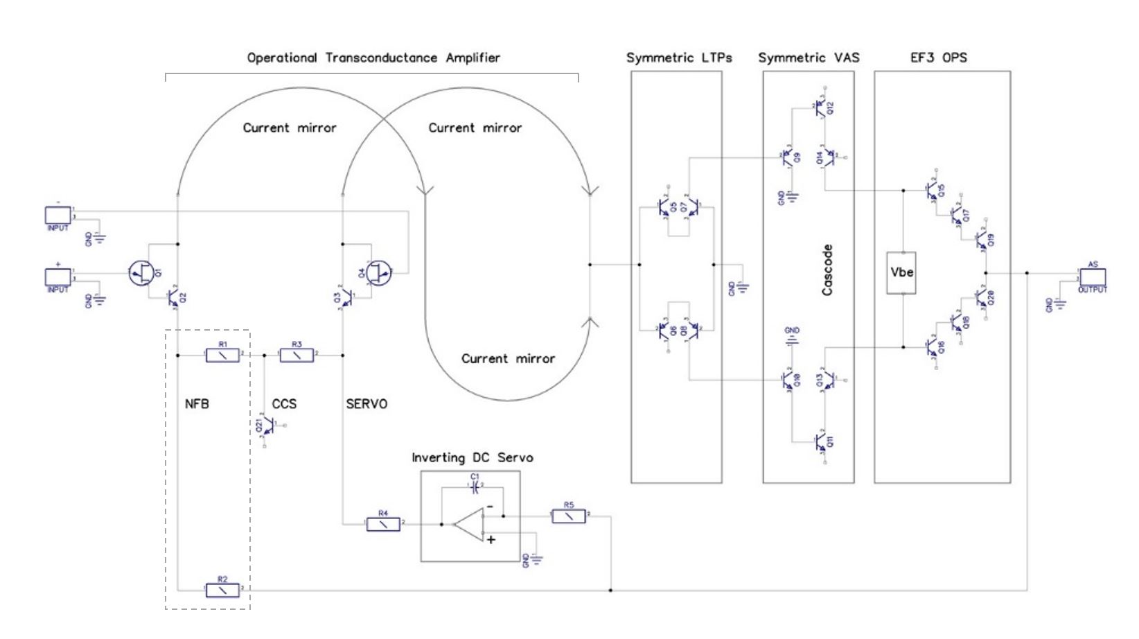

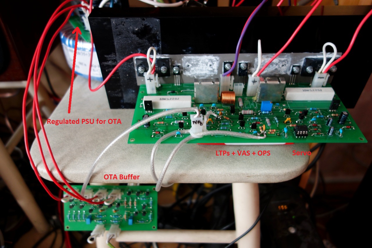

Continuing "outside the box" - balanced ultra-linear
Hi All,
Spent some time on experiments with my initial input buffer design prototype, based on OTA topology (LTP + 3 x current mirrors). After a number of evolutions, came to this setup with rather non-standard arrangement for global NFB and DC servo connections - IPS LTP's emitters. They are roughly 200 mV below zero, but this fact does not cause any problems - servo keeps the whole circuit balanced at all times.
As before, this buffer allows using the amp as inverting, non-inverting, or balanced - both inputs are fully symmetric and always available (see the high level topology diagram).

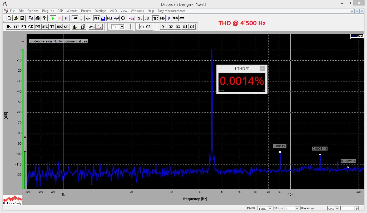

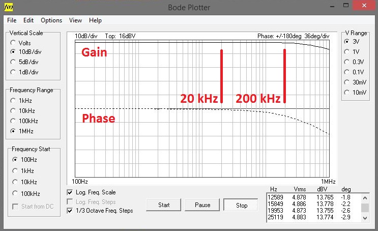

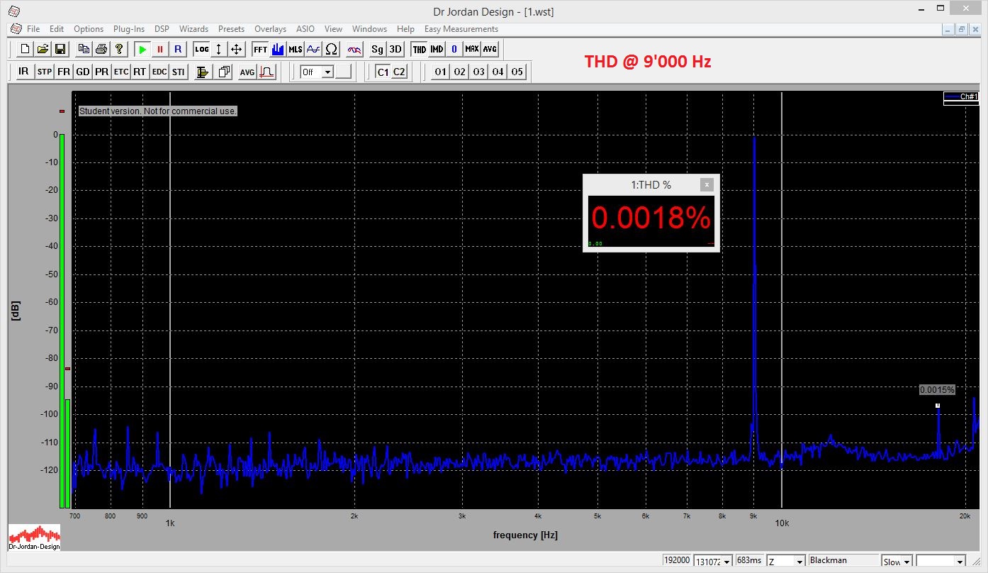

Prototype measurements and audition showed excellent results. High linearity design with good harmonics distribution. Great phase response. Very low inter-modulation. Even open loop THD is acceptable (open loop gain is 88db).

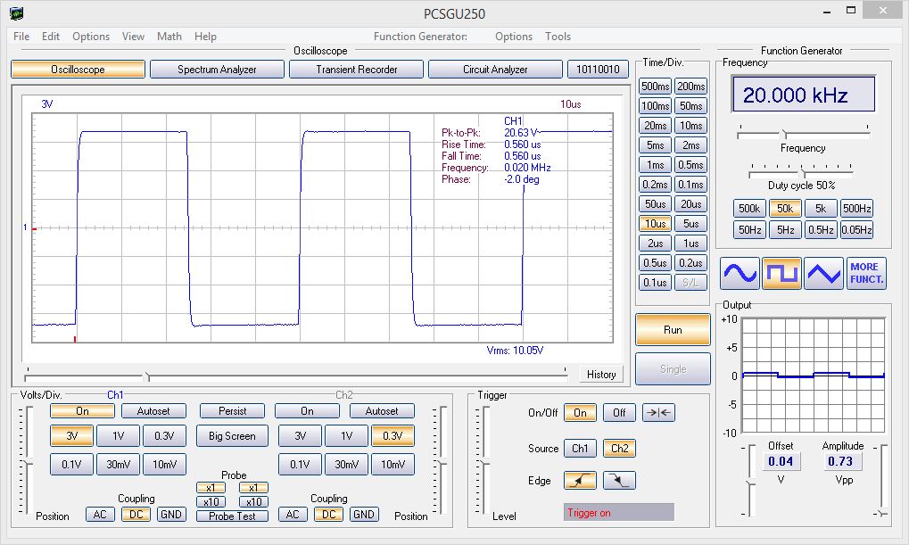

All measurements are done at 10V RMS, 8 Ohm resistive load (square wave is ~20V p-to-p). I can't go higher at the moment - my load-simulating resistor is rather hot already.
P.S. I also experimented with CFP OPS here - not really successfully. In such wide-bandwidth design it is very difficult to keep it stable. EF rules 😉
Hi All,

Structured approach
keantoken, thank you for the link.
I was not aware of this particular material, however some ideas are similar. There are also some interesting (at least for me 😉) thoughts on compensation in such designs there.

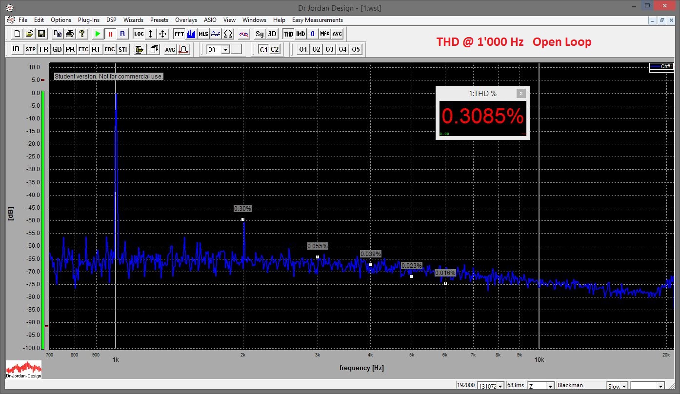

Key principles, I used in my design, are rather simple:
1) Keep clearly separated and all-sufficient stages (trans-conductance, trans-impedance, power-section);
2) Maintain as much linearity and overall quality as possible for each stage;
3) Apply global NFB to low-impedance, current-sensing point (in my case - points).
All compensation is only applied within the trans-impedance stage (Miller + shunt, very light ones, for maintaining stability), plus small cap (5.1 pF) in parallel with global NFB resistor (removing slight overshoot at fast fronts).
It results in around 88db open loop gain with roughly 0.3% THD. Then dropping 60db with global NFB and reaching 0.0004% THD @ 1KHz.
Well, we all know that THD as a single measured parameter does not guarantee good sound, however combination with good phase response, high slew rate, negligible IMD, s/n ratio and right approaches to power supply and overall build, makes it something worth auditioning 🙂

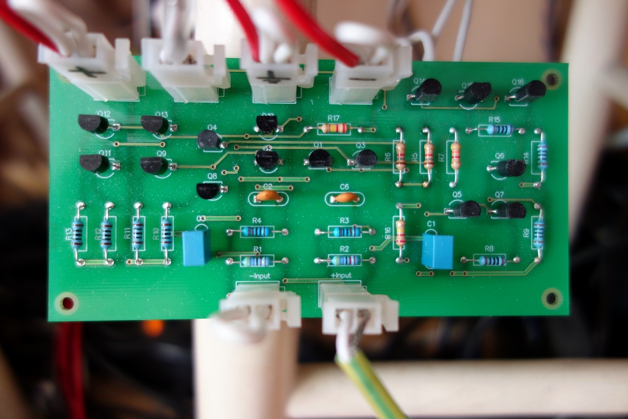

Evil CFP
Damir, you were right, CFP is too "cranky" for such design. EF shows much more stability. I will publish some prototype-based results later on...
Valery, I think that the main problem why I can't get your amp stable is CFP output stage.
I will try more but first what came to my mind is to change it to ordinary EF, maybe CFP is not suitable for the CFA. With CFP I need to add heavy shunt capacitive compensation and some RC on the drivers base to the ground, and still there are small glitches near the crossover points.
Damir
