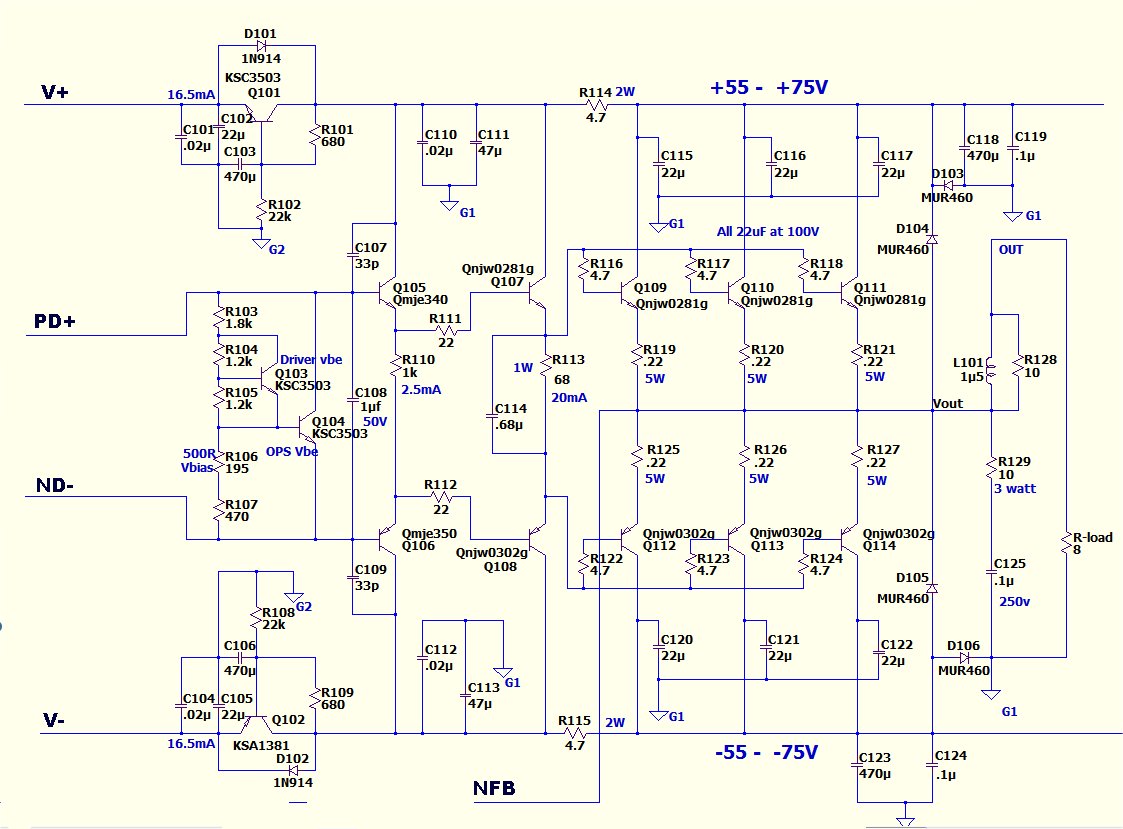

I read earlier in this thread (from none other than the guru himself, Bob Cordell, I believe), that one of the keys to achieving a stable EF3 output stage is to decouple the rails at the pre-driver, driver and output stages with a heavy RC filter.
However OS's Slewmaster output board manages with only an RC filter between the output and driver. What extra benefit would be achieved adding an additional RC filter between the pre and drivers?

Well it obviously depends on the quality of your supply, the layout of the stages, the wiring runs and another bunch of things.
It is not a law that you HAVE to decouple stuff. If their is no mutual impact it isn't necessary, if there is mutual influence you should try to isolate the stages, and decoupling is ONE technique.
There are no universal answers here.

Just because the problem is possible, doesn't mean that it's actual. OS must have found that for this design, decoupling every collector wasn't necessary. The point is that the person designing and testing the amp knows what the problem is and how to identify it. They can then apply only the fix that is appropriate, no more or no less. Some amplifiers may need more decoupling, but OS tests his designs so he knows what is needed for this one.

All of the previous answers are good ones. I recommended it for both driver and pre-driver as being conservative and perhaps a little bit more bullet proof across more different designs and layouts. Note that the current requiresments for the pre-driver and the rest of the circuitry up front are often less than that for the drivers, so we can sometimes afford to use a bit more series resistance in the decoupling filter feeding the pre-driver. It also gives us one more chance to attenuate nasty HF rail stuff.
May-be we should separate HF decoupling from Ripple Filtering in our points of view on the question ? Andrej noticed on his amp that filtering its drivers introduced some king of 'blur' in the sound quality, and prefered the non filtered version.
All this depend a lot of several factors, including the printed board implementation.
On my point of view, this filtering question need both to use our ears and look at our oscilloscopes just before the final design, in an experimental way with real musical signals. ;-)
I have never found a universal best solution i can apply each and every-time.
Hi OS, is there a reason why you chose not to decouple the rails between the driver and pre-driver on your Slew-OPS? I.e. is it unconditionally stable without?
Also wondering whether the output base stoppers can be reduced from 4R7 to 2R2 and the driver stoppers from 22R to 10R without any ill effects. If not, would driver-pre-driver collector decoupling allow the base stoppers to be reduced in value, or does one have nothing to do with the other?

I don't want to remove the base stoppers (I recently built the LTT4 project posted in this forum, an EF3 without stoppers on either the outputs or drivers, and I couldn't stabilise it without grafting stoppers on the board).
Voltage will be dropped over the base stopper, limiting peak power, and for that reason I think it would be worth limiting the value to the minimum possible. I believe Bob Cordell has recommended 5R maximum for the output base stoppers. That leads me to think that a somewhat lower value should be achievable in practice, particularly if some other measures are employed.
Many of the EF2 projects with many outputs hanging off the drivers use 2R2 output stoppers. Many of the small EF2 designs seem to get away without any output stoppers at all. Is there any correlation between the number of output pairs and the base stopper values?

Ahhh ! I have delved into this quandary. 😀
With no R/C between OP-driver/pre you can get stability with the proper
choice of pre/driver/OP.
PS- you can use NO base stoppers with the R/C.
Adding the R/C allows for a lot of "slop" in component choices.
The 30 YO sansui has no R/C with slow/fast/ slow for pre/driver/OP.
The newer harmon/ kardons use the R/C with fast/ fast/slow.
I was surprised at this "ignorance" of the standard practice , both
use NO base stoppers .... but survived 20-30 years 😱 .
In simulation , it is apparent that local FB through the rails (to the predriver) attributes to any instability in the typical EF3.
Adding the single 4.7R/47u R/C to the "slew" OPS(driver/pre) ... 😕 works ...
5th element's 5ppm VFA blameless all the way to Thimios's 400khz perfect
square waves (CFA) .. my EF3 does what is required - without any issues.
Also , why not assure perfection ... I use the stoppers , as well.
I think the OEM's are just cheap ... and use precision semi choices
to eliminate any component they can get away with. 😀
Edit- create an EF3 that DOES oscillate - find out why it does , and reverse engineer.

Here's a 'real life' test on plain EFs. No drivers or other stuff to confuse matters.
http://www.diyaudio.com/forums/solid-state/234408-stability-analysis-ef-output-stages-2.html#post3461363
ostripper, its an EF1 stage which DOES oscillates 😱
Reducing those base resistors WILL reduce stability. If you're not bothered if your amp has hard-to-troubleshoot instability, reduce those base resistors.
You might like to work out how much headroom you lose with 4R7s.
If you want to sim this, be warned that this mostly isn't a general feedback instability but to do with parasitics .. ie really difficult to sim with any confidence.

I see you hit on Ccb , this is quite common on all the OEM's
(I also use it - 47p - badger AND slewmaster).
All 3 "tricks" (Ccb , R/C , and stoppers) make for a very "tame" EF3.
Without , you can actually see "peaking" in the 3-5 mhz+ range in a loop gain analysis.
