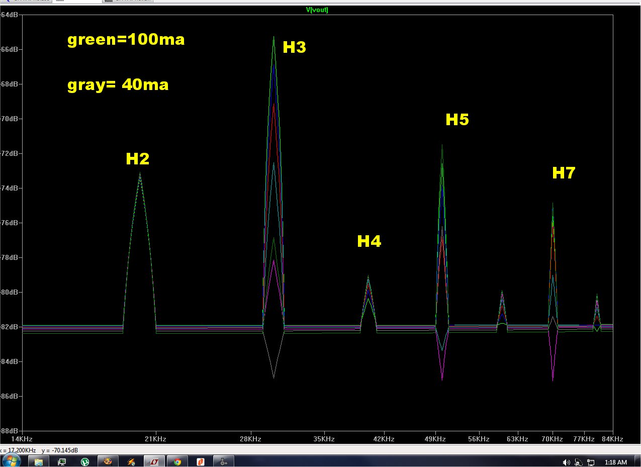

"Null point"
Ahhh , someone noticed ! 😎
Stepping through biases from 100ma down to 20ma .... the "null" of
either H3/5/ or 7 occurs. Different "nulls" for each bias point - interesting.
40ma seems to be ideal (grey).
This does not happen in the same way with all amps. Topology
seems to be a factor.
(below) is this "effect" with my EF3/ CFA-X (vssa variant).
OS
An Amp I am screwing around with -- opt bias appears to be in the region of 60-80mA/device. The null is more narrow at 4 Ohms than at 8 Ohms.

If you plot the output stage gain vs bias current you get a very big difference in the curves (see Self for example and other plots done on this forum).
This is the main reason for the changes in harmonic strcuture vs bias current.
Also, explains why for example, HEC works so well - it flattens out the gain curve and suppresses the distortion components.
I suspect the topology dependence somes from the loop gain profile, OPS driving source impedance, and loading of the VAS.
40mA through 0.22R is about 9mV, so even lower than the 10mV point I got (giving degeneration voltage is the least vague way to identify different bias points in terms of transfer characteristic).
Anything preceeding the output stage that modifies the transfer characteristic can shift these points. The load-dependent harmonics may cancel and fight with the signal-dependent harmonics and this can result in wild harmonic behavior.

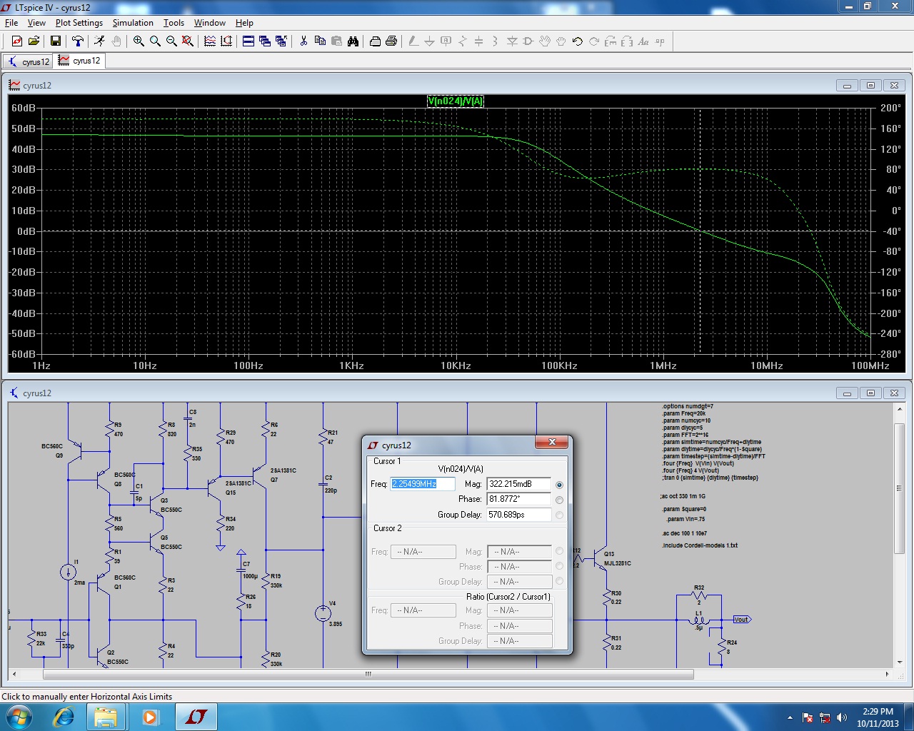

Here is example of how to have 2 pole response whithout the overshoot penalty.
Basically two shunts.
