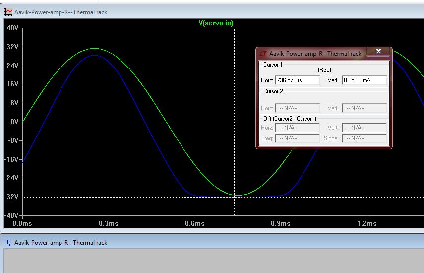

I do something along the same path. A non switching Class A-B OPS.
This is the distortion (20 KHz/80V/p-p on my Non switching error correction OPS running open loop with a gain of 1.
A non global feedback amplifier is in the making.
Harmonic Frequency Fourier Normalized Phase Normalized
Number [Hz] Component Component [degree] Phase [deg]
1 2.000e+04 4.023e+01 1.000e+00 -0.46° 0.00°
2 4.000e+04 1.033e-03 2.568e-05 12.41° 12.87°
3 6.000e+04 5.992e-04 1.489e-05 -85.51° -85.05°
4 8.000e+04 9.264e-06 2.303e-07 -94.70° -94.24°
5 1.000e+05 2.299e-04 5.714e-06 89.82° 90.27°
6 1.200e+05 3.884e-05 9.654e-07 15.11° 15.57°
7 1.400e+05 7.236e-05 1.799e-06 102.73° 103.19°
8 1.600e+05 1.987e-06 4.938e-08 -3.26° -2.81°
9 1.800e+05 4.298e-05 1.068e-06 110.33° 110.79°
Total Harmonic Distortion: 0.003032%

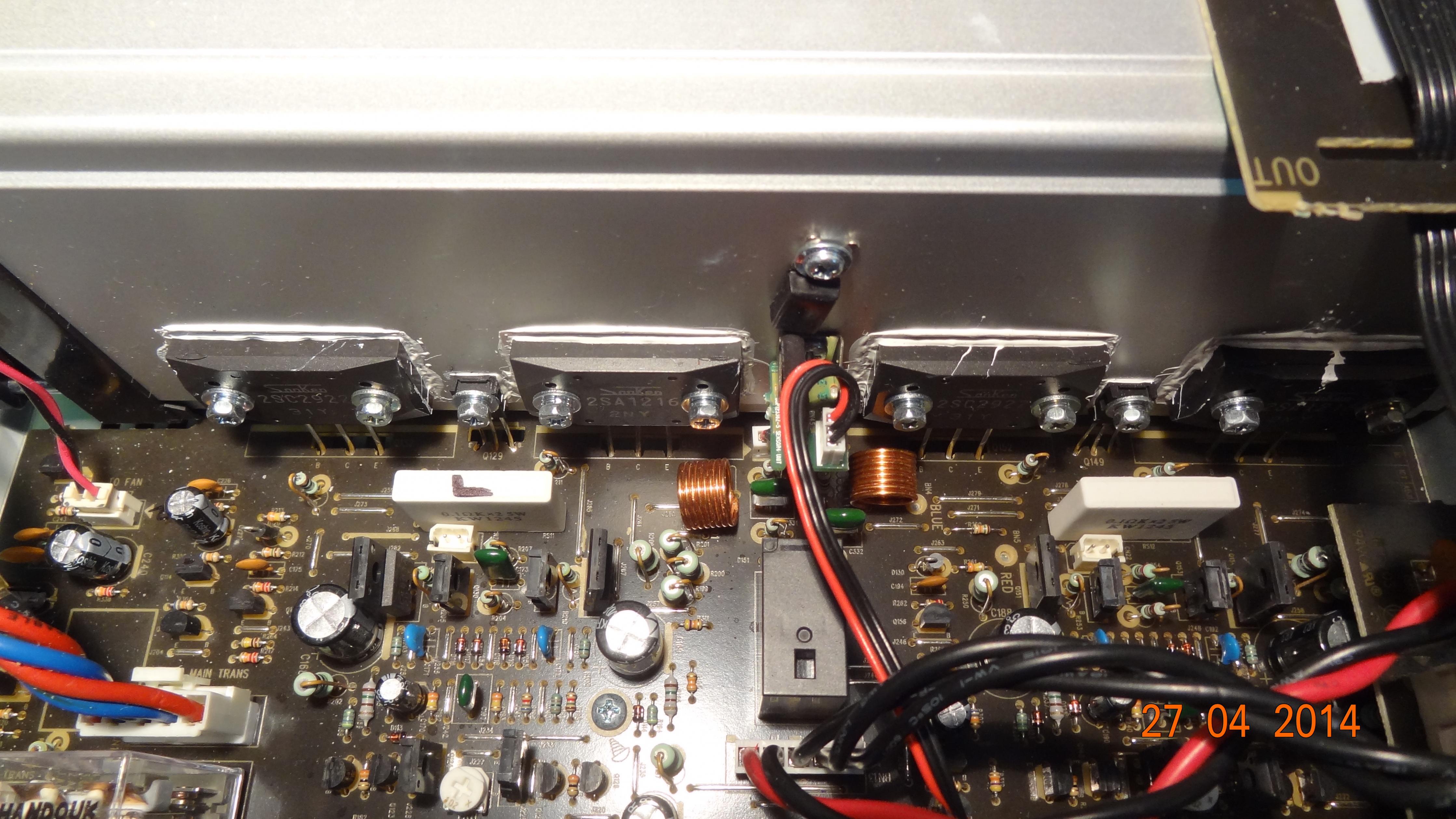

I like your amplifier build, but I would like to say that it is good to use fusible or non flammable resistors on the output stage as it prevents board damage with an output stage failure . They look like carbon on the bases on the output devices I would use fusible types , I m not sure what RE (0.22R ) types you are using but I would use metal oxide types there if you are not already.
hello,
there can be a couple of problems with fusible resistors.
1-they can be nonlinear near the fuse point.
2-Because each transistor is now fused when one blows it severely throws off the balance of the remaining transistors
A short side comment, I've noticed that most implementations here are placing the output inductor on the PCB. This is, in my opinion, a very bad idea. The magnetic field couplings (in particular at high output powers) are guaranteed to add a useless spread of even order harmonics. I would place the output inductor, and the parallel damping resistor, as close as possible to the speaker connectors, and as far as possible form any signal cables.
Good night.
Hello,
it is important to remember that the inductors need to be oriented at 90° to each other, ideally aligned to the center of the device to minimize crosstalk.
