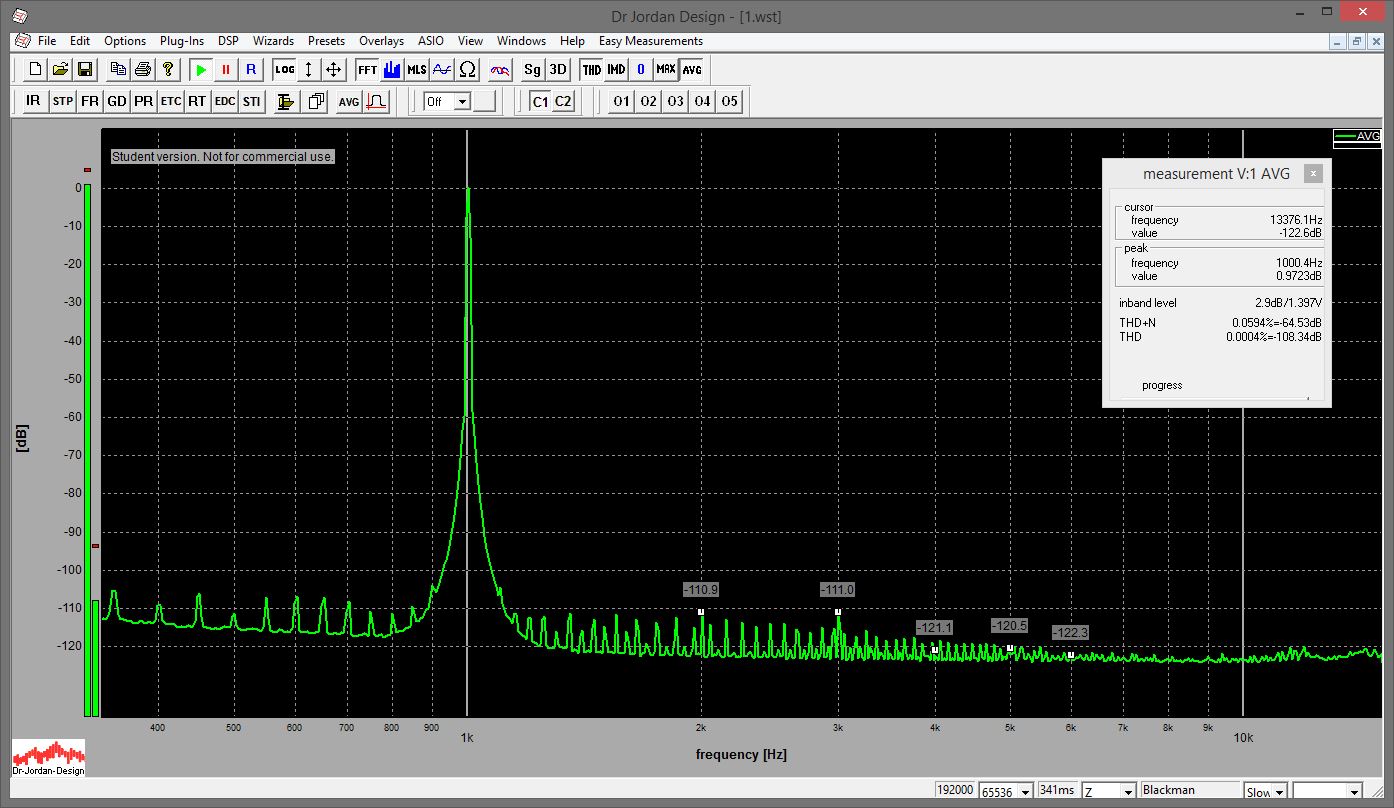

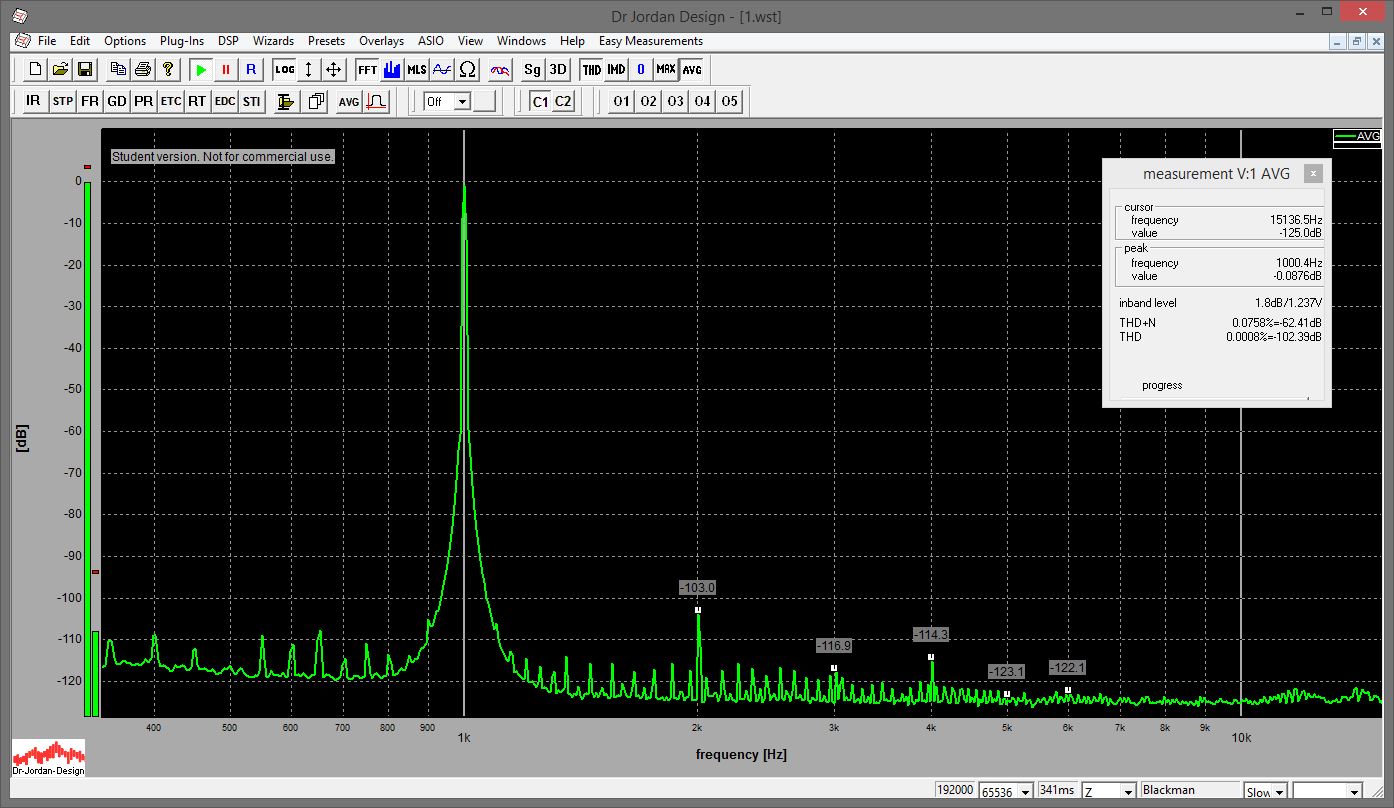

It's a sound-card based WinAudioMLS Pro EX from Germany.
(Manufacturer)
Pretty accurate tool, assuming a good card is used.
Just as an example of what it looks like, attached is 1kHz spectrum at 8 ohm resistive load, about 10V rms - my initial CFA prototype. Some 50Hz hum is visible (somewhere at -110db, but still).

After heating-up with high signal, switching back to initial volume - quiescent current drops a bit below normal - this is the spectrum
THD doubles, but taking in account absolute level - you will not notice
As Jan just said

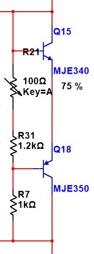

I have been watching an learning from all this information about bias drift related to dynamic temperature changes and have a simple question. When looking at most circuits and the schematic layouts what I see often are the final output devices mounted on the edge of the pcb so that they can simply be mounted to the heat sinks, but the pre-driver and the driver transistors are often in the middle of the board away from and impossible to mount to the same heat sink as the power output devices. What is a good engineering solution to this problem, how can you mount these same devices on a common heat sink to solve the heat spread between the differing sections of the amplifier, and is the solution to the mounting of the pre-driver and driver transistors going to cause other problems that are just as important? In the layout of the design in the first place where optimization for lowest inductive currents and shortest path lengths are the driver of the circuit layout to begin with, are we just trading one set of problems for another?

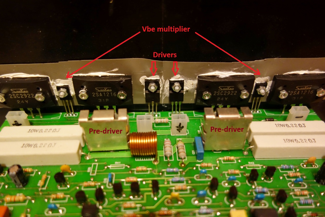

Just to share a practically refined, well-tested solution (which is pretty much in line with Bob Cordell's recommendation).
I mostly use EF3s in my designs. I put pre-drivers on the small individual aluminium heatsinks.
The drivers are at the common main heatsink with the output devices. 2 Vbe multiplier transistors are either between the big ones (if I use 2 pairs), or between the big ones and the drivers (if I use 1 pair).
Vbe multiplier - one of two transistors is used as a diode, in this case thermal feedback is just about right (otherwise, it slightly over-compensates).
This design is heavily tested in both VFA and CFA amplifiers, demonstrating good thermal stability.
