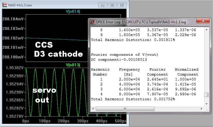

Yes , we need power. And a front end that is stable (in all ways).
(below) Is the next best thing. The "last best thing" works very
good ... (the NX/NAD). Many have built it.

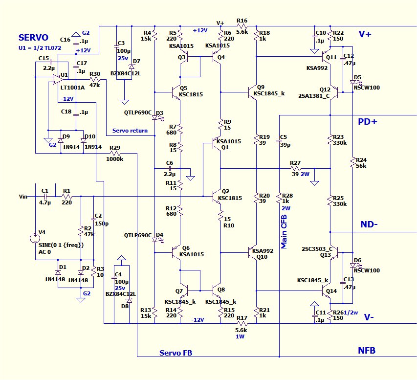

I just can't leave it be 😀 ...
-more PSRR
-better offset
-lower THD
-keep it simple
I seem to have succeeded. Keep seeing these ideas in other threads -
but that's cool....
Member Dadod has me beat by a few PPM - but his ideas are
very good ("ditch" the diamond 😀).

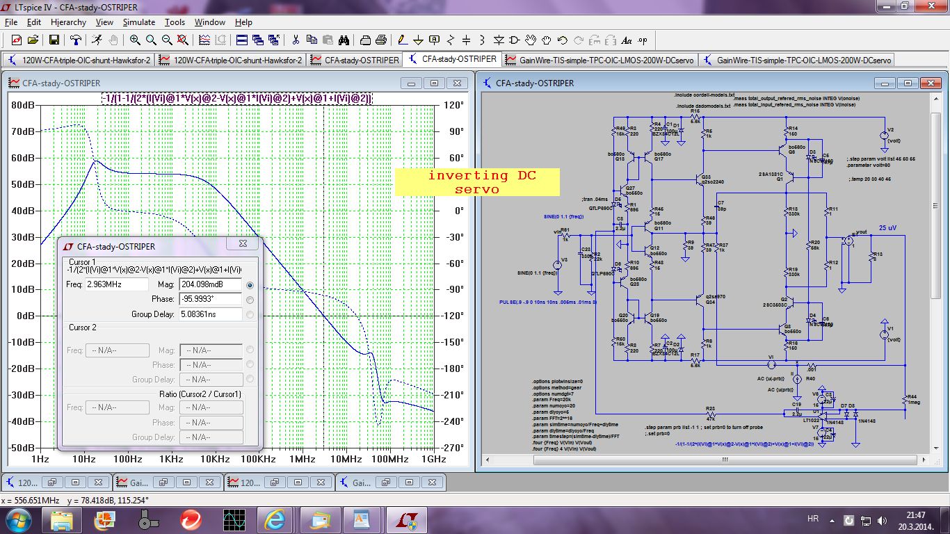

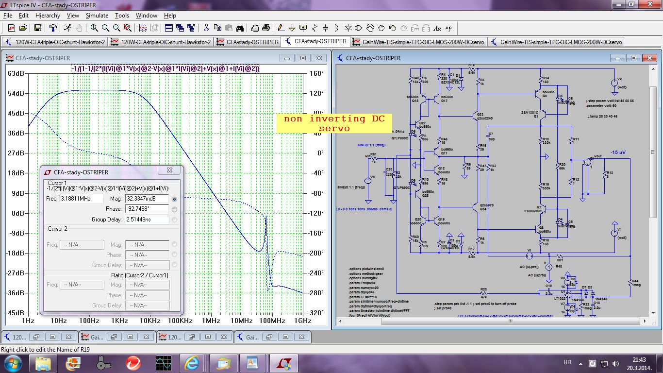

OS, I think that you did two errors with your DC servo here, first you should use non inverting servo, second increase DC servo output resistor, try 220k. Try to plot LG with your DC servo and then with suggested changes.
Dado
Dado

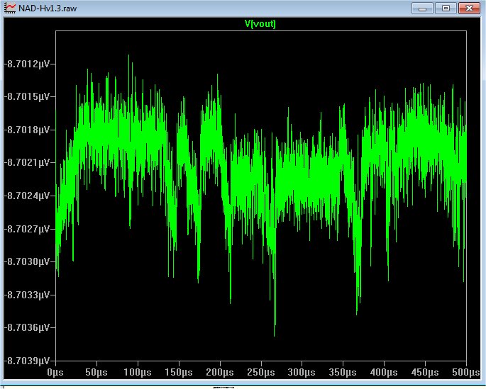

Non- inverting gives me -20v offset ! 220k works , but requires the servo
to output 8V for correction. 47k only 1V.
It works (below) as posted.
PS - I'm using 12V supplies and no cascodes. Output has -4V offset with
no servo ... so the servo is "servoing" 😀 .
OS

Another thing that worries me about "ditch the diamond" ...
is the very low Vceo of the input pair and the saturation
characteristics at these voltages.
I only gain a few PPM over the diamond IP stages THD and
LOSE 3+ db CLG. 😕
UG + bandwidth and slew are constant (very close), either way ... as well.
But it works , and works good ... either way .
OS

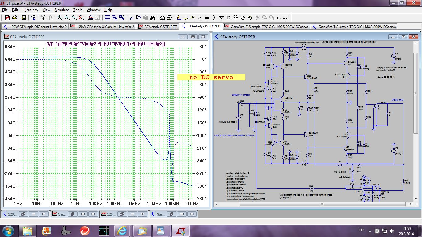

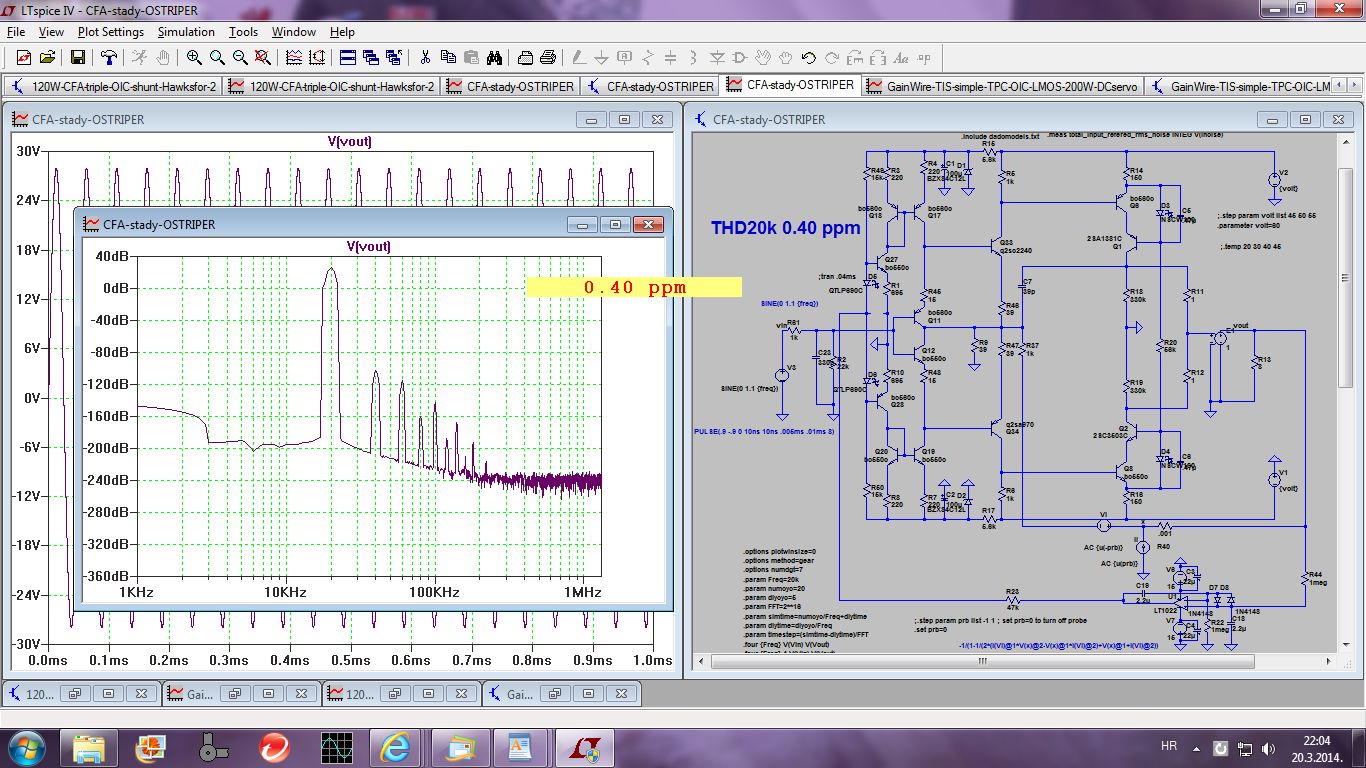

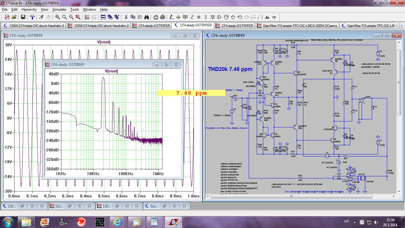

Because what you said above I simulated your IPS in isolation with inverting and non inverting DC servo. I used different transistors all models from Cordell. I don't understand how did you get -20V offset, and even -4V offset with no DC servo is to much. I got -130mV offset in my simulation with no DC servo connected.
In my simulation both kind of the DC servo works bur with inverting servo distortion rises specially at low frequencies.
Tell me what I do wrongly here??
Damir
