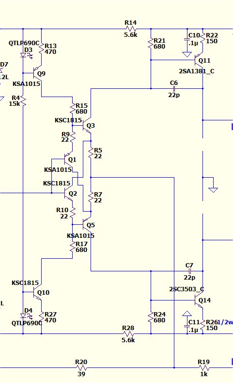

WOW !! 😱
Where did they get that IPS ?? (below)
Its "smokin' " fast and very easy to work with.
It's VFA .... but I could make it CFA 😀 try em' both....
OS
This is an invention of mine. I have not seen a circuit like this before. 😎
I can not estimate how high the potential is ... you have to look.
Have fun with it 😉

I would make R15-R18 as high as reasonable, since they improve the current sources and are a cheap gain. As I recall you could even short the current sources this way because the buffer nonlinearities are low and they cancel as well.
Ø-stripper, will it be possible to drive it differentially and then current feedback the one leg of the pair..??
I noticed as a CFB amp , it IS your "bog standard" NAD/NX (below).
All the inverting side does is V/I conversion for VFA.
In VFA mode (all 8 devices) , it is a self contained CFB "module" ...
as each V/I feeds current to the other "side". 😎
They match each others performance (VFA/CFA).
PS- I have to research the sansui "diamond drive" ... to see the
OEM setup.
