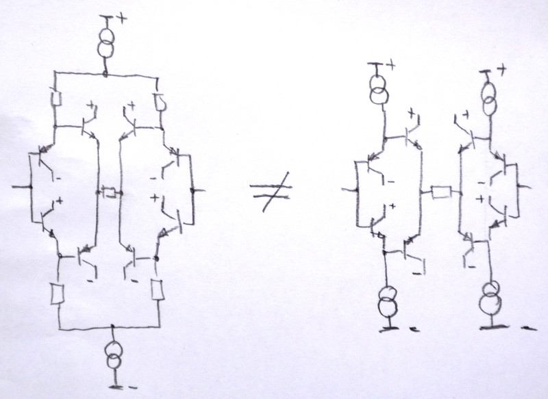

Ostrpper, reason I asked was the desire to make a CFB balanced to single ended converter both as an IPS, and also for a line level circuit block
There it is ... below.
OS
This is an invention of mine. I have not seen a circuit like this before. 😎
I can not estimate how high the potential is ... you have to look.
Have fun with it 😉
Lt1364, lm6172, and many others. Its pretty old, being patented around 15 years ago. Krell and Marantz have so far made use of this topology in commercial products as have I. It was shown before on this thread and I did make a mention of your effort that I came accross in the forum btw.
You have to look closely.
My circuit consists of a differential amplifier with a constant current source. Now the signal is not as usual, taken at the collector, but to the emitter. This is followed by the buffer. All symmetric.
All your examples are different.
This is an 'H' bridge IPS.
Since the feedback signal is buffered, you can get very fast slew rates and settling time. Usually, there is a resistor between the two diamond stages, and this ultimately sets the slew rate.
I dont think this is the so called H bridge topology as Analog devices calls it. It was also not their invention. I could be wrong here but mabe scott wurcer could inform. I have asked before but he either missed the post or didnt want to devulge. From what I gather the H bridge arrangement is quite a different circuit, I could show here if its ok with Scott and or Analog devices. Either way you might be interested in checking patents by Roy Gosser, it will get you the right answer I believe.
Tell me, if you take a look at LM6172 or LT1364 how your circuit is any different. I actually did a small analysis on it as yours doesnt use the resistor. Turns out it fuctions pretty much the way the LM6172 decribes in their datasheet. This is like the Curl circuit different people will see it in their own way.
In my circuit I have only 1 constant current source for the positive and the negative entrance.
I know, the invention is not high but it save components and makes layout easier.
In all my simulation the both circuits working in approximately equivalent.
(The resistant between the buffers have nothing to do with my consideration)
