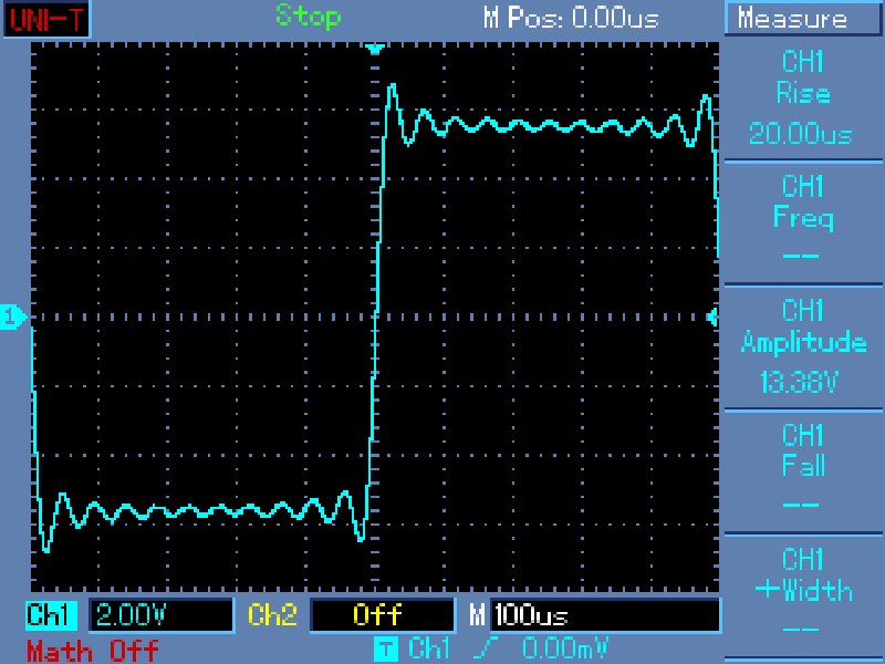

Well, what the maximum possible slew rate from the CD to the power amplifier output?
Best regards
Petr
The answer is very, very easy. You will get nothing faster from CD than the attached rising edge. Keep the time and scale the Y axis according to amplifier's output voltage swing. To make it simple, let's assume 20V/div scope division and the swing (with ringing) of 130.7Vp-p. Then the SR would be about 80V/0.8div, i.e. 80V/16us, i.e. 5V/us.
Should we design to a limited number such as 5v/usec or should we design to be maybe 10 times better? Should we design a ss amp to have a freq response that falls off at 20KHz (without filters doing it)? Should we design an amp whose low end response goes to 40Hz (-3dB) .. few speakers go lower. And, S/N ratio based on typical listening room background noise level. Etc etc. If we did ALL those things based on minimal requirements, would it sound better? Or even as good as designs which are 10 times better or more?

That's an easy question. Nobody has here the material and time resources (except perhaps Mr. Marsh, but his interests appear to lie elsewhere) to engage in any serious DBT. Besides, I doubt that even the most careful conducted difference and/or preference DB test will ever move an inch the staunch CFA (and VFA) sacred cows from their positions. We all know that, when it comes to audio, any DBT is inherently flawed, isn't it?
That's a rule of thumb that our instruments should be 10 times faster if we want to measure or transfer anything reliably and 'unaffected'. Anyway, 50V/us is not any strict or tough to get parameter for a 200W/8 ohm amplifier. Quite easy to get, isn't it?

Looking at the matter of slew rate in audio amplifiers from my own personal perspective as a professional designer of instrumentation for semi-conductor functional and parametric testing systems then the answer to to the connundrum of why such a preference may exist seems obviously not to lie directly in the harmonic and temporal content of the media itself i.e. music; but moreso perhaps in the many additive and subtractive compound misdoings within the messenger i.e. those circuits and components which perform the amplification thereof.
By this what I mean is that given the need for audio amplifiers to employ at least RF input filtering then; the advantages of a higher internal slew rate are primarily of benefit in the amplifiers correction of itself rather than being of any real relevance to the actual input and output signals per se. Even a cursory examination of the spectral content produced by these internal amplifier circuit non linearities can be seen to give rise to higher frequency components beyond those present at the input.
As it is well known that below a certain threshold of distortion there is almost no correllation whatsoever between percieved sound quality and conventional single frequency THD test results and with the same holding true for IMD and even multi tone burst testing.
My first question is: How realistic is it for us to expect that any single solitary slew rate parameter would be in any way a better indicator?
Therefore, my second question becomes; not what slew rate should be targetted, but: How do we determine what internal slew rate target should be set for any given internal circuit configuration?
