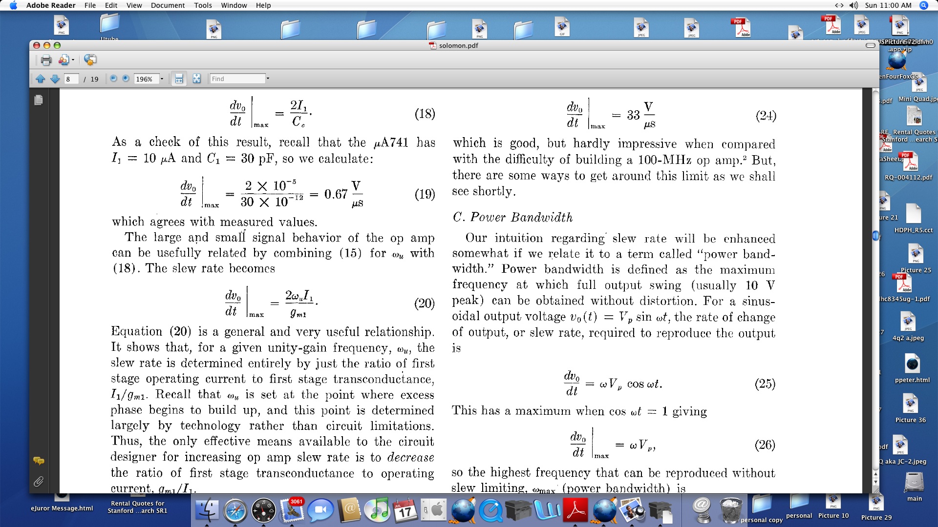

Small signal: BW=0.35/Tr where Tr is the rise time and BW is the bandwidth. For a 350KHz bandwidth, the rise time is 1uS. The bandwidth is usually defined by the input filter (for avoiding RFI ingress), however without the input filter the bandwidth could be much larger (and therefore the rise time could be much lower). What is important is that the rise time is independent on the signal level; a 1V output and a 40V output will always have the same rise time of 1uS (assuming no large signal slew rate is occurring).
Large signal: assume a Miller compensation cap of 100pF charging with 4mA from a LTP up to 40V. The slew rate is 4mA/100pF=40V/uS and the time required to reach 40V is also 1uS. The slew rate is essentially dependent on the signal level. A 40V signal will slew in 1uS, while a 1V signal will slew in only 25nS.
From the above example it is obvious that, for a square wave signal, at low output levels the rise time will dominate the response in the time domain, while at high output levels both the rise time and the slew rate will dominate the time domain response.
Of course, the above example is arbitrary, results can be very different depending on the topology, compensation method, etc... What is important to always recall is that rise time has nothing to do with distortions, while the slew rate may induce "slewing distortions" if the amplifier slew rate is lower than 2*PI*F*V where F is the signal frequency and V is the peak voltage. For a 20KHz sine signal of 40V peak, the required slew rate is about 5V/us. It is now obvious why choosing 1V/us for each peak output volt is about x8 the minimum required value, definitely making the slewing distortions a non issue.
So, bottom line, if a 100W/8ohm amplifier has a 40V/us slew rate, forget about any slewing distortions. Everything over that is what Mr. Cordell calls "gravy". Running after hundreds of V/uS slew rate doesn't make any sense, and therefore all the noise around CFAs in audio (if such an animal exists, which I have already proven it is not, for all theoretical and practical reasons they are all VFAs) is simply marketing nonsense.

Whoops, wrong picture: This should be the right one. Now, this is 'boiler-plate' engineering design that has been taught for the last 45 years or more. Solomon and Willy Sansen learned it from the same professors as I did, back then.
