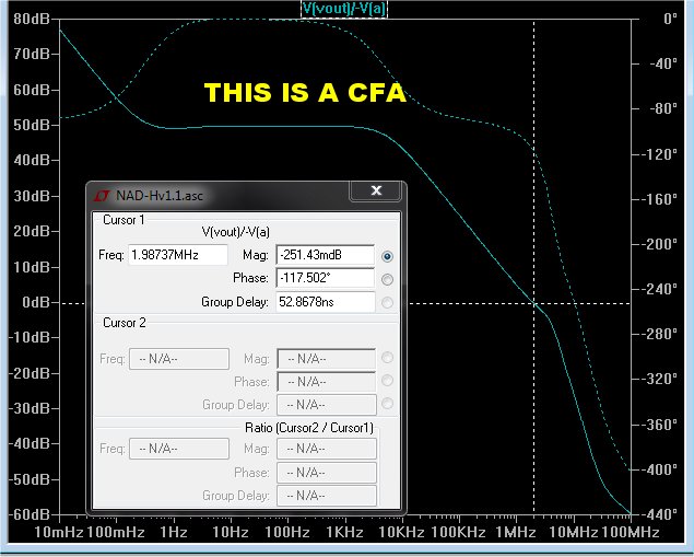

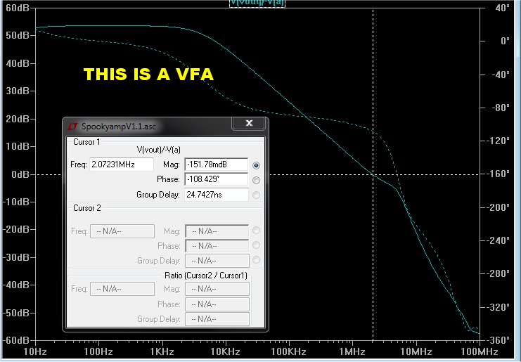

Yet we saw substantial differences in CFA and VFA both in slev-rate, frequency response and phase margins.
Mathematics is only a model of reality.
Those differences are not so great ... I have a 2+ mhz UG-220V/uS VFA.
I will admit it was harder to compensate for that level of performance. 🙁
On the other hand , even as one could design a 3+mhz - 400V/us CFA ,
do you really need that much bandwidth/gain margin for audio ?
Diminishing returns.

You can get the same performance.
CFA - simpler, but harder to get PSRR-offset under control.
VFA - harder to compensate with an easier offset solution.
More parts !! 🙁
Both are 200+ slew/2mhz UG. Both have a similar gain margin @ 20K (and
low THD).
OS

If it is harder to stablize in SIM, I found it even harder to do in real physical ciircuits.
In 'practice' the CFA always was a piece of cake to have stable. No messing with complex schemes were necessary.... and which inevitably needs some fudging to work in practice.
There is no difference in complexity to dc servo either IMO.
And simpler circuits for equivalent performance were also easy to stabilize.
