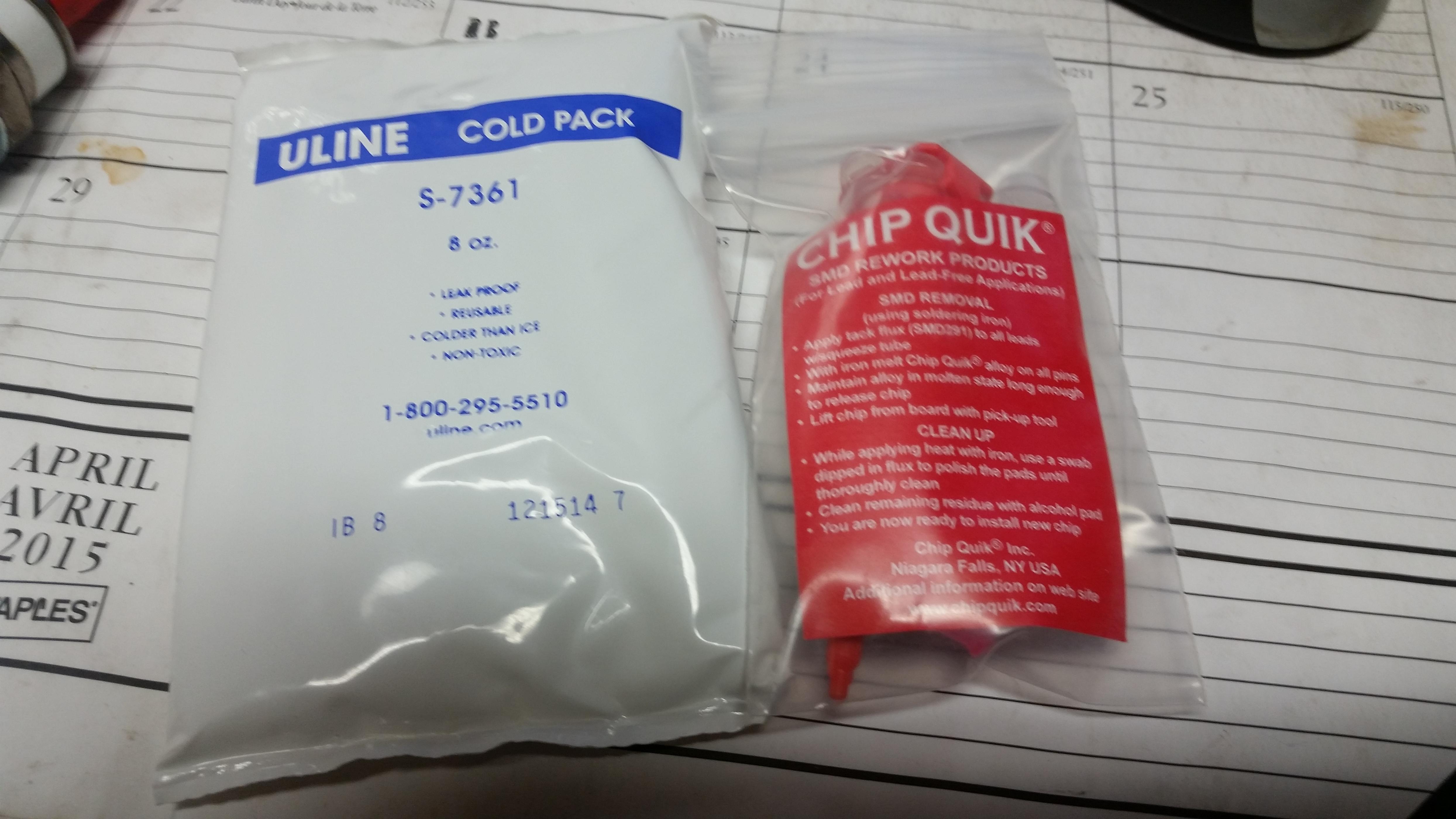

iirc you are to refrigerate solder paste, to extend its shelf life.

They don't say anything about refrigerating it on their packaging but mine just showed up with an ice pack in a cooler bag today. They've never done that before.

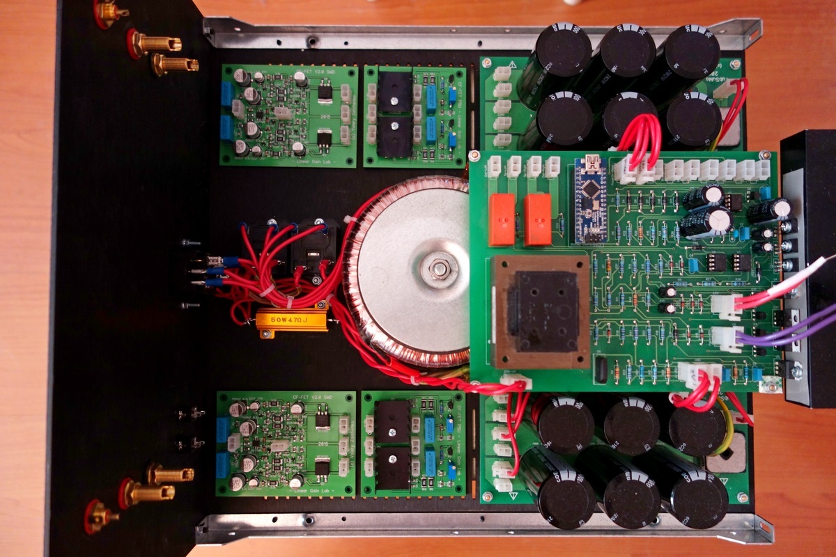

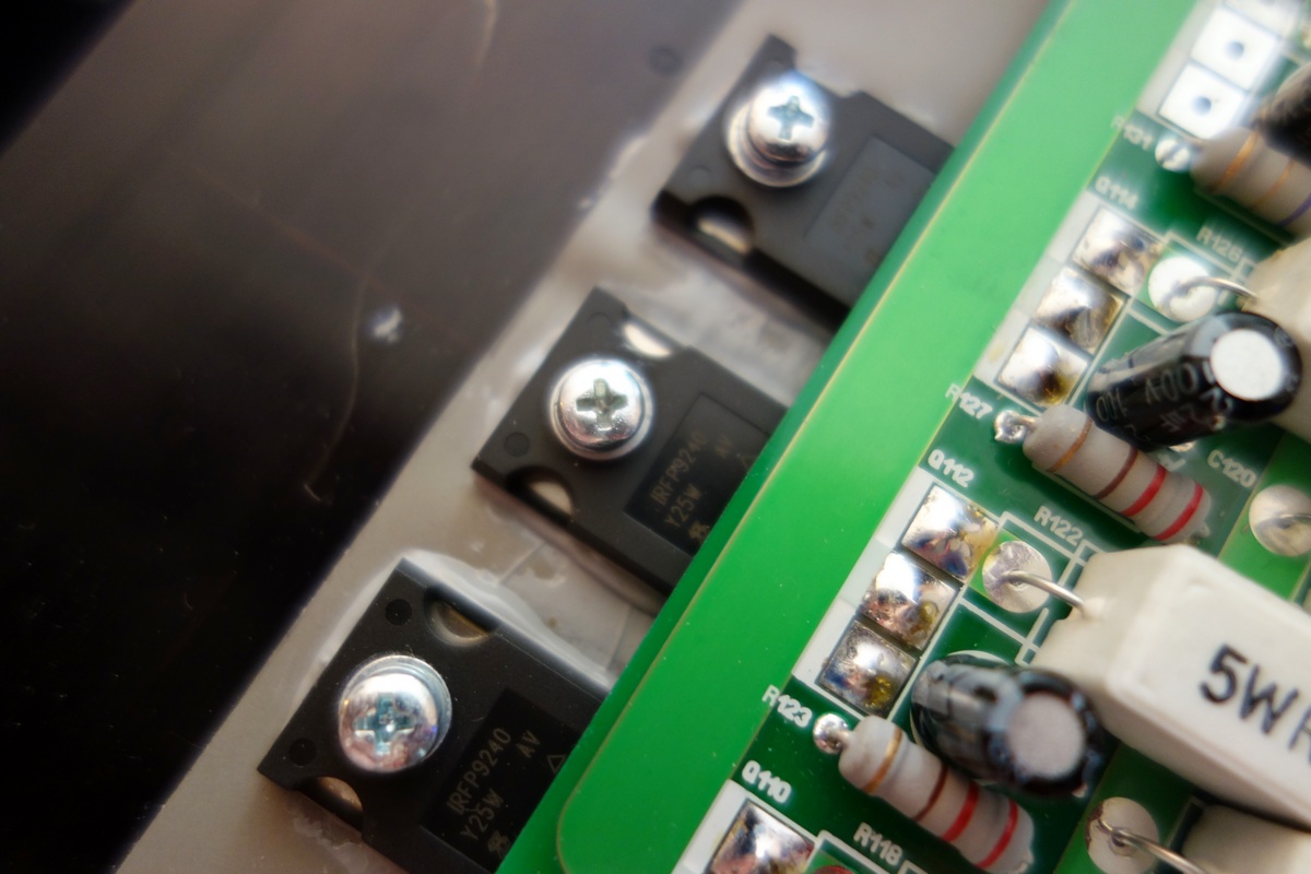

Moving forward
Slowly but surely...
Ordered the steel shielding boxes for the front-end sections.
Heatsinks are in the workshop for precise drilling.
All the modules are soldered and tested.
I want to build i nicely 🙂
Hope to see it working soon 😉
