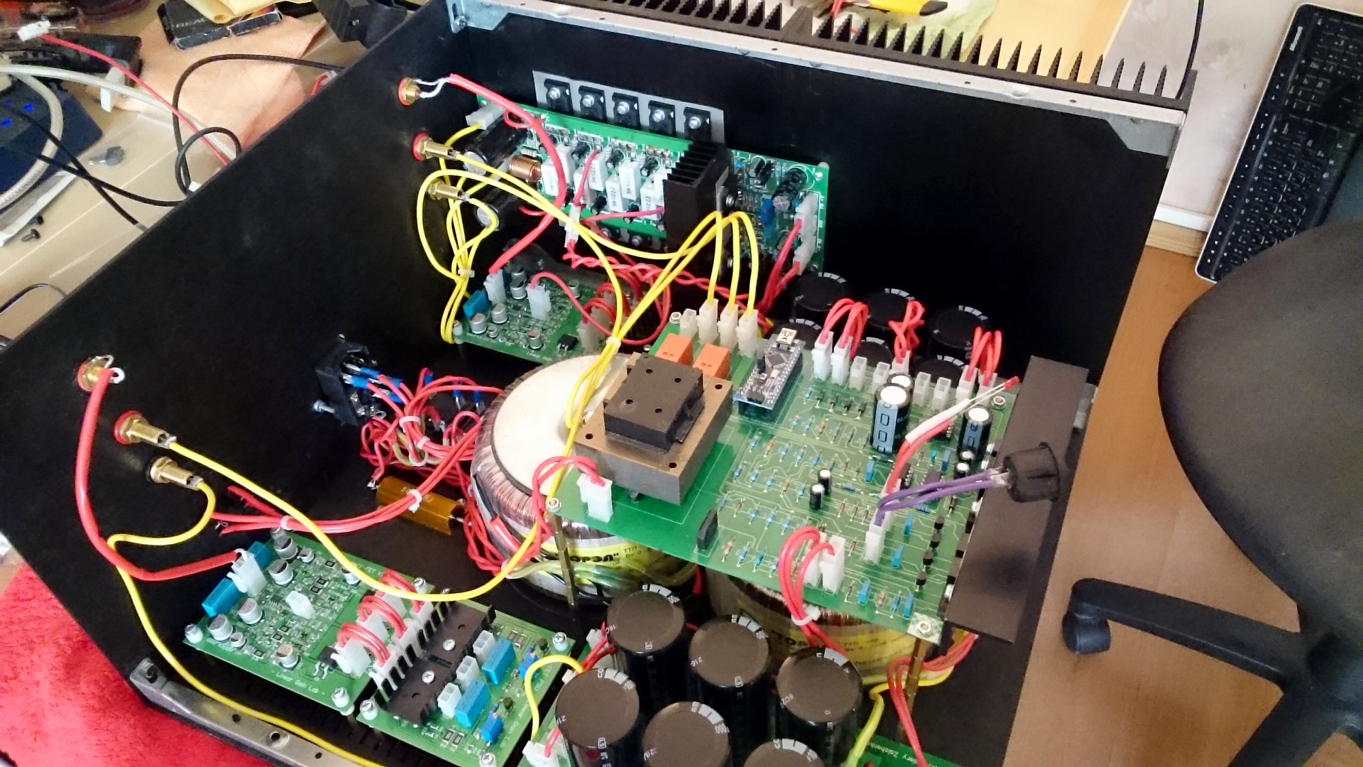

Progressing with the build - close to completion
The right channel is 100% mounted, the bias is set - works perfectly!
Working on the left channel connectors 😎

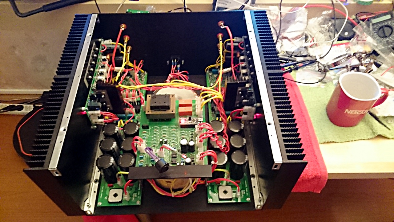

Valery,
after following Pete's Slewmaster thread you don't think there will be any problems with the close spacing of the output devices? Will this limit the actual upper output levels or is that not as big a problem as OS found before he spread the outputs across his much longer output boards? I've been following your work since seeing your posts on the Slewmaster thread.
Valery,
Hi Kindhornman - you're absolutely right, this arrangement is not optimal because of two reasons:
1) Output devices are too close;
2) Output devices' distribution is not symmetric across the heatsink.
As a result, not all the power potential of the housing is used.
I use +/-50V regulated rails for the front-end here, so some 140W @ 8 ohm is something I expect as a maximum power here.
I will definitely take these "flaws" in account for the next build 😉

Hi Valery,
What i find "too bad" on your build over the distance between output transistors, is that you just use the half capacity heatsink of your Amp case. All Power Mosfet are on one of the two heatsink constituing one side of the case. May be you could use a 10mm aluminium plate that spread heat over the two heatsink.
Marc

Exactly - this is what I mean by "not symmetric distribution". Well, enough for the purpose now, but for the next build I will place the output devices in a better way.
One more thing - it would be a good idea to place the speaker protection relays (mechanical or solid state) close to the output terminals. My OPS boards' output is very close to the terminals, but I have to use the long wires to connect both the OPS outputs and the terminals to the control board relays.

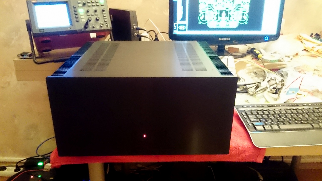

My lovely amp
Even with those "inefficiencies", just discussed above, it's a lovely amp 😎
