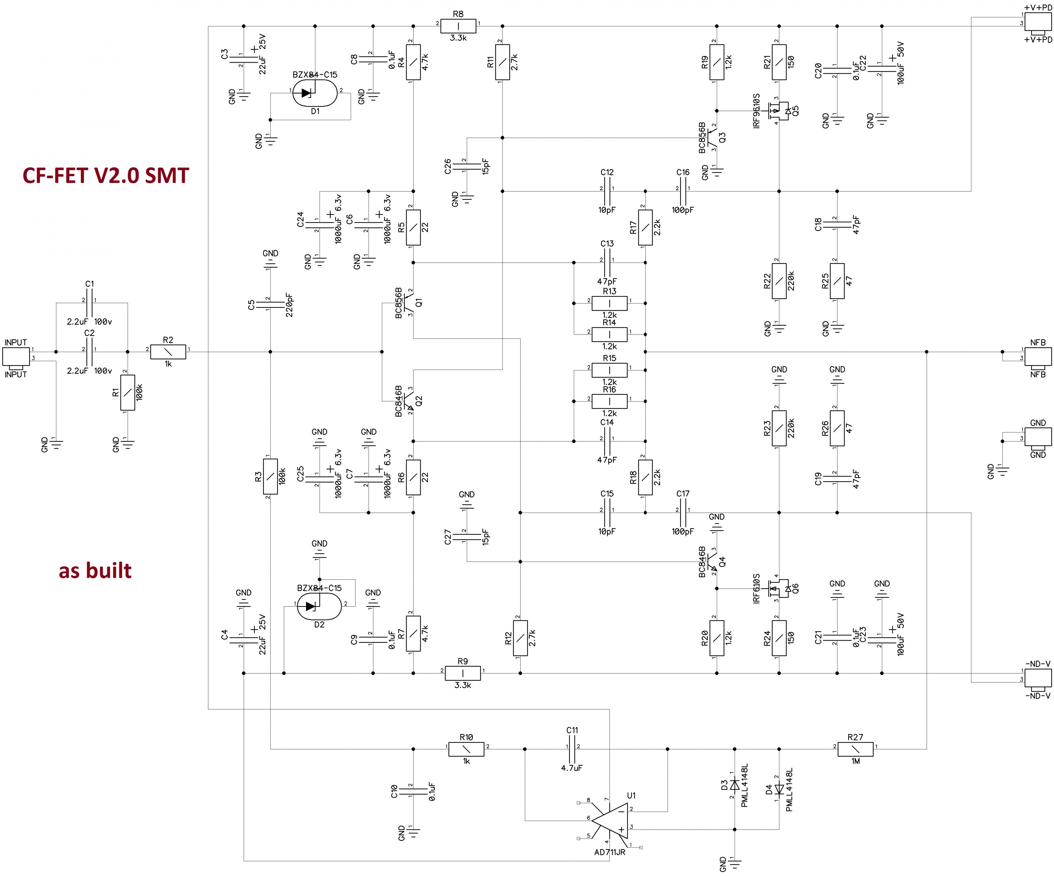

Compensation adjustment for different OPS options
Dear friends,
Yesterday Terry had some "burning" issues, testing CF-FET V2.0 with BJT EF3 OPS, loosing four drivers.
I have researched the issue and... it could be avoided if I would do it earlier 🙄
Even for IRFP-based OPS, compensation caps values are slightly different from the initial ones, designed for LFET OPS. With EF3 BJT OPS and original compensation, both gain and phase responses go absolutely crazy. This option requires much deeper compensation. So, the optimal values look like this:
LFET OPS (TubSuMo):
C12, C15: 10pF
C16, C17: 100pF
IRFP-based SlewMasters:
C12, C15: 100pF
C16, C17: 330pF
Original BJT EF3 SlewMasters (and Borys's OPS):
C12, C15: 150pF
C16, C17: 470pF
Although, for IRFP-based OPS initial values are not optimal, but acceptable, for EF3 BJT they are very bad - way too low, leaving the amp at the edge of stability.
I will test/measure the new optimal values for IRFP OPS tomorrow.
I will also copy this info to my CF-FET thread for the benefit of the members visiting that thread.
Terry - many thanks for bringing this up - I hope we all have learned something (or confirmed something we already had a clue about 😉) today :up:
Schematic is attached for your reference.
Valery

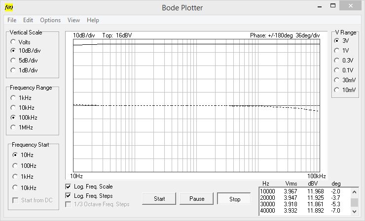

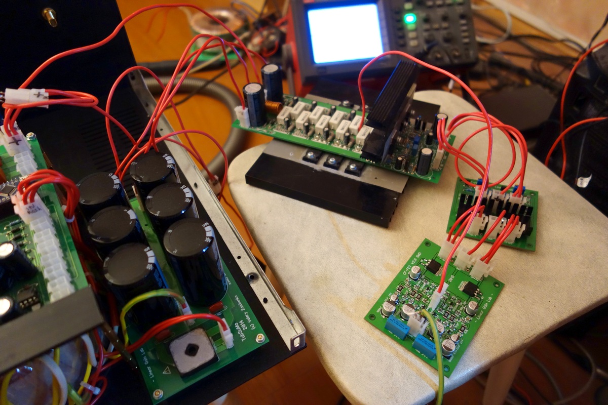

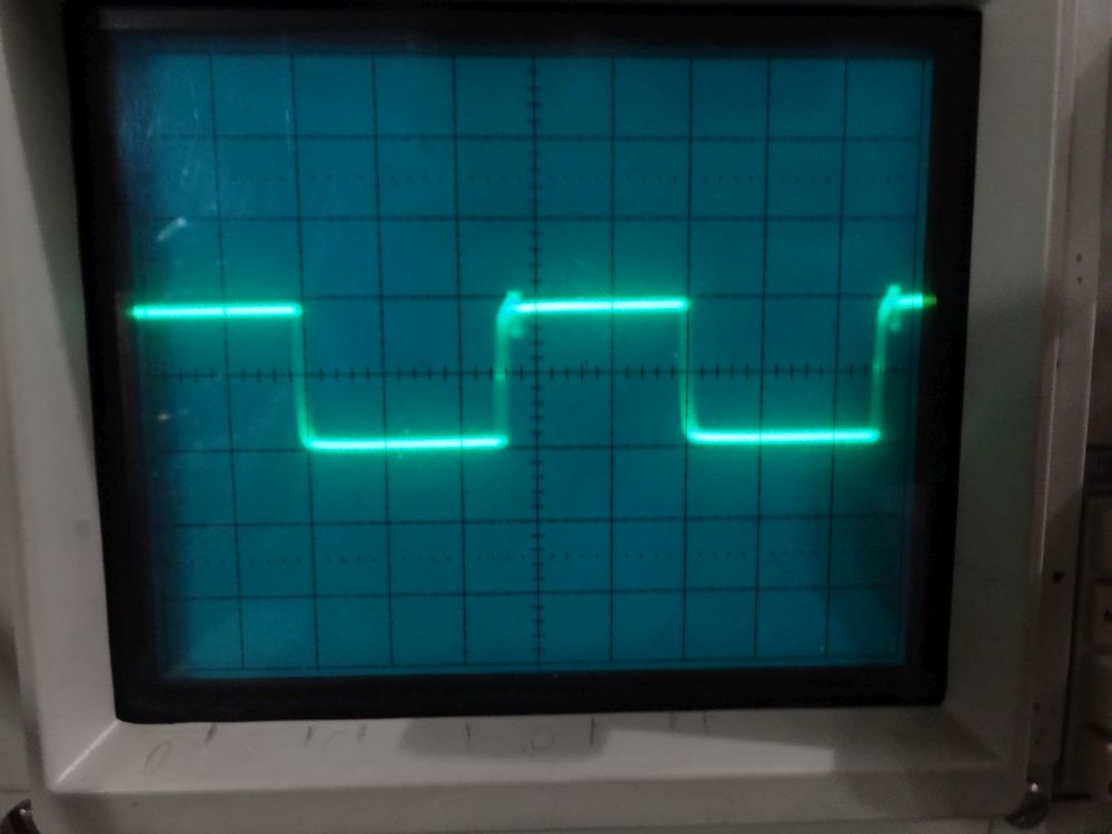

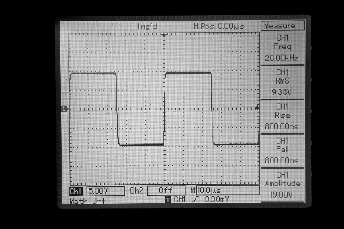

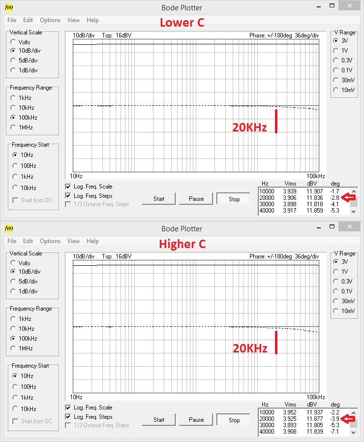

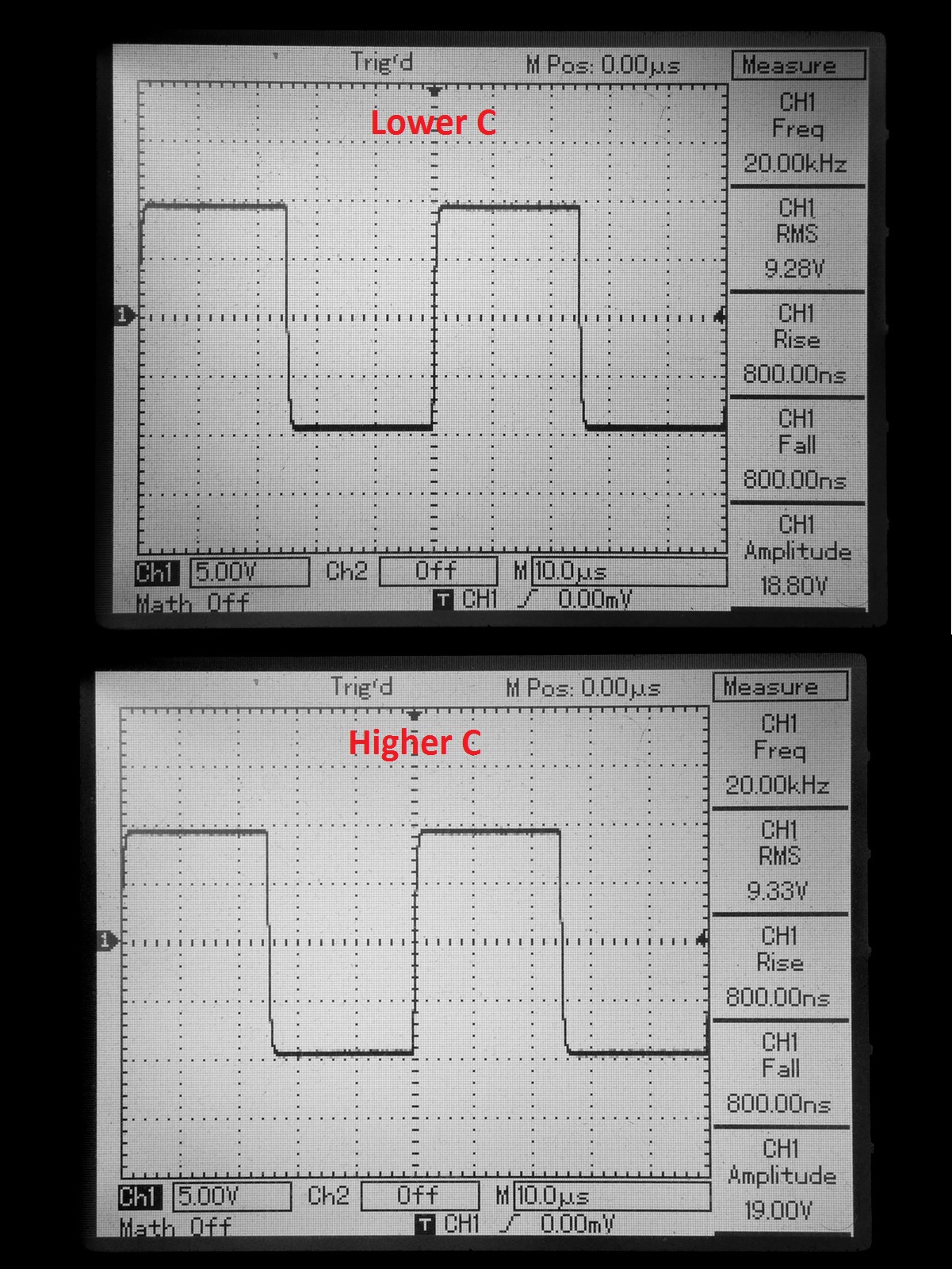

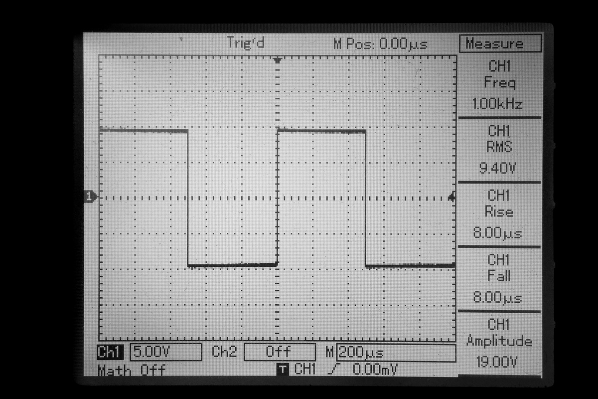

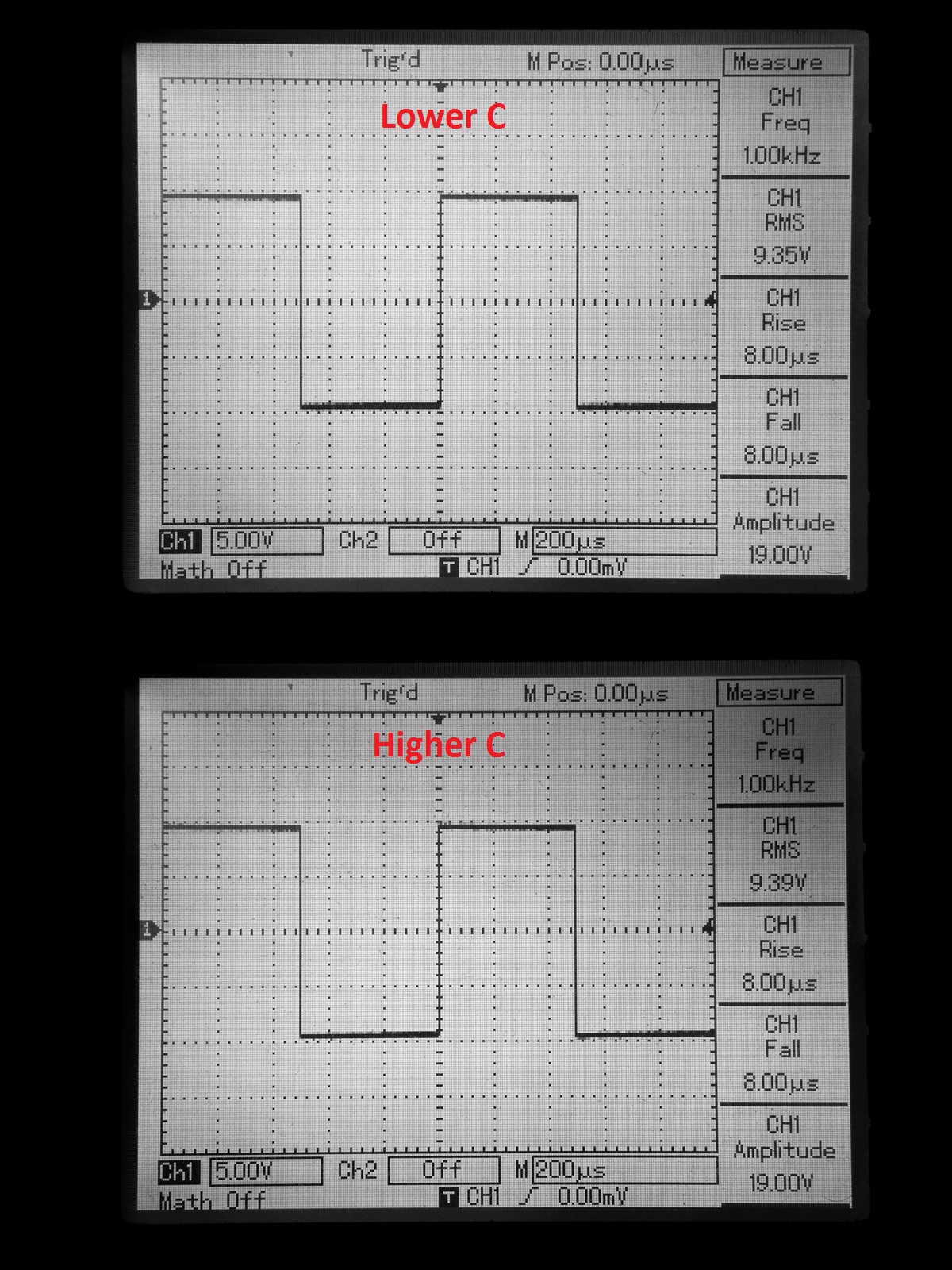

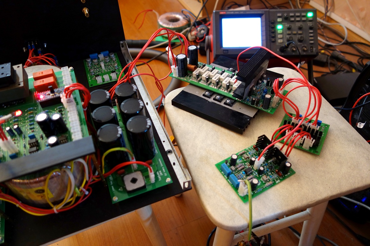

OK, tested the higher compensation with the TH version of the front-end (just easier to change the caps).
OPS is IRFP-based. Input filter is in place, Zobel/Thiele network is in place. The load is 8R.
Lower C values: C12, C15 = 10pF; C16, C17 = 100pF
Higher C values: C12, C15 = 100pF; C16, C17 = 330pF
1-st picture - the whole test setup;
2-nd picture - 1KHz square wave response;
3-rd picture - 20 KHz square wave response;
4-th picture - measured Bode plots.
As we can see, it still looks good with deeper compensation, however it's got better stability margins. So, I leave it this way, with the higher C values.
Valery
